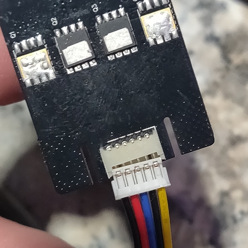

Ok. Could you let us know the wiring diagram at least? Then if i wanted to I could solder my button wires to whichever pins are required.
I’m not even sure which pins are which signals on that connector X_X.
I didn’t do the PCB design, the guy who did do it, we cannot speak to in person yet because of the virus.
Ah ok. If a production run moves forward (fingers crossed) then it might be good to include that info with the AS.
That was the plan. That header was mostly there for programming and debugging. I’ll try to get back to you as soon as possible

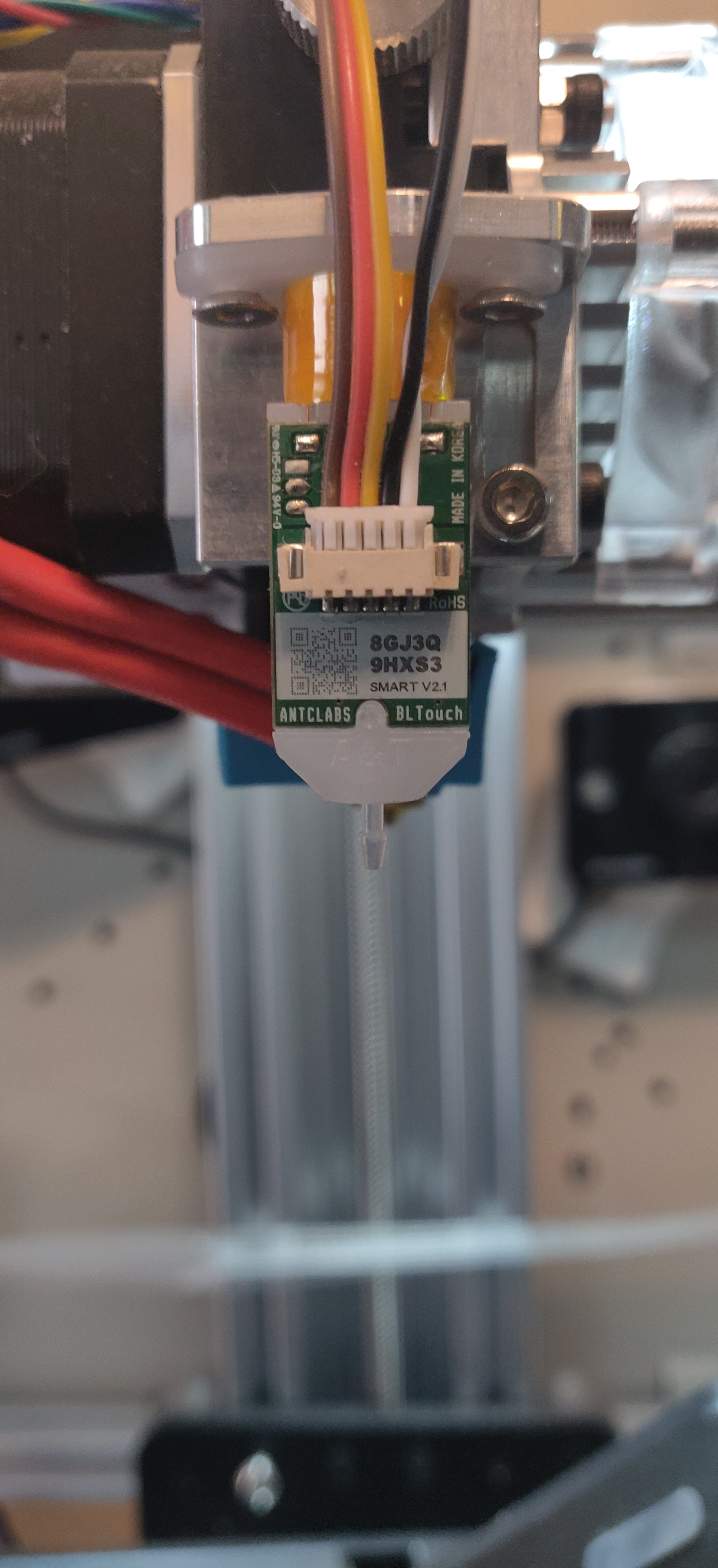

the connector looks like a molex picoblade to me btw, will verify in a bit, the bltouch sensor on my 3dprinter has the same I believe
NVM it’s not that :neutral_face:
5pin picoblade is the same physical size as the 6 pin connector on the AS

Pinout
Resistor between INP and the LED. Switch goes between switch and ground.
that means the pin pitch is 1.00mm, so it should be the corresponding jst connector for that.
Much appreciated :slightly_smiling_face:
I don’t know what this means?
INP is 5V when the switch is on, and 0V when the switch is off. You can use this to drive an LED as indicator. LEDs need current limiting resistors.
On the cathode or anode of the LED?
INP > resistor > LED > GND
or
INP > resistor > LED > +5V
The first one.
Second one also works if you want the indication inverted.

What resistance value does it need?
330 ohm
