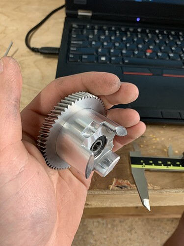

Not the right person to ask lol. My m1’s are wobbly for some reason and i tried everything to make them right. Most likely the bergmeister adapters are not true to center.

@Athrx Not sure what went wrong with yours. I tested a handful of the berg adapters and they all run true. The hub part is super sensitive to misalignment so from now on, all orders will be shipped with this bit already assembled. Also made the bearing for the hub part a press fit instead of a super close clearance fit.

I found that filing the spokes of the adaptor for a looser tolerance and putting some hard but flexible dampening pads in there mostly fixed the sound. Still wobbly but keeps my sanity in check.
I also had to put a 0.2mm washer (1.2mm total) inside the geardrive to get a better mesh and less bouncing around. This also stops the wheel gears from rubbing on the clamp part under maximum acceleration.
