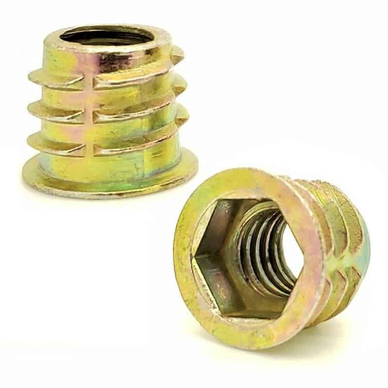

I would recommend that for the top boxes that you bolt straight through the deck, rather than relying on inserts.
You can also fit inserts from the bottom.
That way you can use countersunk screws inside the enclosure so that nothing is sticking out.
Yeah or this. I just think there needs to be some sort of flange on the bottom face of the deck.
These inserts are really strong. The bindings are attached to them! They’re embedded in the core of the deck, not just screwed in. I like the idea of top mount mounting positions.

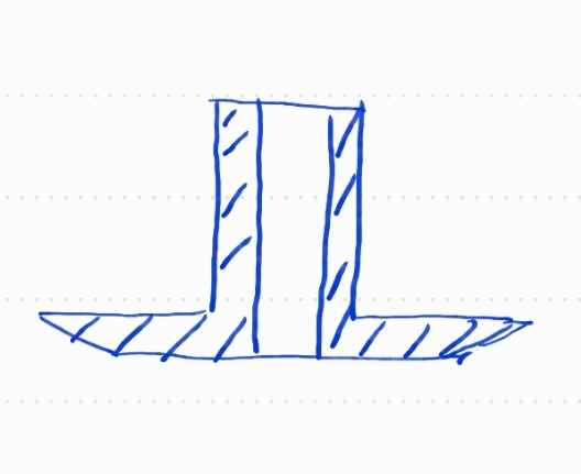

I can make you inserts like this on my lathe.
SmartSelect_20200509-140043_Samsung Notes
That’s what the inserts are like but set in the core of the deck.

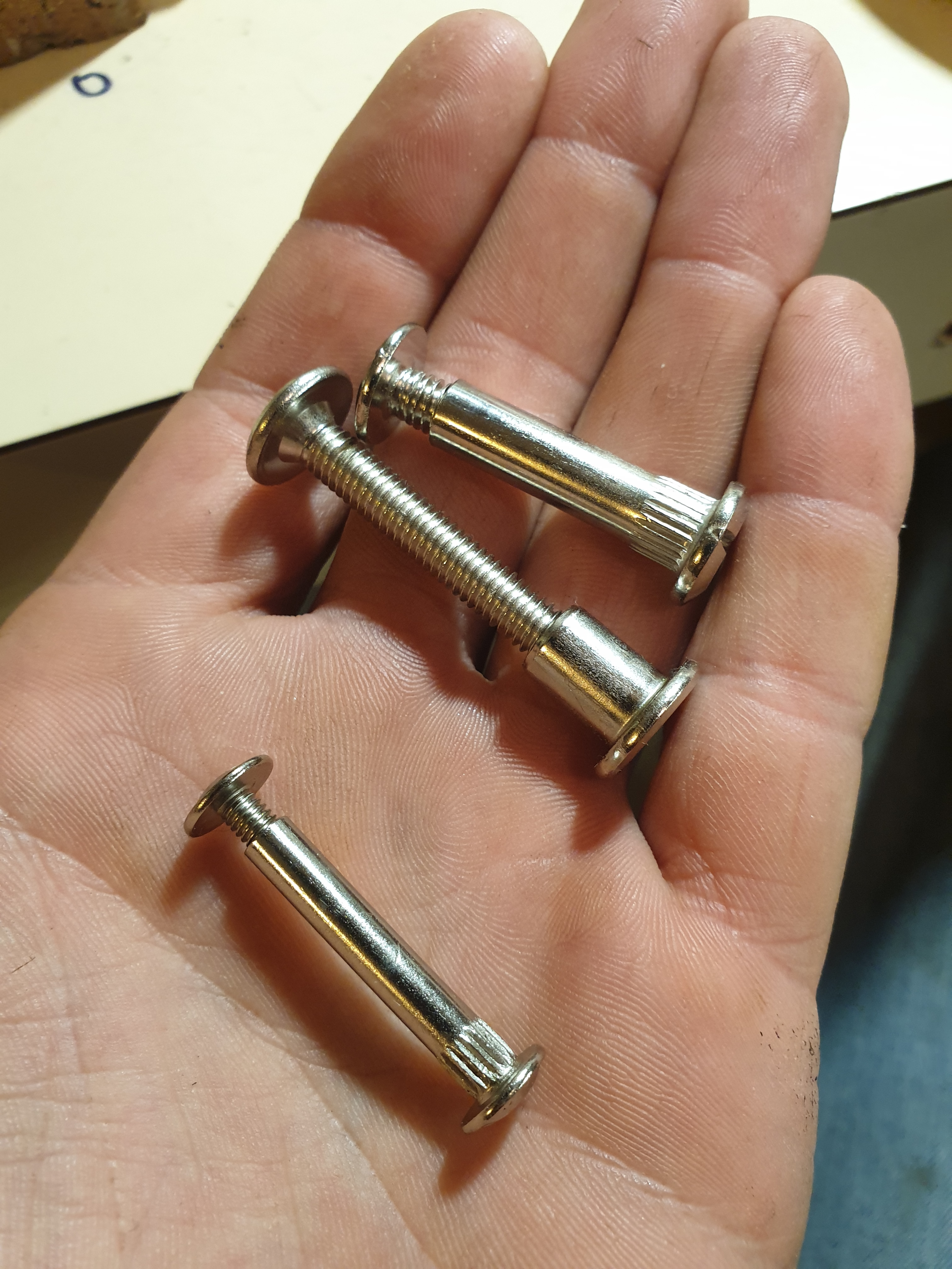

I just modify these sex bolts to my needs and desires.
Best is just to epoxy some nuts, the material on inserts is total shit compared to a proper nut in my experience
I stripped the threads of like half nuts on my deck because just of the board slightly flexing and the enclosure being too stiff

Glyphiks is probably thinking about this type of insert or similar which can come out if unglued or the material delaminates around it.
From what I understand your inserts are different.

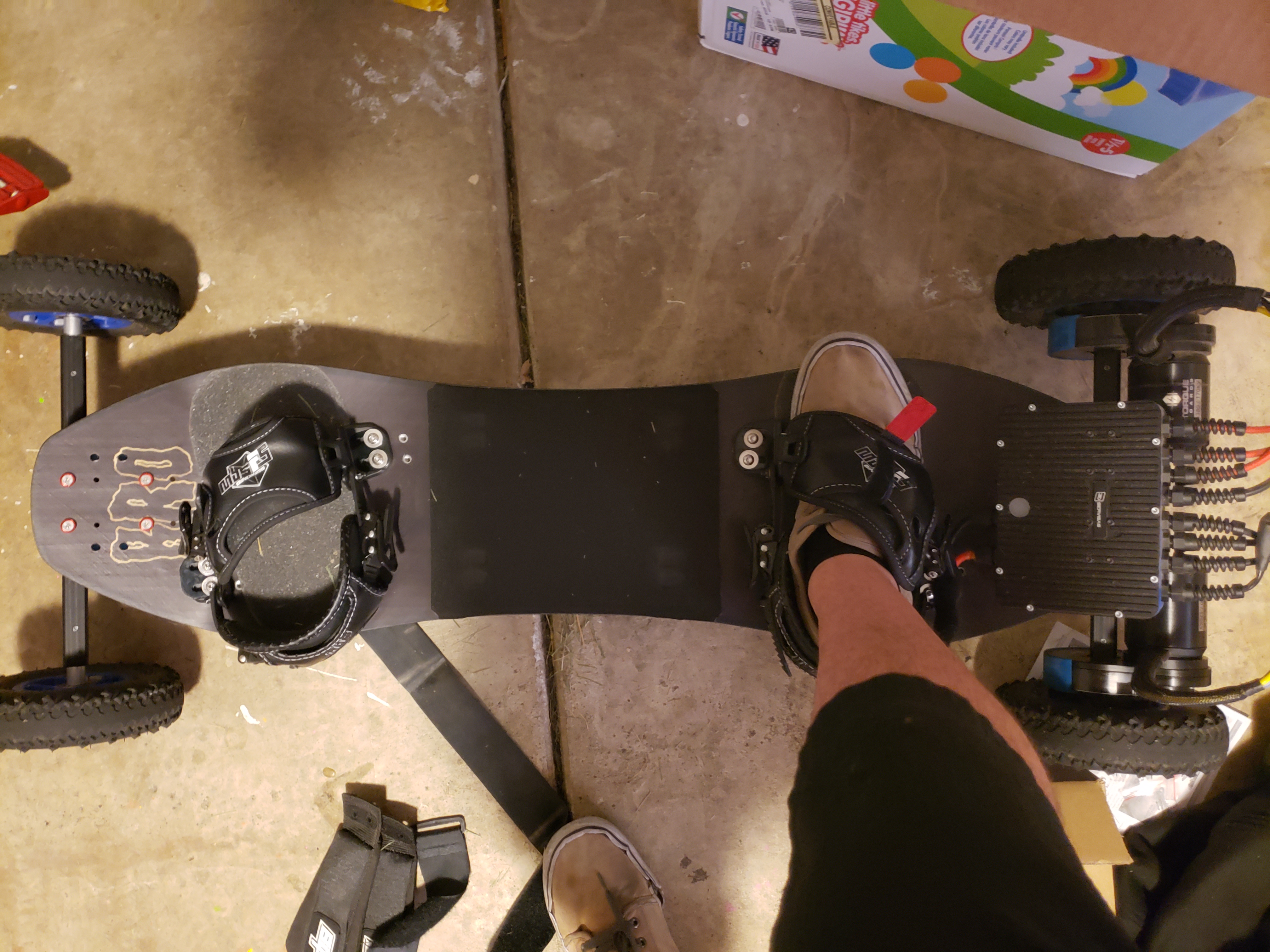

I am not a super fan of this. I guess as an option it wouldn’t be too bad, but even as an option I still think it should be at least close-ish to the current regular or goofy setup. Both F1 and F5 bindings so far setup as-is have allowed me to position my rear foot straight across the deck comfortably.
If it is an option, imo it should just be the mounting holes shifted 1cm more towards the center if anything. The shape of bindings I feel like lend themselves well to strapping diagonally across your feet. Moving the holes inward just a bit but still having a similar offset, rather than straight across mounting holes would fit bindings better I think. See below:
