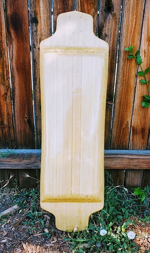

I finished up the tool paths and milled the deck.
Here are the tools that I use get the job done. This collection of bits costs about $750. They cost alot, but these ones are also very durable. I use Amana tool bits. They made a library that you can load right into Vcarve, so I don’t have to set up their bits at all. Which is really nice.
After the deck comes off of the machine, I take over. To shape it and make it look sexy I use an angle-grinder fitted with a flap-disk to remove the bulk of the material. Then I switch over to the orbital sander to smooth things out. It takes 45 minutes to an hour for me to get that part of the job done depending on how my back is feeling. On flat decks I use the CNC to machine a bunch of material off of the bottom with the large v-bits in the picture above. This board was a little too tall to fit under the gantry with the v-bit so I just did it all by hand. Using the machine saves a little time, helps with consistency and aids with dust management.
I’m very happy with how the shape turned out, and a 12s4p pack is going to fit easy with some padding.

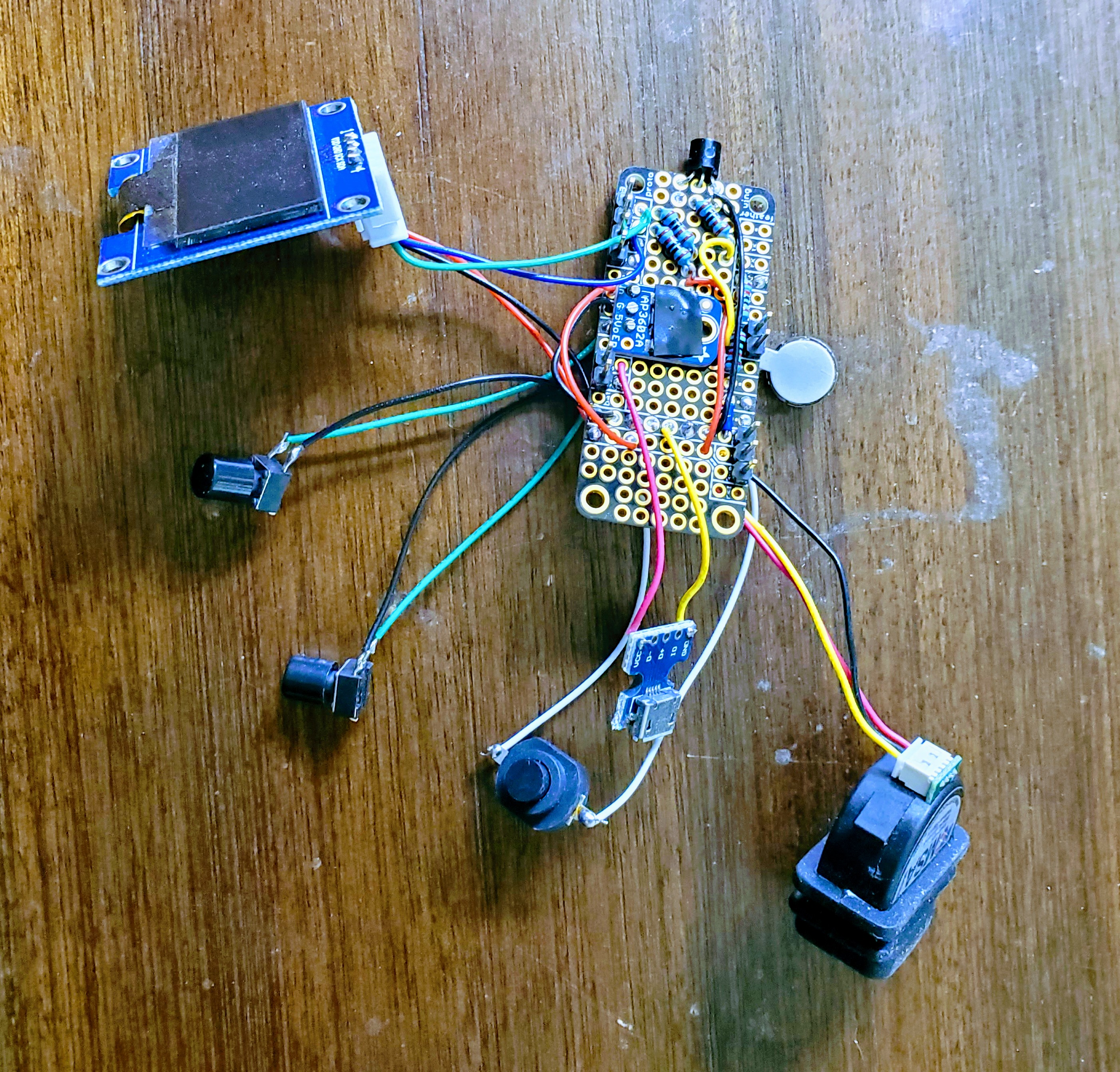

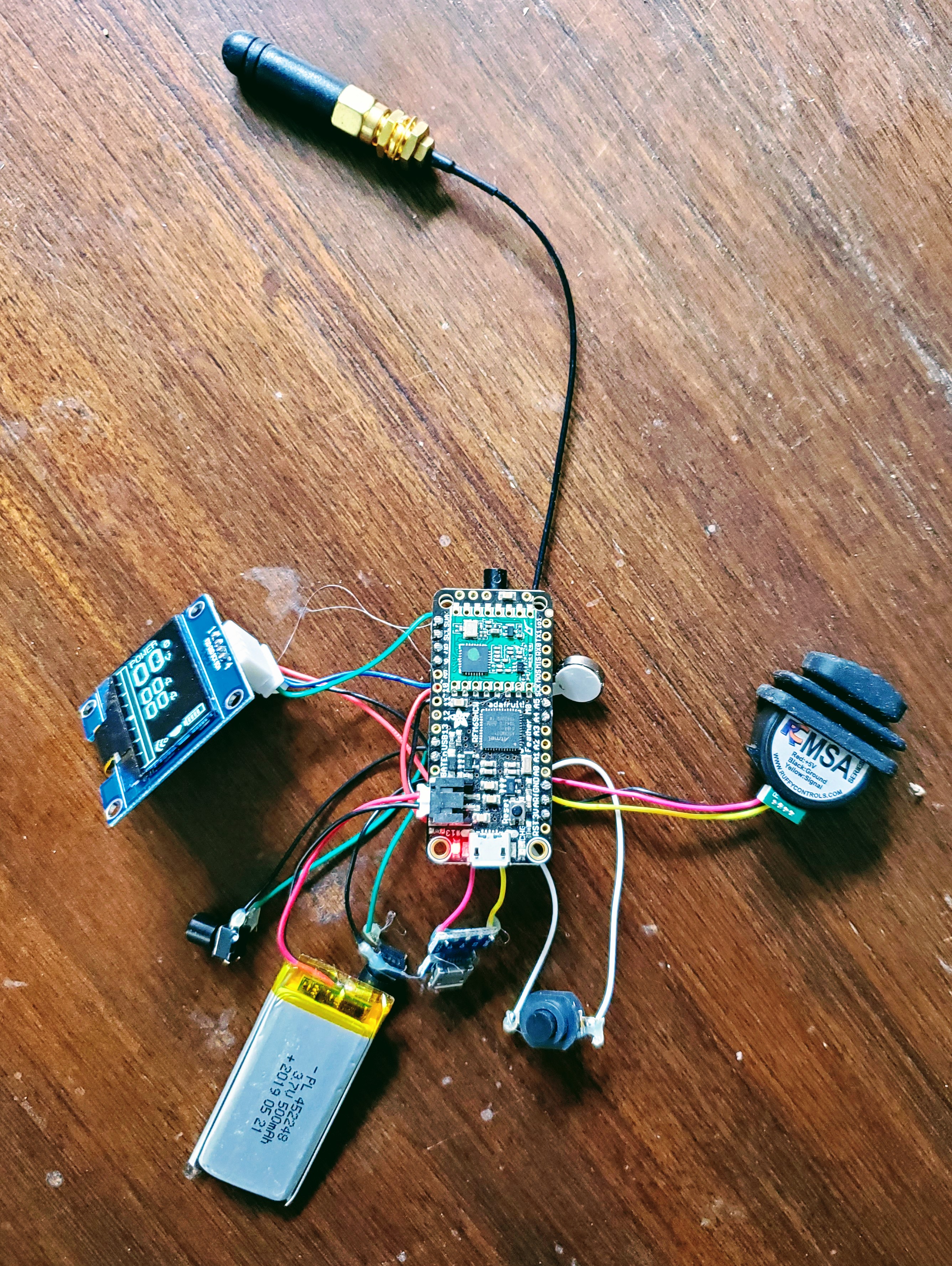

While I’m waiting for epoxy to cure, I’ve had some time to work on my remote. The electronics for the transmitter are done. I use @Stephanme’s feather rendition of the firefly right now for my DIY remotes.
The Feather packet radio and LoRa boards by Adafruit that were selected for this project are well-equipped, arduino-based micro-controllers. For those of you who aren’t arduinists, a basic arduino board involves a central processing unit (CPU) and some pins for inputs and outputs. The feather has a lot of extra toys. It has a micro-USB port that can be used for programming and charging. It also has a jack for a lipo pack. Additionally, it has all kinds of pins for digital and analogue inputs and outputs. Last but not least it includes a packet radio or LoRa module.
I made some changes to the project that might be worth noting. First, I translated the project over to a really convenient proto-board that Adafruit makes for the Feather microcontrollers, so that a custom PCB is not needed. It saves on soldering time and helps make things really compact. Also, It has a bunch of ground and power pins to help with wiring. Adafruit makes some good stuff for tinkerers.
The only thing that would make the feather better, in my opinion, would be if it had a 5V power supply for a really high end thumb-stick (a lower price would be nice too). Fortunately, they have a tiny 5V power-booster that gets the job done, but it does require some extra soldering. I added that to get a steady 5V power supply, but the signal from the thumb-stick still needs to be brought back down to 3.3V. That is accomplished by using two resisters to make a 10/20k divider-circuit. Again, this is more soldering, but you get a really nice, non-printed thumb-stick for your effort.
The last upgrade that I made was to just increase the screen size from 0.96" to 1.33". The difference is substantial. I’m only using one on this design, but I might resurrect my two-faced chicken nugget for my next build.

Here is a parts-list for the transmitter along with some pics of the wiring:
  • Adafruit Feather M0 board (part# 3176)
  • Adafruit Featherwing Proto-board for Feather M0 (part# 2884)
  • Adafruit 5V booster for the thumbwheel (part# 3661)
  • UFL adaptor with external antenna and SMD connector.
  • One monochrome 128x64 SSD 1306 OLED screen. These can be found all over Amazon. Buy the ones with 4-pins.
  • One JST XH 2.54mm 4-pin housings with connectors and wire leads.
  • Any 3.7 v lipo battery will work. I use a 500 mAh that fits the footprint of the micro-controller board perfectly. If you don’t buy a lipo from Adafruit you have to reverse the polarity, or something will smell like burning. I remove the jack and solder the battery leads directly to the board. It saves space. The black wire goes toward the USB jack.
  • The tactile buttons are standard issue and can be found on Amazon.
  • I used a latching pushbutton and installed it on the back of the remote. It’s a lot nicer than the slide-switches that I tend to see used. This can also be found on Amazon.
  • If you’d like to make a vibrating remote you need a 1k resistor, a 2N2222 transitor and a tiny disc vibrator. Again, these things are all on Amazon. Generally you can only buy them in bulk.
  • To make the voltage-divider circuit to bring the 5V signal back down from the thumbwheel you need a 10k and 20k resister. You may as well buy a kit with all the above listed resisters on Amazon.
  • Even though the Feather M0 comes with a micro-usb port, I add a micro-USB port that extends to the exterior of the enclosure with a neoprene gasket. It helps seal things up and makes it easier to access the charging port. This is not set up as a data port. Programming needs to be done through the micro-usb jack on the micro-controller board.
  • Lastly, check out Ruffycontrols.com for the thumbwheel. I use the single-hall MSA series here. You can make some selections for the actuator, such as an elastomer or a plastic thumbpad. They have two different force level springs. I like the 70N spring. The 140N spring gave me “thumb fatigue” over long rides. If you do short/fast races the 140N spring might be just what you need. I think it has better speed and breaking micro-control. Lastly, choose the 5V model.

It’s cush. I love it. The control is impeccable. The thumb-stick costs about $65 delivered. The two feather boards required cost $25 per. All together the BOM is a little over $150.
Jeez lol that’s more than I expected. The thumb stick looks so nice though… $65. hmmmm
These are the types of thumb-sticks that get used on military air-craft. They’re a step above.
It really shines when you’re flying down hill. The micro control of the breaks is insane.

The lid is made form bamboo lumber that matches the grain of the deck. No bent aluminum here, friends. It is reinforced with plexiglass to keep it from splitting and backed with cork to help it sit nicely and resist moisture. These layers are all bonded with the same epoxy that I used on the board.
The CNC cuts the lid out and removes some material to help with the shaping step. I use a 6.25/30 degree double-bevel along the edge. The bevel makes it easier to fit and remove the lid.
The lid is then bolted in place and contoured to the concavity of the deck. I use a grinder and orbital sander to get the job done.
It took me a while to get this lid just right. First, I tried just bamboo. It split on some of the test decks, so I reinforced it with plexiglass. I thought about using neoprene for the seal, but the cork mills really cleanly and looks nice. On the initial test decks that I made the lids would stick and not come out. The bevel helped, but when the compartment is bored out the deck “tacos” in the middle by about 1mm. This makes the opening slightly hour-glass shaped. I was able to compensate for this in the CAM software. Now the lid is slightly hour-glass shaped as well. The lid is a pain in the ass, but now it’s right.
The bottom and top have now been reinforced and I have a lid. Paint and grip is next.
