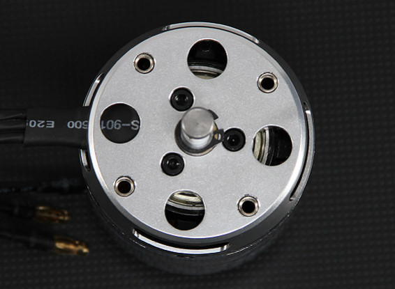

First it started with my pinion giving out, then when I replaced that we found out 3 of my 6380 mounting holes stripped, and I’ve made sure to not over tighten those. So board was out of comission AND now I’m going to be down $140 for a new motor :unamused: Doesn’t help that @torqueboards swapped to 190kv :man_facepalming:

I think you can strip those holes by over torquing, but if you haven’t already be sure you’ve learned the magic feel to never cross thread, as doing that once is far more likely to have stripped those threads. sucks either way.

Problem should be solved in the next couple of days! Ordered two Sk3 6374 192kv motors after @malJohann having some success with them. $180 down the drain in “repairs” that definitely hurt, but I’m hoping to recoup 1/2 those costs by selling the perfectly fine 6380 to my local buddy to replace his 6355 single drive with a 6380 single drive.
@malJohann anything special you did to these motors?
Shoved as much Amps at them as I could!
Seriously though, check the three cap-head screws around the shaft on the mounting plate for tension and/or LocTite if you’re so inclined. Those screws came loose on one of my motors over time, and the amount of LocTite on there was less than desirable.
Other than that they ran like a champ!
@DEEIF at least 50% of the problems with SK3’s is those three screws… loctite them in and don’t strip them…
EVaR!
Thanks @malJohann
@kook man I shall try not to strip these ones!

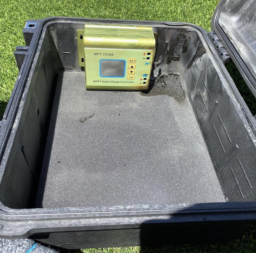

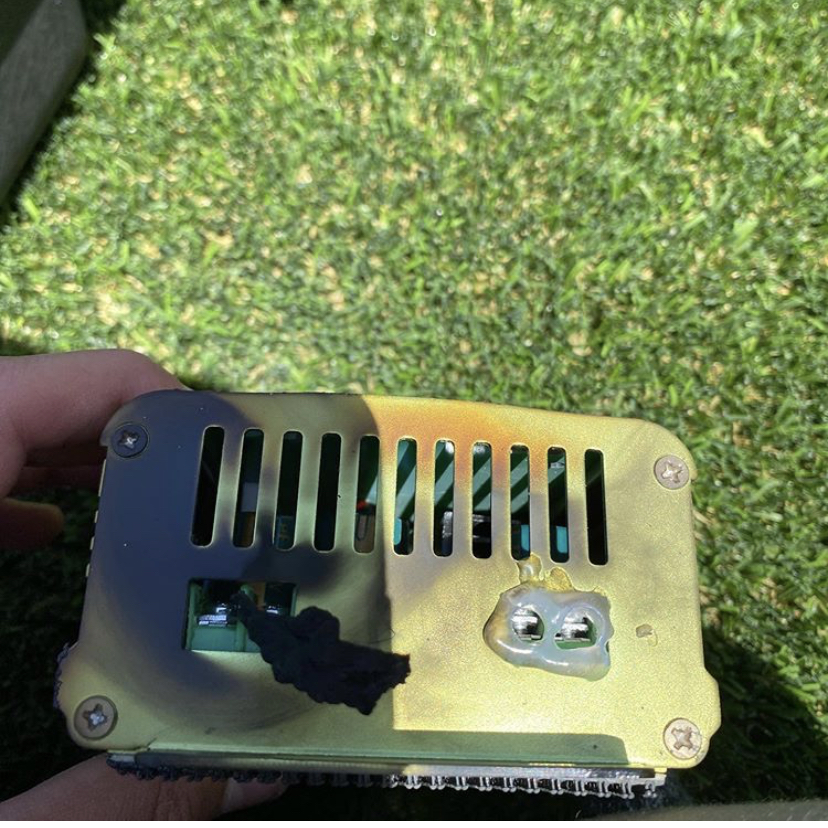

Hey @DEEIF what was the makeup of your portable charger? what parts and such? and why did it catch on fire?? :smiley: :stuck_out_tongue: j/k I know we’ll never know that last part.
MPPT solar controller like Andrew and I think @Arzamenable used. I ran my backup 13s2p 40T pack as the battery source and connected it to ground control.
I think it shorted against its metallic case which made it catch on fire. This was what I got from how it looked after and the part of it that was damaged. If I were to do it again I would just do an optional Parallel XR Pack
Wait wut?! Pics?!
I think you already knew about this @Arzamenable… Just burst into flames and Mario kicked the pelican case closed which cut the oxygen. Happened a couple months ago :love_you_gesture:t3:
