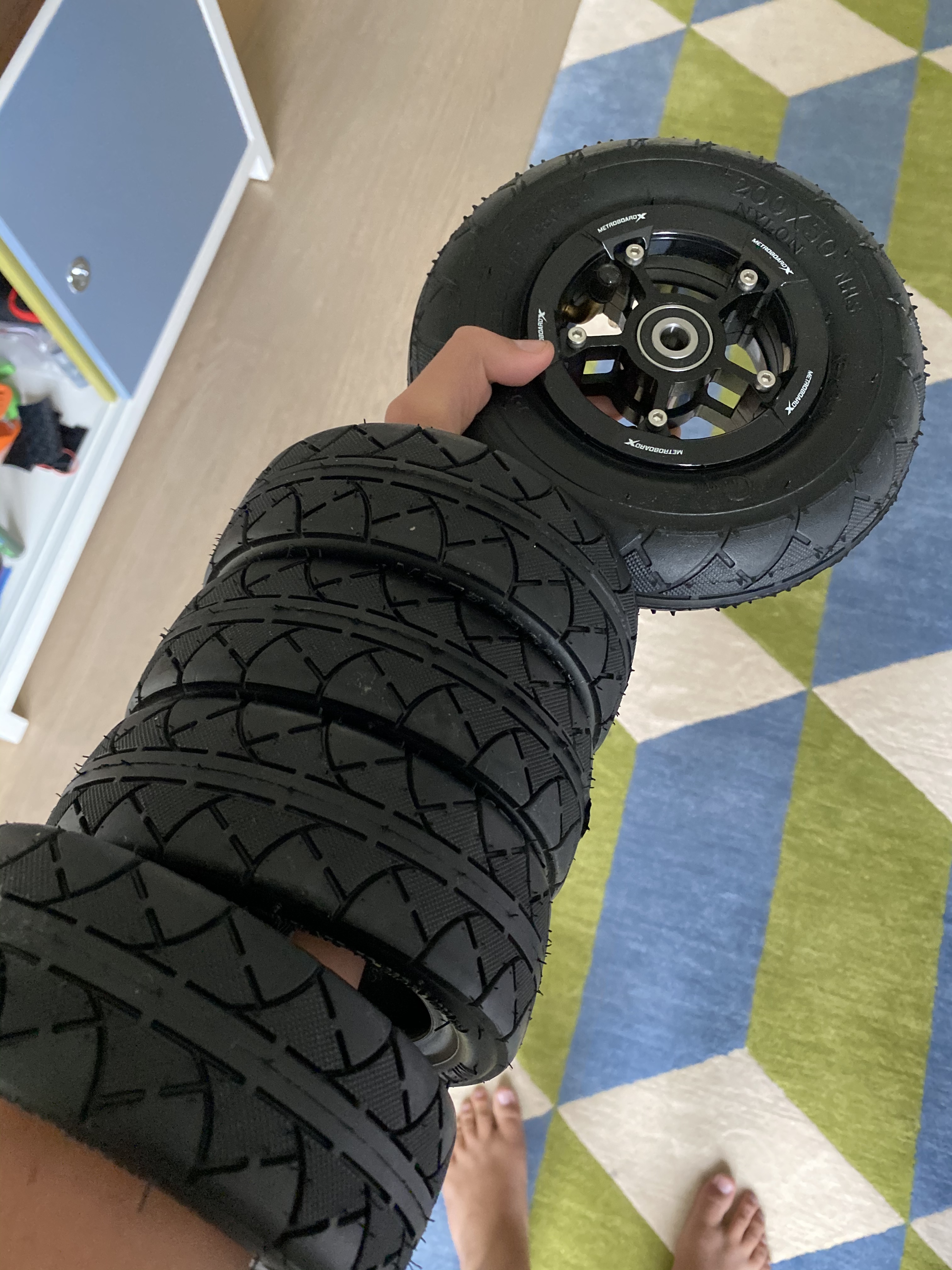

I convinced Metro to sell me a single hub along with a spare set of tires! I’ve got something cool planned for it :stuck_out_tongue: @Jansen this is a piece to the puzzle
I need some of those lol
Haha, if you were in LA I would give you some!
You think I could convince them to do that? And I need 2 hubs
How much was it?
$30 a hub plus 1 tire and tube
