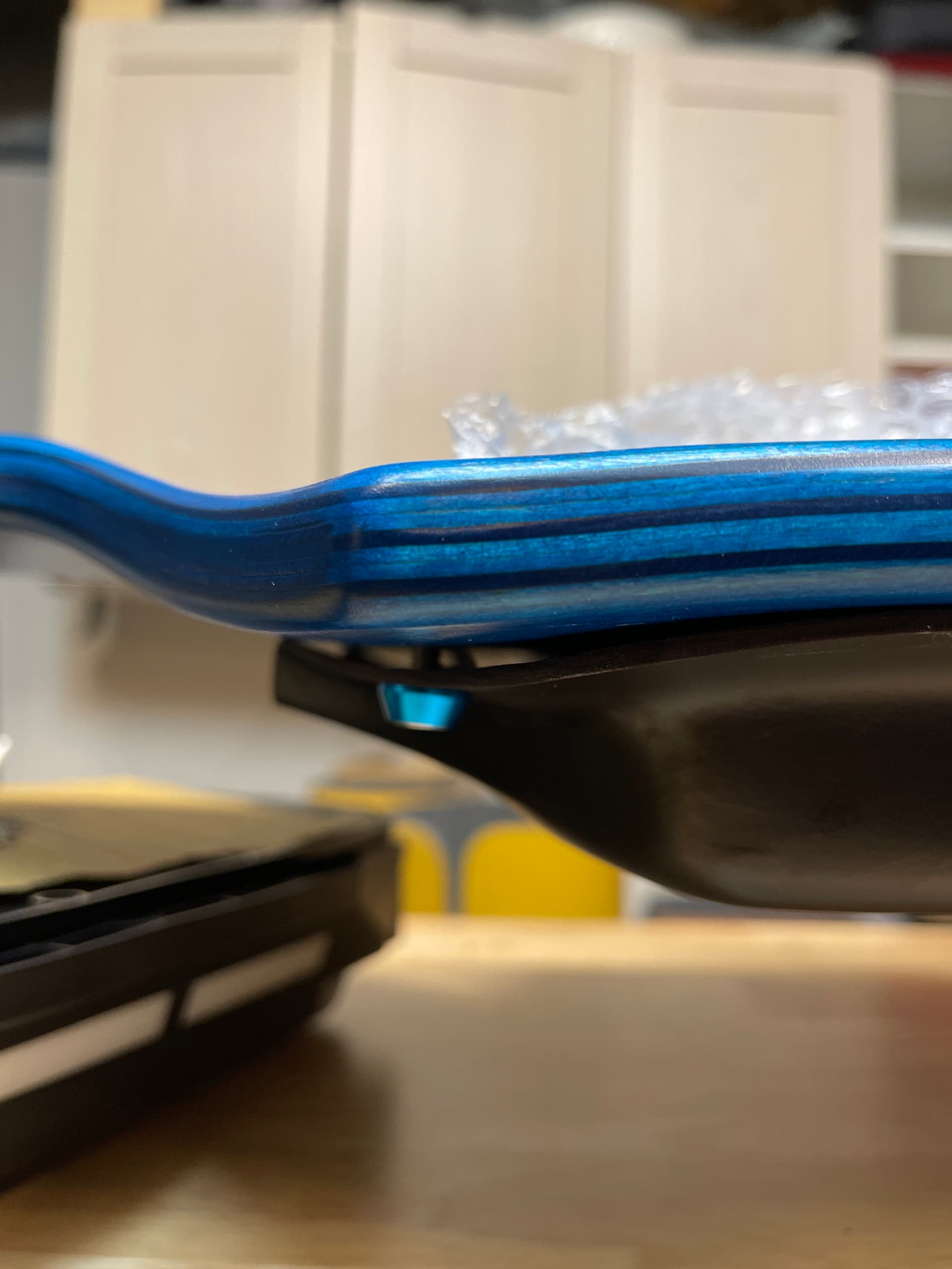

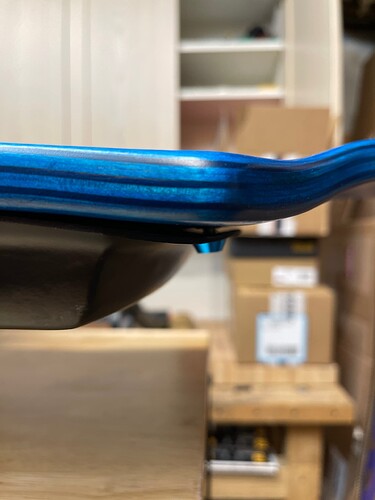

Granda Plata 43" deck -- first batch
Nice! How did you make it fit so well? Did you just force it with bolts?
Yeah just sucked it down with the bolts, will add a gasket so the fiberglass is not against the wood, but will be a really small gasket
I little bit of this at the back and front but not bad at all

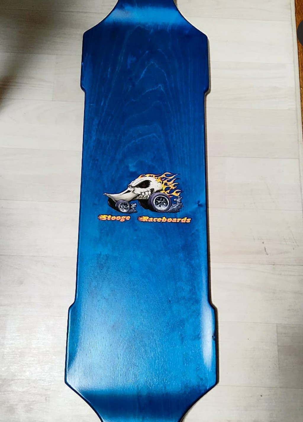

Taken too long to get to this. I decided against adding any concave or anything, still gotta make an enclosure for it tho. Need to see if any of my molds fit it reasonably well
Oh cool I didn’t even know the blue one was a shiny Pokemon. I’ll have to trick it out even more now. It’s probably too long for me though so it may end up with some tall dude xD
