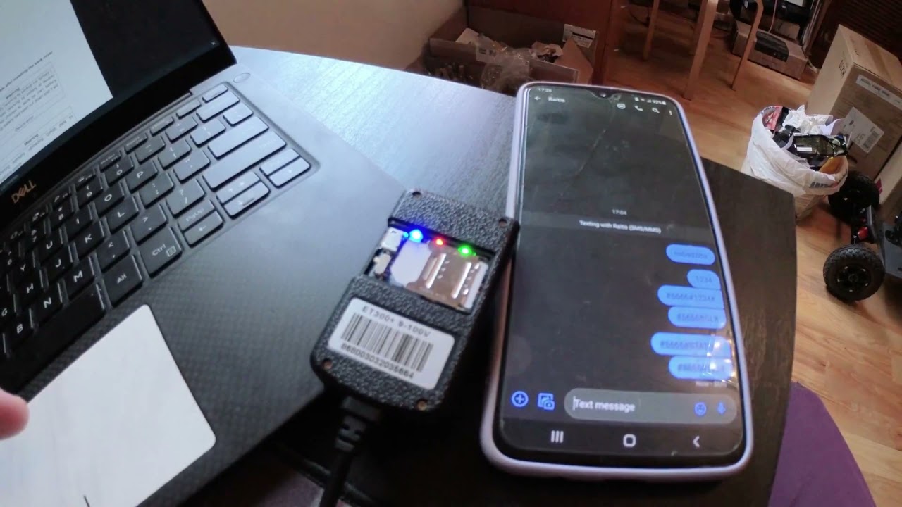

I can’t get it to work :confused:
@Halbj613 did yours act this way?
@Anubis @Halbj613 does the sim need to have internet? I have 4 sims with free text and calls I don’t pay for in my VidĂ©otron plan
No, IIRC GPS uses the phone number to validate the device, not the internet.
So I imagine it uses approximate coordinates with cell towers? Anyone with one installed could tell me how accurate it is?
GPS Is satellite based, I think when there is no internet its technically not gps but cell tower based (maybe this might not work? im not entirely sure)
Friend just told me we might still have one hiding somewhere in the shop, guess I’ll be upgrading the safety of my LsSS :crazy_face:
will check the video later as my phone isnt playing it for some reason
could you describe symptoms?
blue and green led comes on, after a while red led comes on, after a while they all go off. then it repeats. doesn’t respond to sms commands :confused:
ah ok mine wasnt like that
have you checked what those lights correspond to (bkb explains it in the manual on his site)
Yeah I did. bkb’s site has moved all that info and I wasn’t able to find it there, but I did find the pdf manual for my specific version
let me check the video later and see if i can see anything

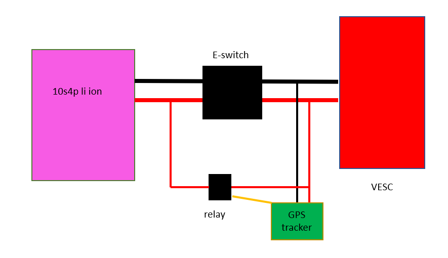

I feel like a GPS tracker might be useful, I’m planning on bringing my board on vacation.
Does anyone know how long the internal battery of the tracker lasts?
Also I had an idea of using the relay control on the tracker to connect / disconnect it from the battery.
The tracker would be powered by the battery in front of the e-switch / loop key and will start charging its battery while you are riding. Then if your board gets stolen, the tracker will work on the internal battery. Once you realise your board has been stolen you can trigger the relay and keep the tracker powered until you find it.
This stops the tracker from draining the battery if it is left for months and you don’t have to worry about remembering to turn the tracker on and off.
A helpful diagram:
Obviously if it gets stolen after you haven’t used It for a while it won’t work but that is less likely to happen.

Why not just connect the GPS to the discharge of the BMS? That way it wont kill your battery and is always on.
what’s reserved?
the first two replies so he can edit them later and add more info near the original post
I have a FlexiBMS
