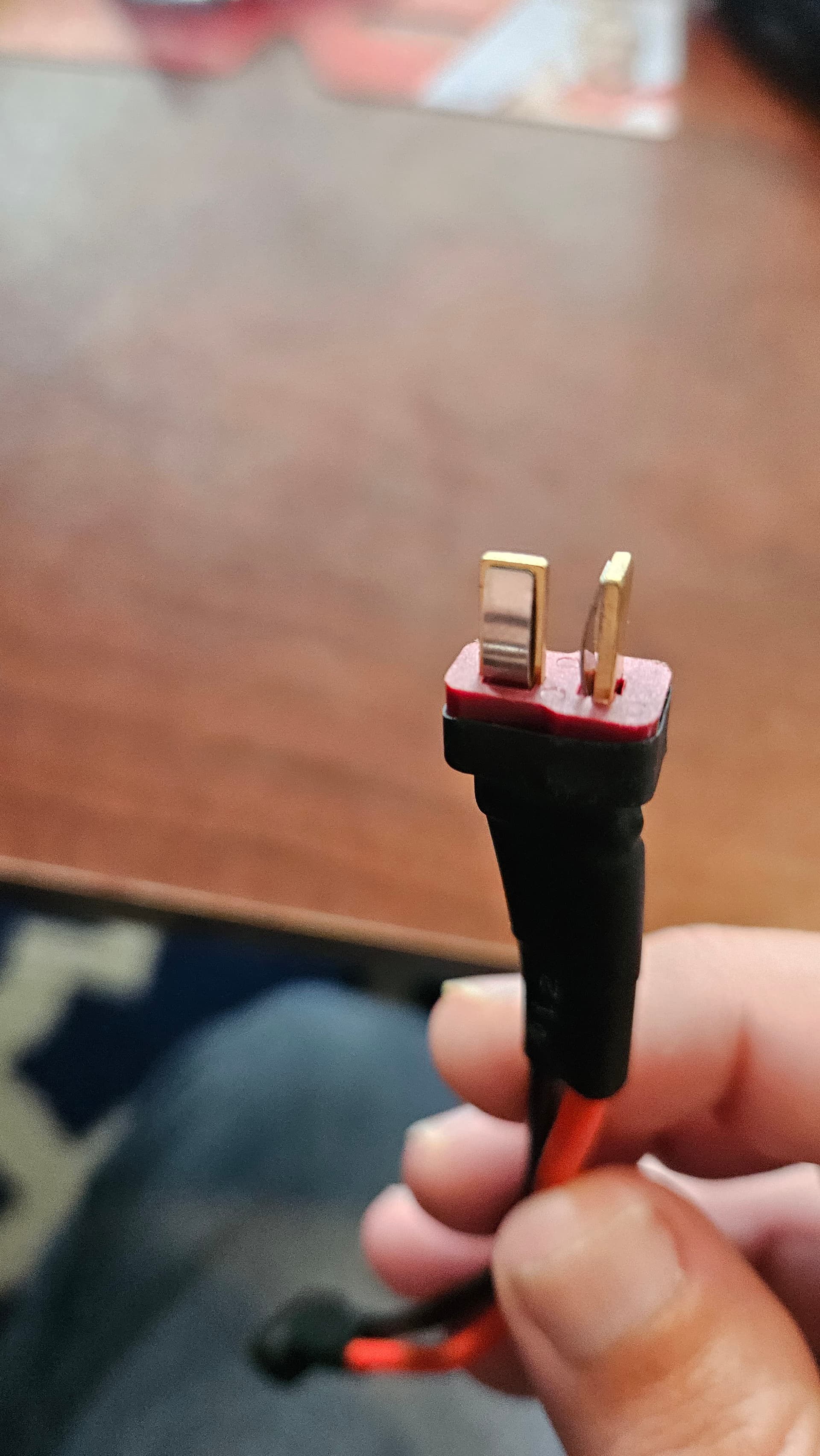

This adapter was between the battery (t connector end) and the first xt60 you are zoomed in on which goes into the first controller. There is a switch on the controllers that is currently routed up the post to a controller on the handle bar. The sizzle happened on the xt60s. Both of them are equally charred now. Battery still seems ok and is showing ~38volts.
Did you verify polarity of that battery-to-controller connection first? Sure hope you have and are using a multimeter as you diagnose and work on this.

If it was plugged in switched on with no anti spark this could happen or the ESC could be shorted.
2nd I would try powering it up with a PSU (Most chargers are PSU’s should boot up check if there’s and very slowly add a small amount of throttle the wheels should turn. To mutch throat and to many amps will be demanded from the charger and it will drop the voltage or cut out but shouldn’t damage any thing. It the charger voltage drops as soon as it’s turned on id suspect the ESC is tost

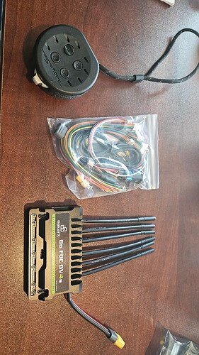

Ok guys… After a healthy wait, the stuff has arrived (hoyt st Puck and makerX Go FOC DV4s).
Since I still know basically nothing about the motors… How should I proceed in first testing / connecting them. I guess step one is to completely remove all the old controllers first?
I’ll also need to figure out how to splice the tiny control wires into the round plug wire.
As that is what each motor accepts.
What other tips guys… I dont want to blow anything up. :slight_smile:

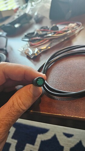

Each motor has 2 bundles of wire coming out of it. 1 is the typical 3 wire cluster of 12awg wires that connect to the esc, and the other are these tiny 5-wire cables which I assume also connect to the esc. Only on the esc, they are flat white connectors, whereas at the motor side they are these round plugs instead.
Ah ok those sound like just standard hall sensor wiring connectors.

if you can follow back to the esc from that 5 pin connector and figure out what wires are red/black that should be ~5V and the other 3 are the hall sensors. Seems like no 6th wire that is usually temp sensor, watch out for melting your motor with the VESC powa!!!
