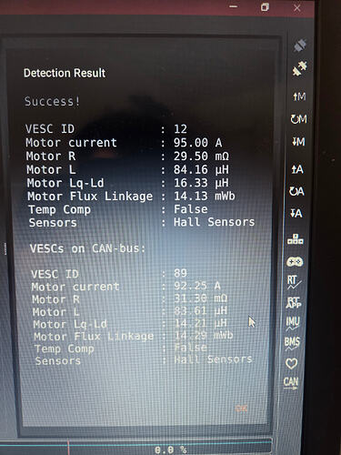

I did the wizard however I can’t make the trotthle to work and it’s impossible to shut off the d100s, also I got this for nami burn e2max stock motors 1500w and battery pack lg m50 lt, if someone have tips to set it, I am lost between motor current and battery, knowing original controllers nami are rated 2x 50A / 200A phase amps. What should I do?
Also here, It is better to chose HFi or sensors? The wizard gave tepp comp : false. This is a problem right? It needs to be switched on?
