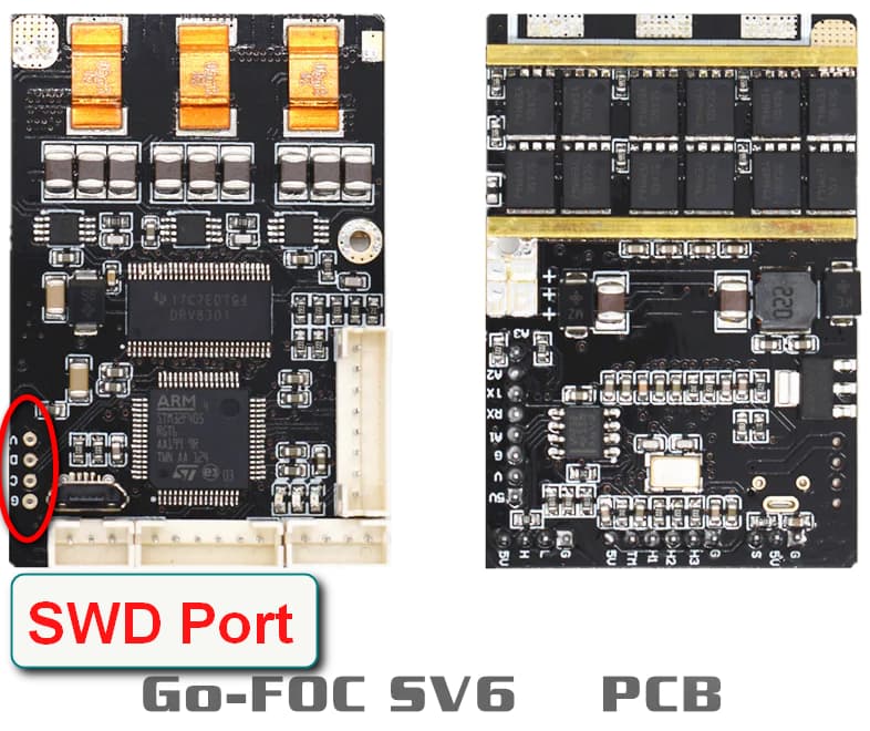

this would work great if those files appeared , i need to know how to connect a swd bootloader to an SV6 , because it does not have a clock . dio port . when i click on bbotloader it says generic , that will not work . my unit has no firm ware
thanks David
If you are using an ST-LINK try these pins on the SV6
Otherwise use the VESC tool through USB and the generic bootloader is fine.
I’m not sure why you need to use the ST-LINK, but if there was no firmware on the ESC (STM32 replacement for example), I usually flash just the firmware using an ST-LINK, then reboot it, connect through USB and flash the bootloader using the tool.
The bootloader changed in 5.3, so make sure everything matches. Firmware, tool, etc.
thanks man i will try that , when i oipen the vesc tool it shows the correct bins ,m but when i connect the sv6 it shows no bins at all . that is assuming me to use a boot loader . now because with my luck if i boought a 10 dollar amazon one i would blow up something so i bought an stm 32

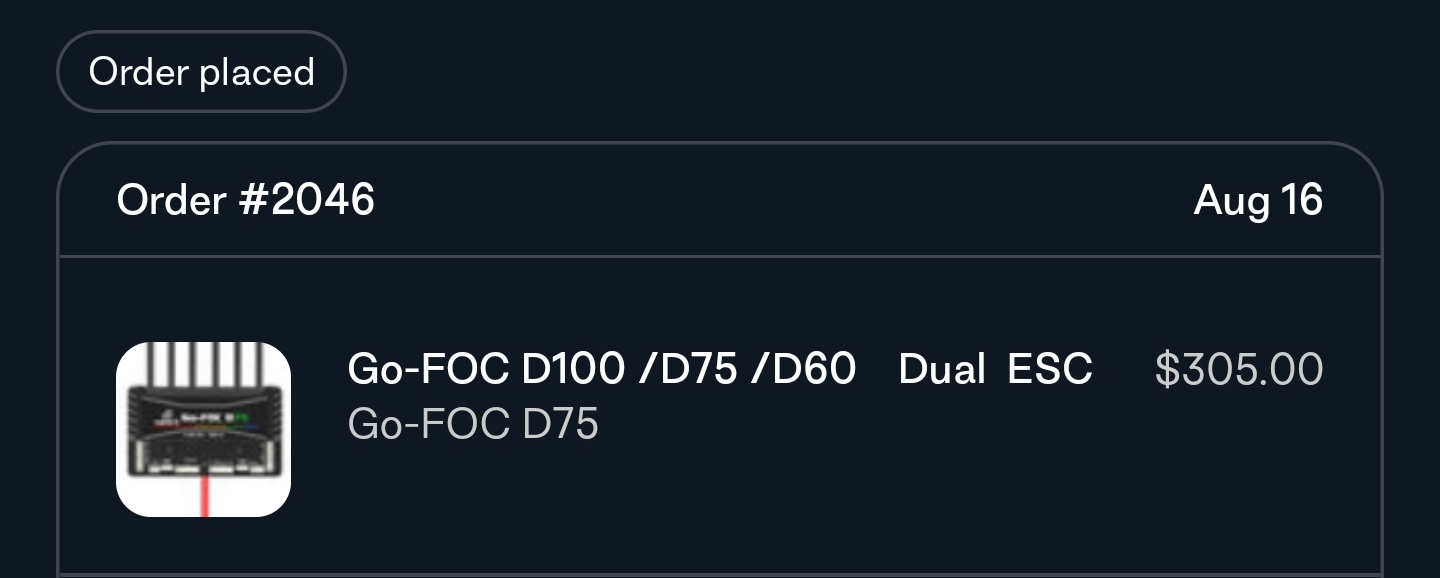

Well, despite the apparent FW issues, customer service has pushed me over the edge and I bought one. This’ll be my third Maker-X VESC in a row and if this one performs as well as my DV6 and DV6 Pro it definitely won’t be the last.
What do you mean by CS has pushed you over the edge?
Positive Customer Support was the deciding factor for him to go through with the purchase.
rare thing these days
