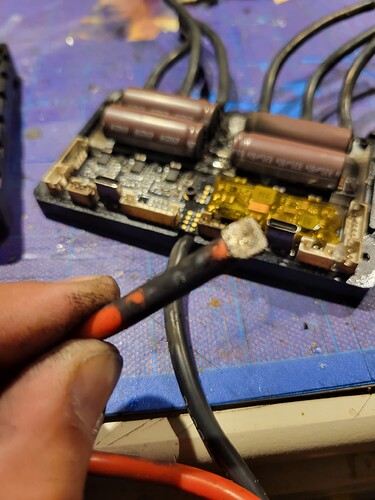

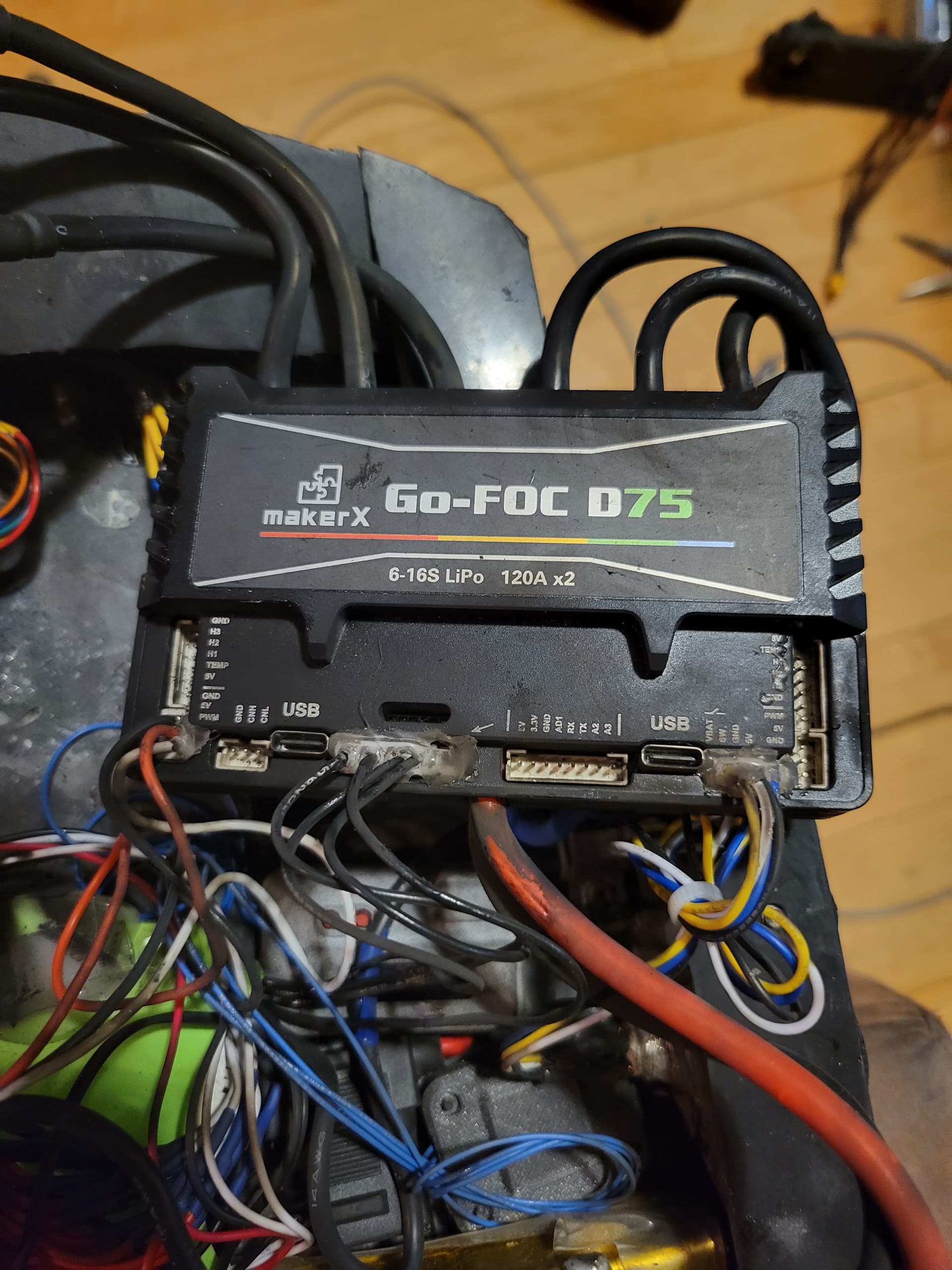

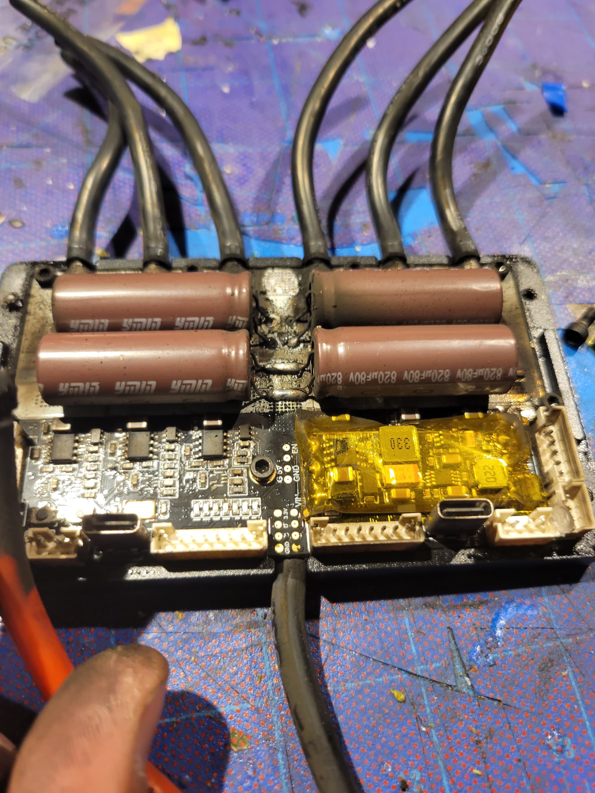

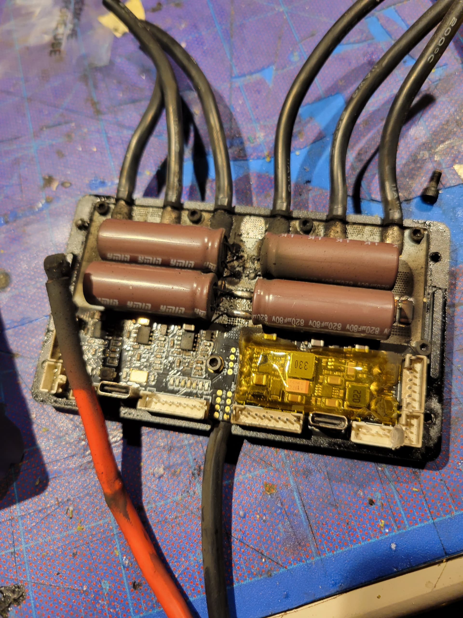

My makerx d75 caught on fire dueing motoe detection. Opened it up and saw this. What do you think happen??
this kinda looks like a cold solder joint to me

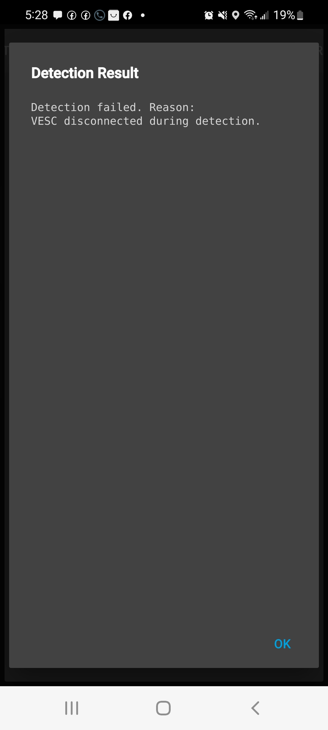

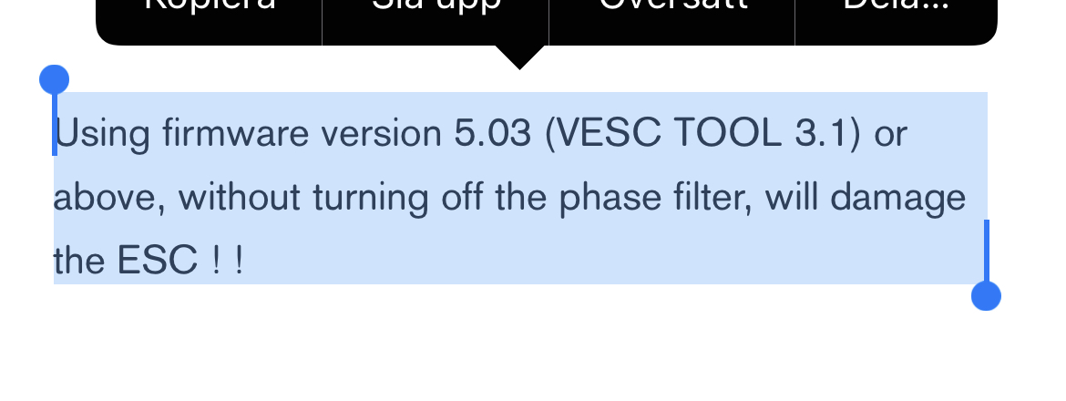

Whats weird is it ran like a boss for about 150mi before i decided to rerun motor detection on the bench after swapping my gear ratio. And all of a sudden poof. Just glad it didnt happen while i was riding
So it ran fine and next time the motors were activated it was during this detection process?
Did you happen to klick the “default all vesc settings” in the wizard at that point.
It seems important to keep the phase filters turned off… I don’t know if it could lead to this though.
Actually maybe they are default OFF in the firmware the unit is shipped with now that I think of it? :thinking:
Im just throwing ideas out here… sorry for your loss.
