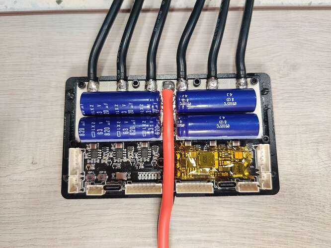

Another option I guess would be dielectric silicone grease, though that has a chance to wash away or vibrate off over time. Regardless, i’d highly suggest to re-arrange your pad spacing to reduce the possibility of arc. Considering the few failed ESC’s we’ve seen have a blown positive solder connection, I suspect this has something to do with it. If I do add insulating material to my ESC, will that affect any warranty? I also need to swap to 4mm bullets and AS150 connector for my board.
Should people just add their own neutral cure silicone (dab of hot glue)?
Simple test before assembling the case. Full current test after assembled the case.
Good to know; as it turns out, I was mistaken and the air gaps are probably fine, though with the proximity if anything even remotely conductive reaches the pads it’ll still cause a pretty serious short. I’ll probably still add conformal coating of some kind just to hedge my bets.

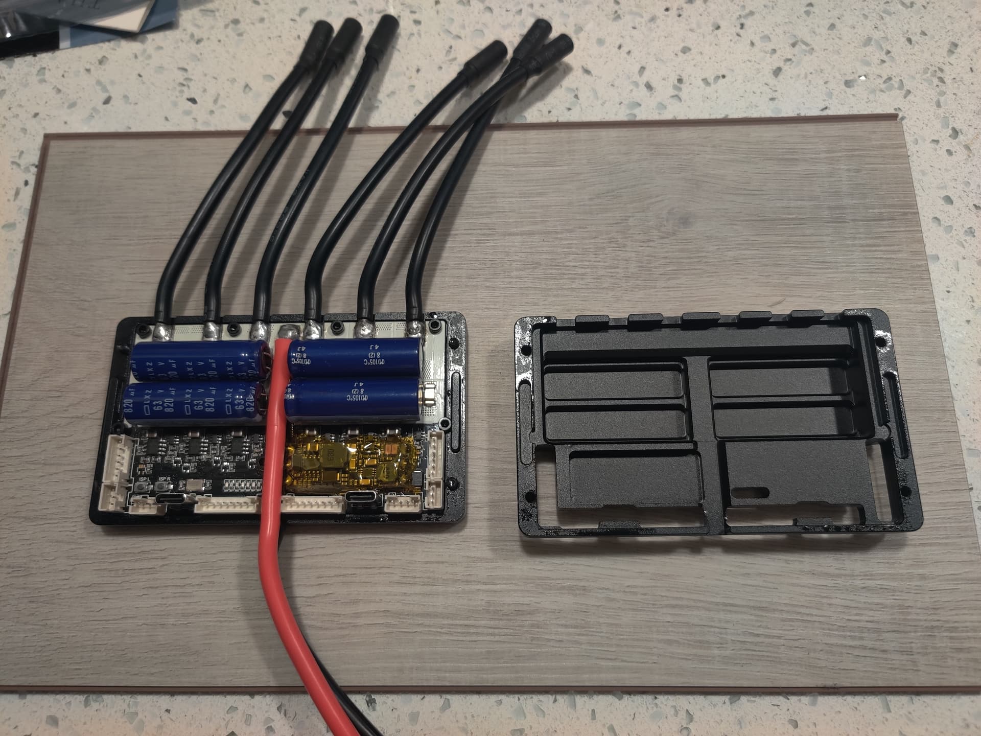

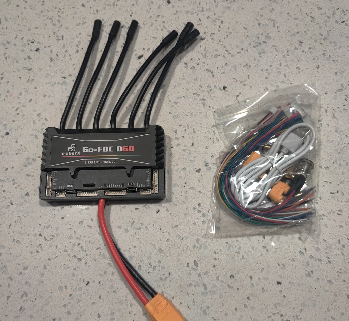

Came with correct 5.3 FW uploaded and passed motor detection the first go on a pair of 173kv Reacher V4s. No issues so far, wheels are rolling. I’ll post an update once I can push this thing a little harder, but I’m already higher than what I felt comfortable with on Stormcore.

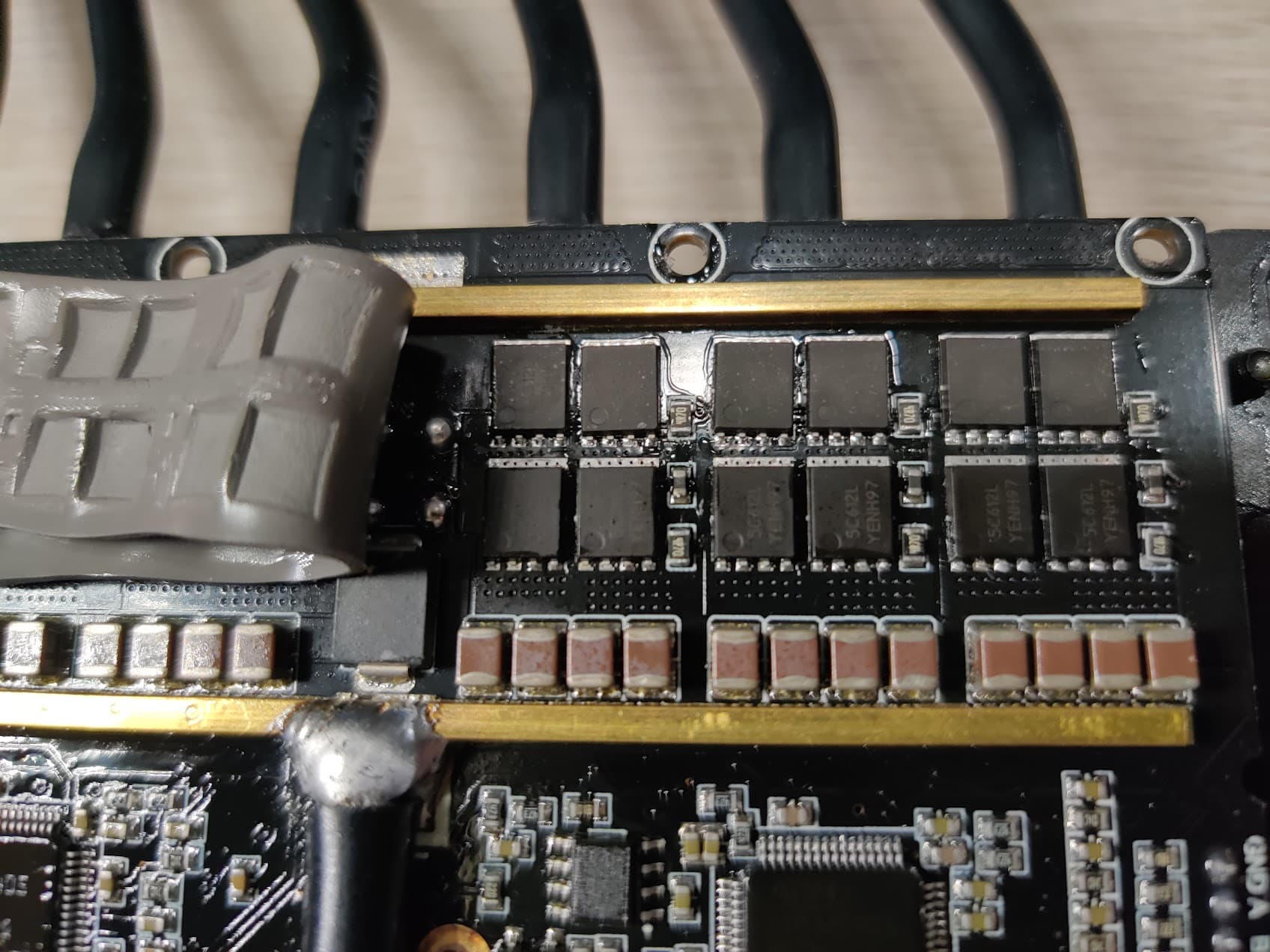

Not much to note. It works. The power button is much smaller than Stormie so needs a grommet. ̶H̶a̶s̶ ̶a̶n̶ ̶r̶g̶b̶ ̶l̶e̶d̶ ̶f̶o̶r̶ ̶p̶o̶w̶e̶r̶ ̶i̶n̶d̶i̶c̶a̶t̶i̶o̶n̶ ̶s̶o̶ ̶t̶h̶a̶t̶’̶s̶ ̶n̶i̶c̶e̶. *Not sure why the power switch indicates vbat on one of the pins, but that led stays green. Phase wires are 11awg. Mosfet side is conformal coated.

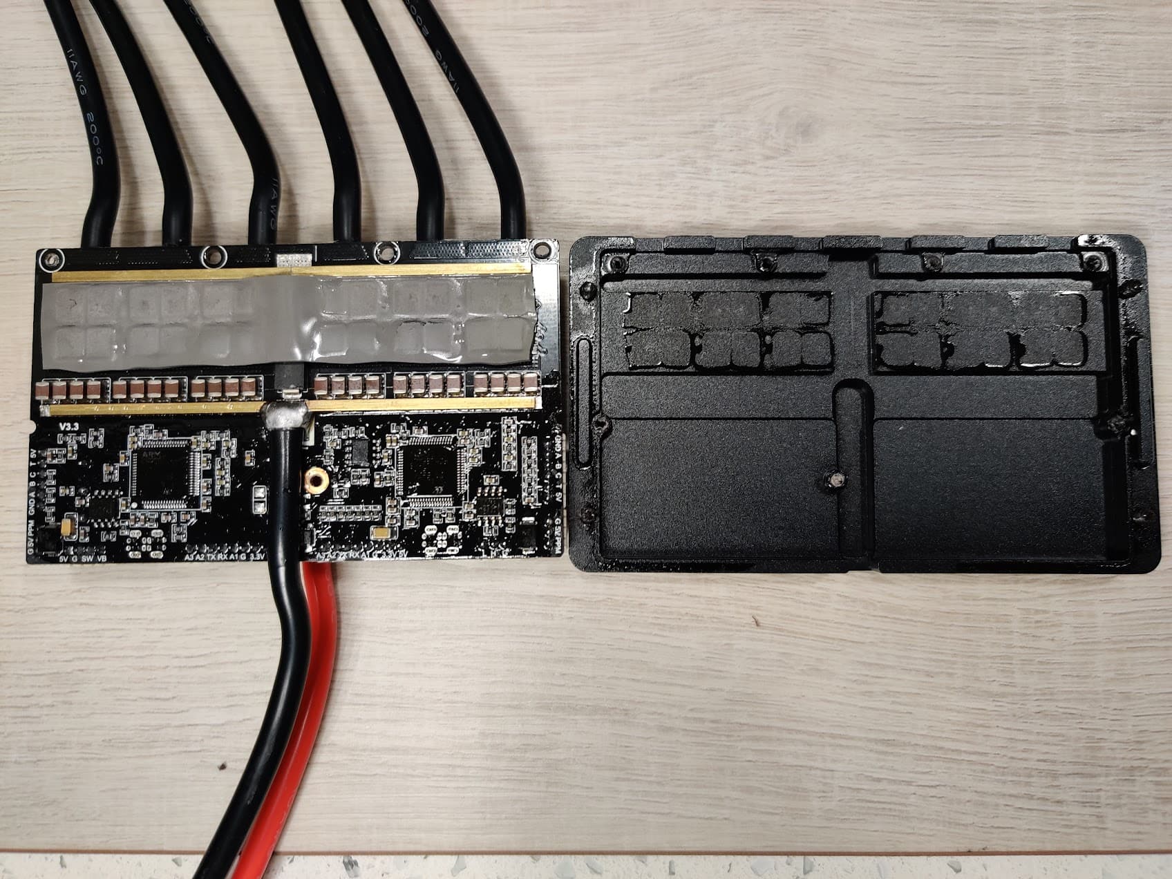

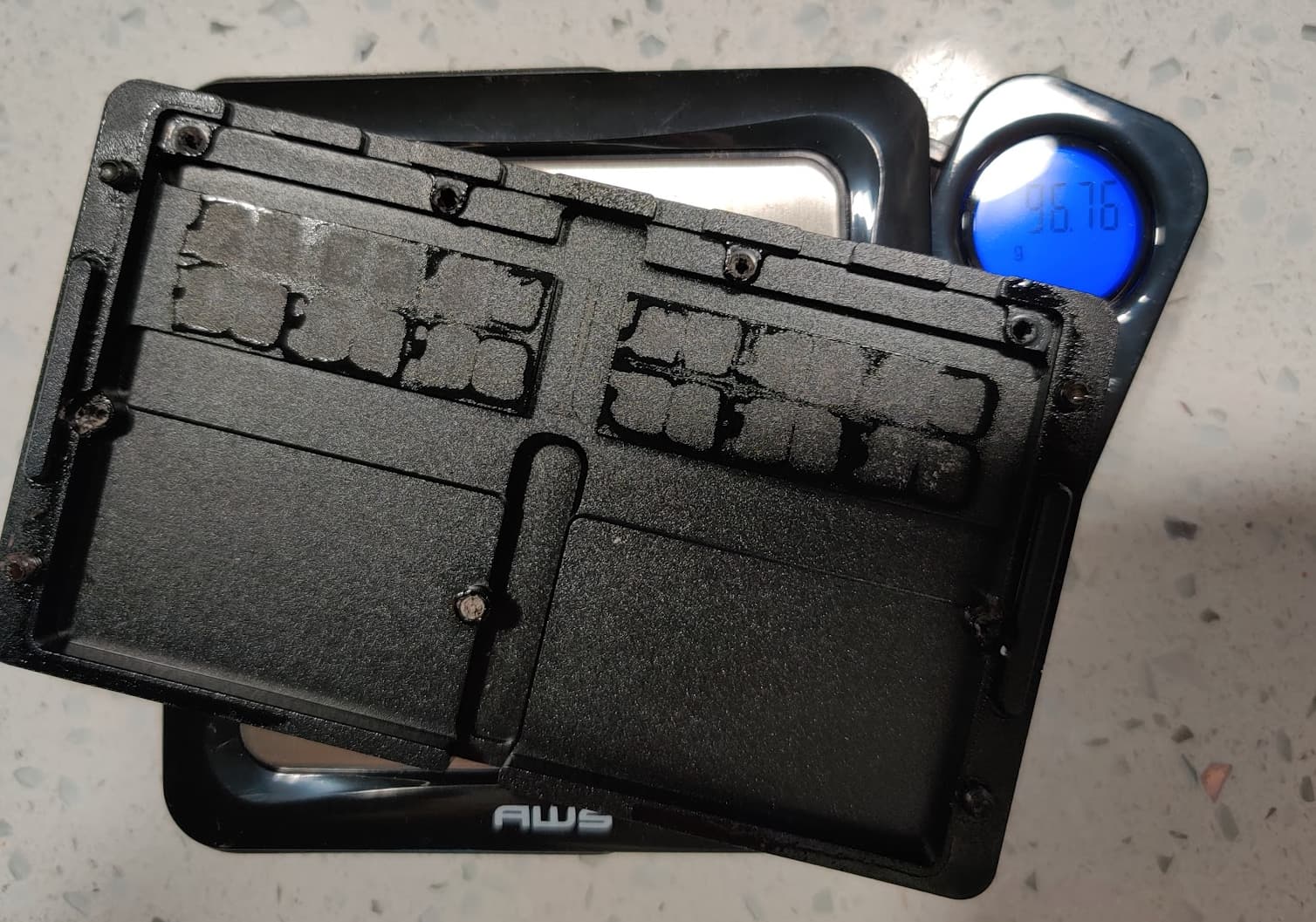

No glue under the caps but instead a piece of thermal pad.
What gauge are the power wires? Looks like 10awg?
Yea they are 10awg
If you want to change them it’s really nice on the PCB. Nice large pads, plenty of solder already on there plus it’s low temp melt solder. And the pads seem to be secured under a layer of PCB meaning less risk of lifting a pad.
Almost seems like they expect people to resolder their preference onto it. I wouldn’t try anything larger than 10awg though as I don’t think the heatsink will fit over 8awg
The button is receiving full battery voltage for some reason, tested it myself
thats funky. flipsky also did this with their older latching antisparks (maybe the momentary ones too, I never tested those)

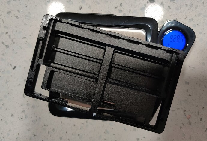

No mounting pattern?
Yea not sure why. Lots of CNC going on everywhere else.
I left my Stormcore heatsink on the board so it’s thermal taped to that. Not ideal, but working.
You can use the four corner screw holes if you get the right length.
