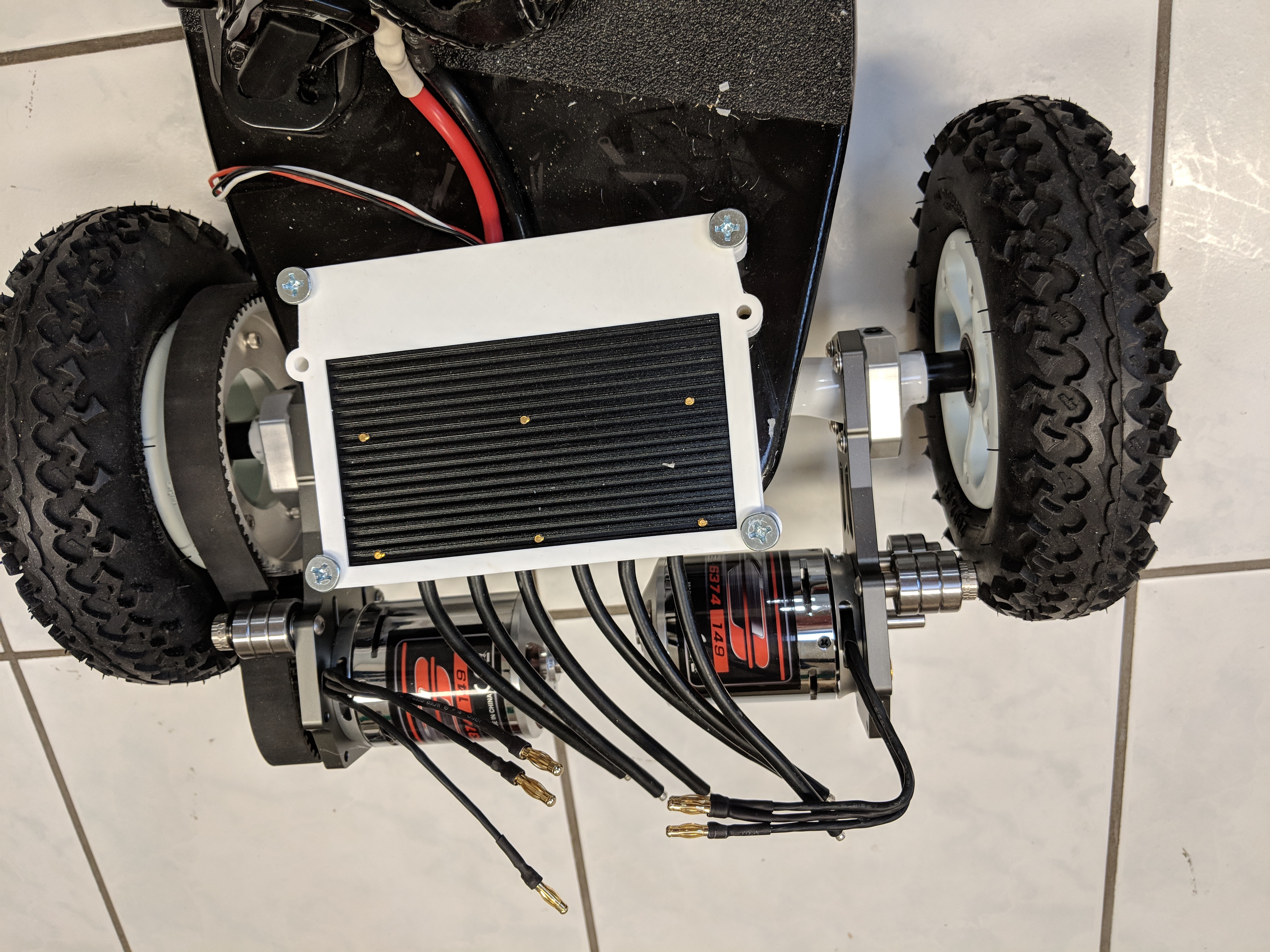

GGG Skateboard | Samsung 12s5p 30Q | Dual Turnigy 149kv | Dual FSESC6.6 | Belt Drive | MBS Board

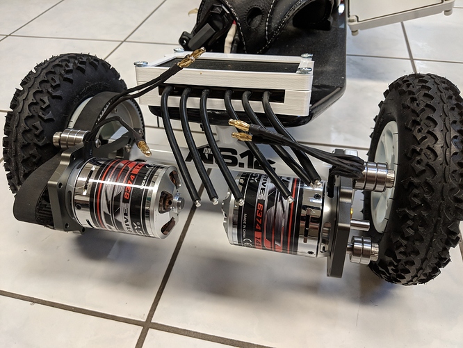

Go-Go Gadget Skateboard, aka GGG skateboard. This is my first build. About 90% done, just a little bit of soldering and programming the ESC.
Nothing exotic here, just a standard MBS build. Big thanks to @Dirt_Bag for giving me a great deal on the battery.
Will post more pictures and impressions once I get it going. I am located in San Jose, CA. Looking for some help with setting up the ESC. Willing to show up with pizza. Can also offer CAD work and 3D printing in exchange for some help setting up the ESC. Trying to get this done for the race in SF next month.

I am a mechanical person. Building the board is easy for me. Software wise, slightly intimidated. But I am sure you are right. Will give it a shot. Any suggestions on what initial settings to put for my set-up?

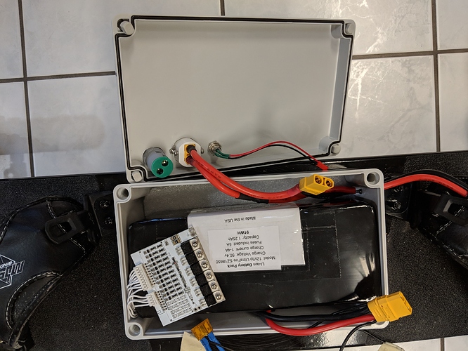

Depending on who / how you made your battery, that will determine your battery limits. Theoretically, if all wires are thick enough, your battery can do 100A discharge and 20A charge. 20A might not be enough for you, so many people here raise that to no more than 2x the rated spec just to have stronger brakes in emergencies. Remember that you have 2 ESCs, so each one should be set to half of that, so 50A discharge and 10A charge for battery settings.
(I’m assuming your battery has a charge only BMS / a discharge one that can handle the charging current. Please report back your exact specs to be sure)

Battery is charge only BMS. I am running 12/72 gear ratio.
Its safe for 100a pretty easily. It can go higher, but it will run a little warmer than normal.

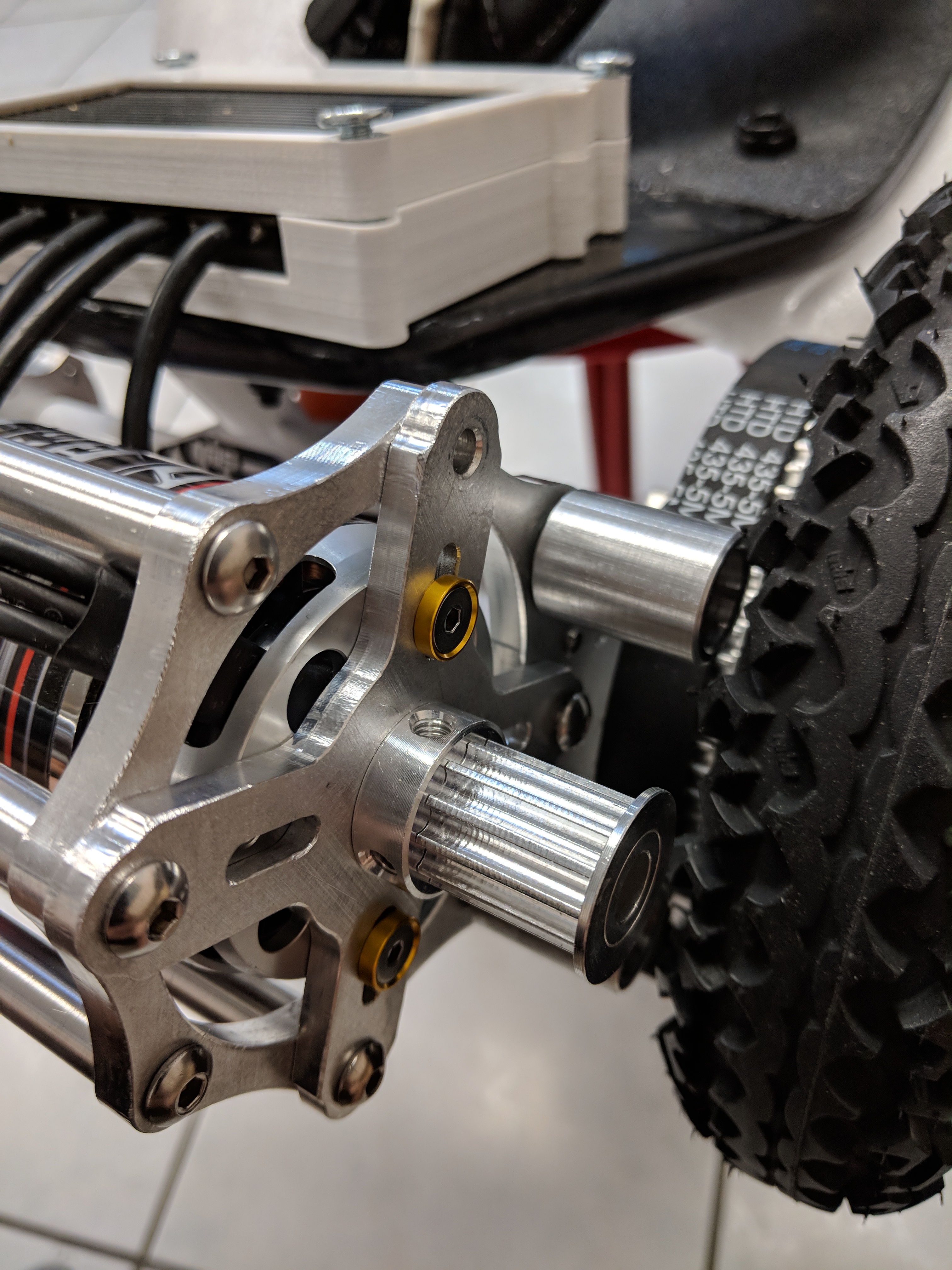

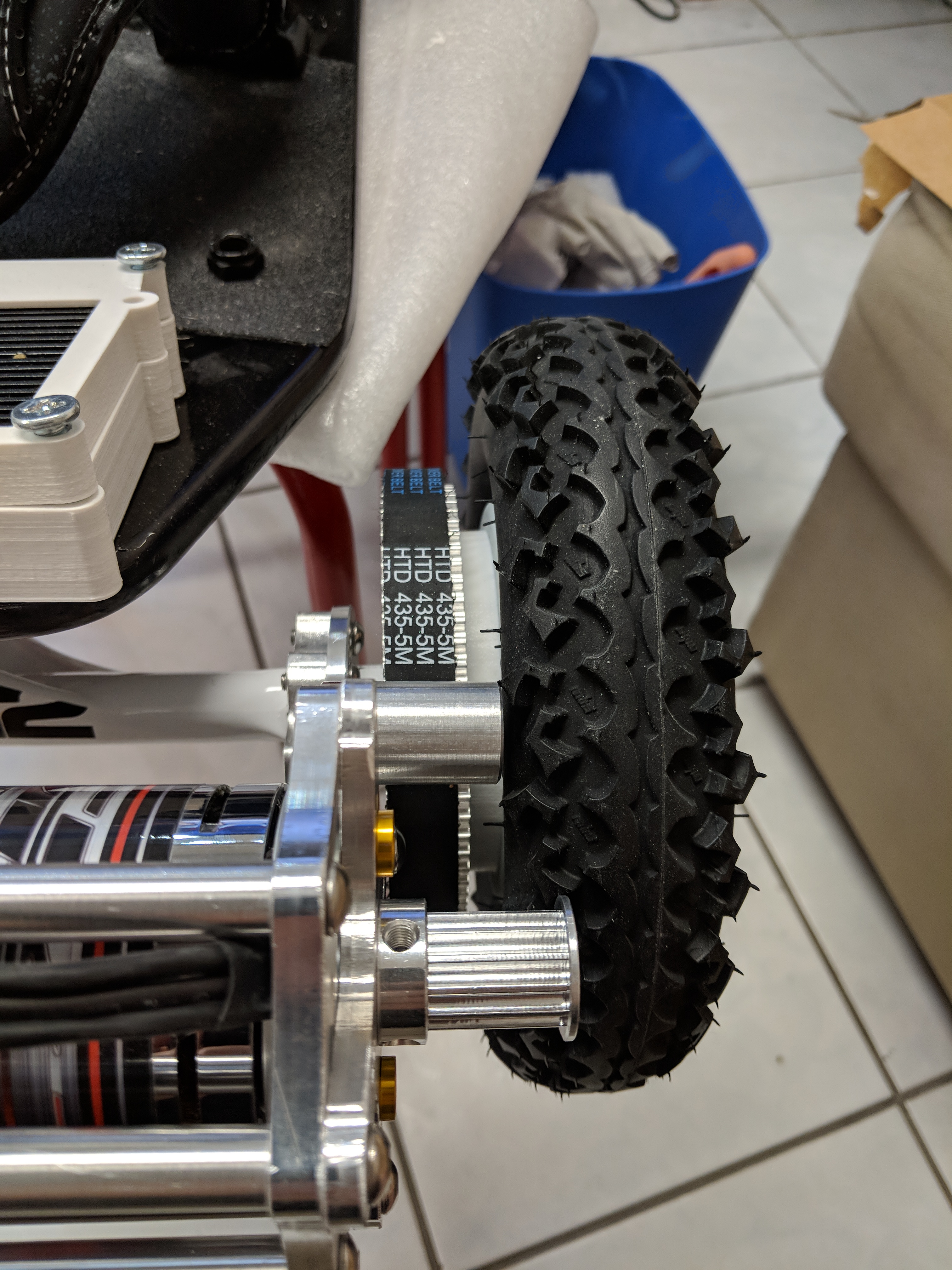

Running into all kinds of issues building this board. My original motor mounts did not work, so I just bought some Janux mounts. They fit a lot better but now the pinon will not line up due to the hole on the plate that mounts the motor is too small for the pinon to slid back far enough. I was recommended the Turnigy 149Kv motors. However feeling the this motor is giving me issues before I even use it. First did not realized it did not have a D-cut on the shaft. Now I think due to the missing D-cut, it limited the pinons that I was able to find to make it work. Now? Not sure what I should do to solve my issue. Make hole bigger on motor plate? Get new motor?
Really thinking about scrapping the whole project right now. Someone make me an offer. Can bring to the race next week in SF.
Just reverse the motor pulley and file/dremel a flat spot on your motor shaft. Alternatively you could use some loctite 680 retaining compound and not worry about the grub screws. I would personally dremel a flat spot though. Be sure to bag the motors first so none of the metal filings get into the cans. Don’t give up brother you are so close.
Can you just add another aluminum spacer to make the wheel pulley line up with the motor pulley?
Can not reverse the motor pulley. It is designed in a way, that it will only fit one way. This build is already way over budget, but is there a better option for a motor?
Thanks for the suggestion.
Due to the cross bars, the motor plates are pretty much fixed. If I place the plate that bolts the motor on the inside, it will work. Only issue, the cross bar rods will not fit. They would need to be cut down the thickness of the motor plates.
thanks for the suggestion.
What do you mean? The collar can be on the outside. Explain why it won’t fit please man
