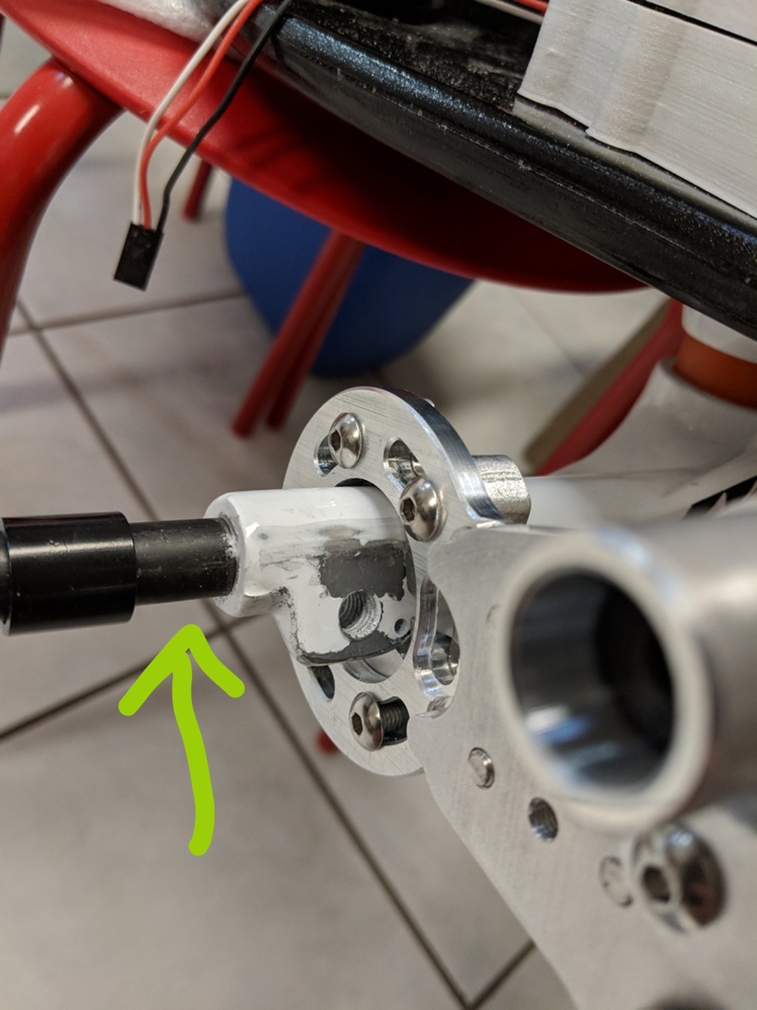

The motor shaft is not long enough if I flip the motor pulley around. I wish it was that easy.
2 choices and both are easy. You buy some retaining compound and flip the pulleys. Loctite 680 will hold that pulley on there like a mechanical device. My gear drives are the same motors and have no screws just the compound or you buy some different pulleys. Hobby king sell a pulley kit extremely cheaply which have grub screws in the teeth no collar. As do Torqueboards

No no no, I mean putting another spacer between your truck and wheel pulley.
It wouldn’t affect the motor plate at all. You just would need a long enough axle.
I used to rock those same trucks with crossbar mounts
Just pick up a couple pulleys that don’t have the collar on them and do as @dareno said and either grind a flat spot on the motor shaft or use Loctite /retaining fluid.
If I add a spacer there, then the idlers will not line up anymore.
Your idler already doesn’t line up with your motor pulley. Just giving you options.
Personally I’d find a new motor pulley that had the grub screws on the pulley and not a weird collar. Should be $15 a piece maybe. Check your motor shaft size and shape first.
