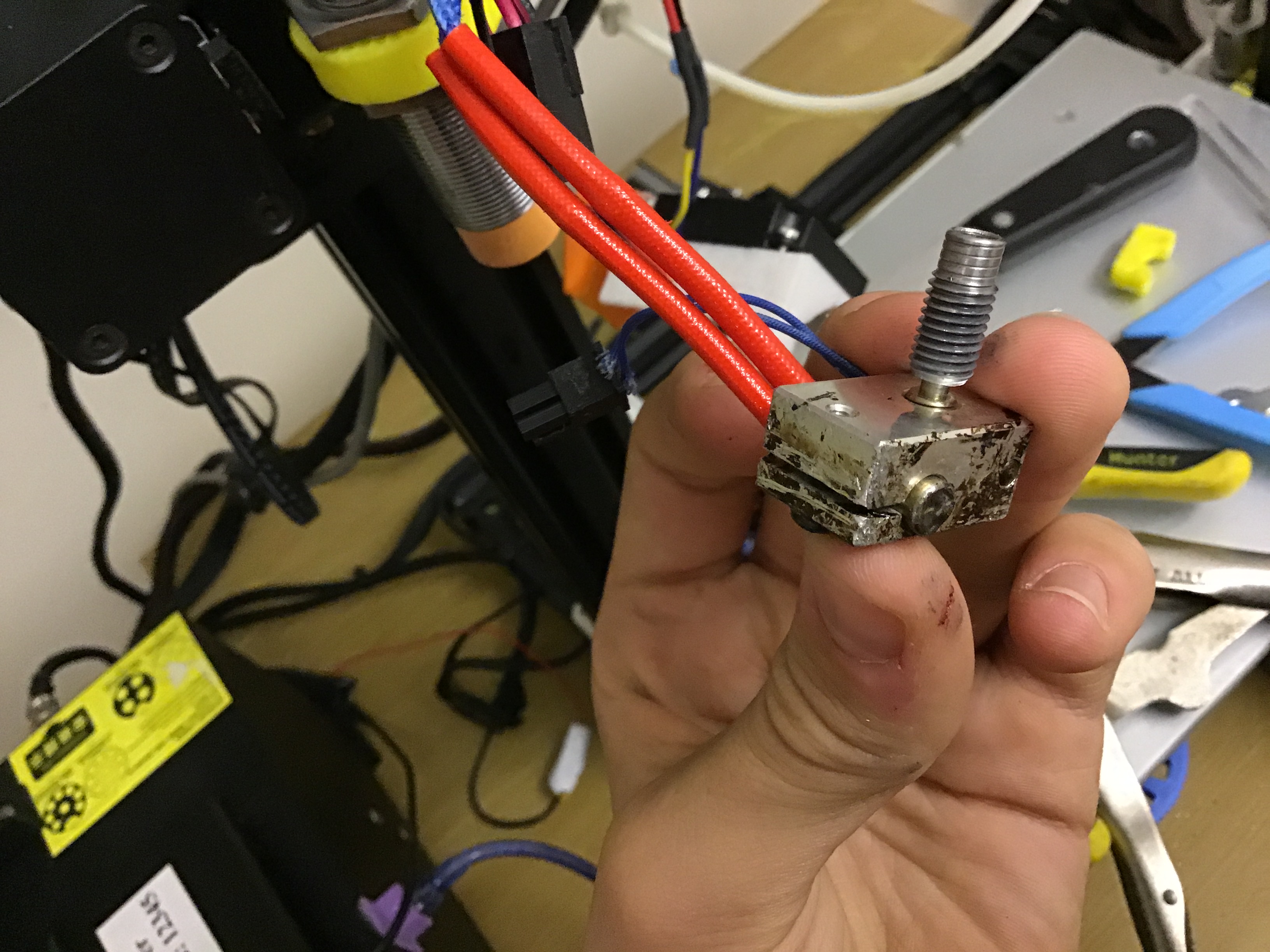

Also could anyone help me and explain how to remove the red heater wire

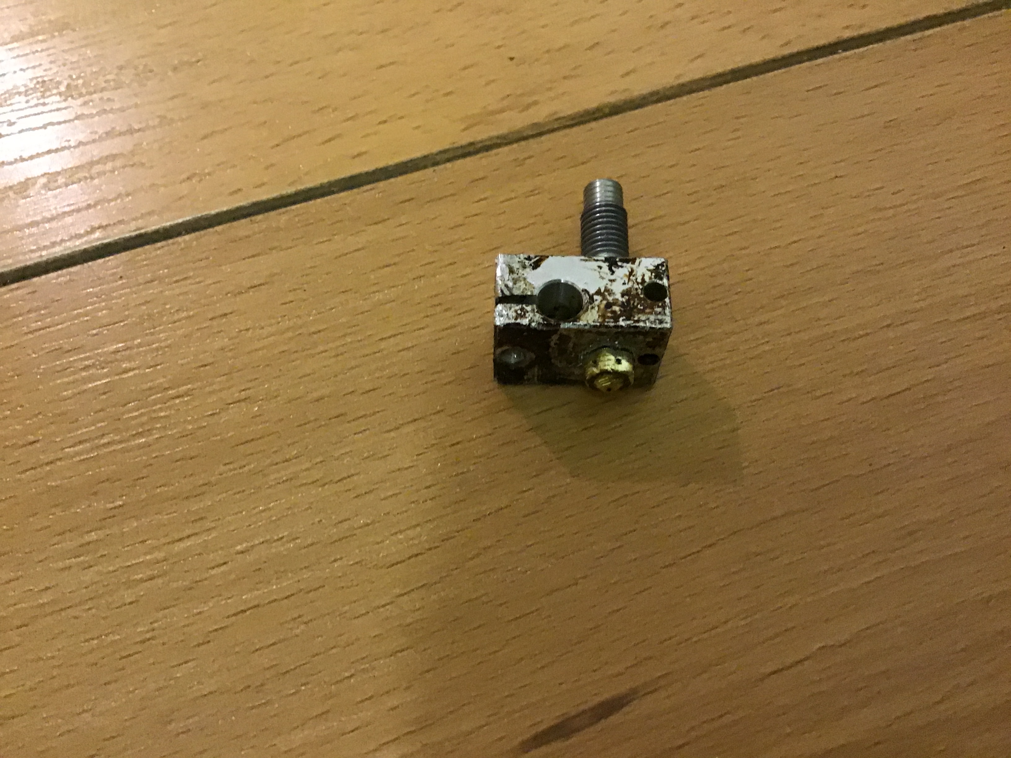

Popping sound is moisture. 100%. Trust us. Pop that in the oven at 50degrees Celsius for an hour or so. It won’t do anything to the plastic so it’s safe to do that in the oven.
As for the hotend. Heat the hotend and while it’s 245C try to remove it.
For removing the thermocouple remove the screw next to it. And push the sensor out. If it’s not budging then heat the heatblock with a small blow torch.
The hotend ain’t budging I think @skunk is right and it has rusted together
I will try putting the plastic in the oven and see either way ordered the new upgraded hotend but and will try using that tomorrow or the day after thanks for the help guys
Or it is filled with plastic?
Same thing happend to our cr10 you need to upgrade the nozzle
Those things are made of aluminum if I am not mistaken. They don’t rust. I think it’s because of burned plastic stuck between threads…
This is exactly it, if you dont take care of it @Halbj613 it will happen and the only real fix is just replacing it
The other real fix is heating the whole thing with a blow torch so that you purge everything except metal.

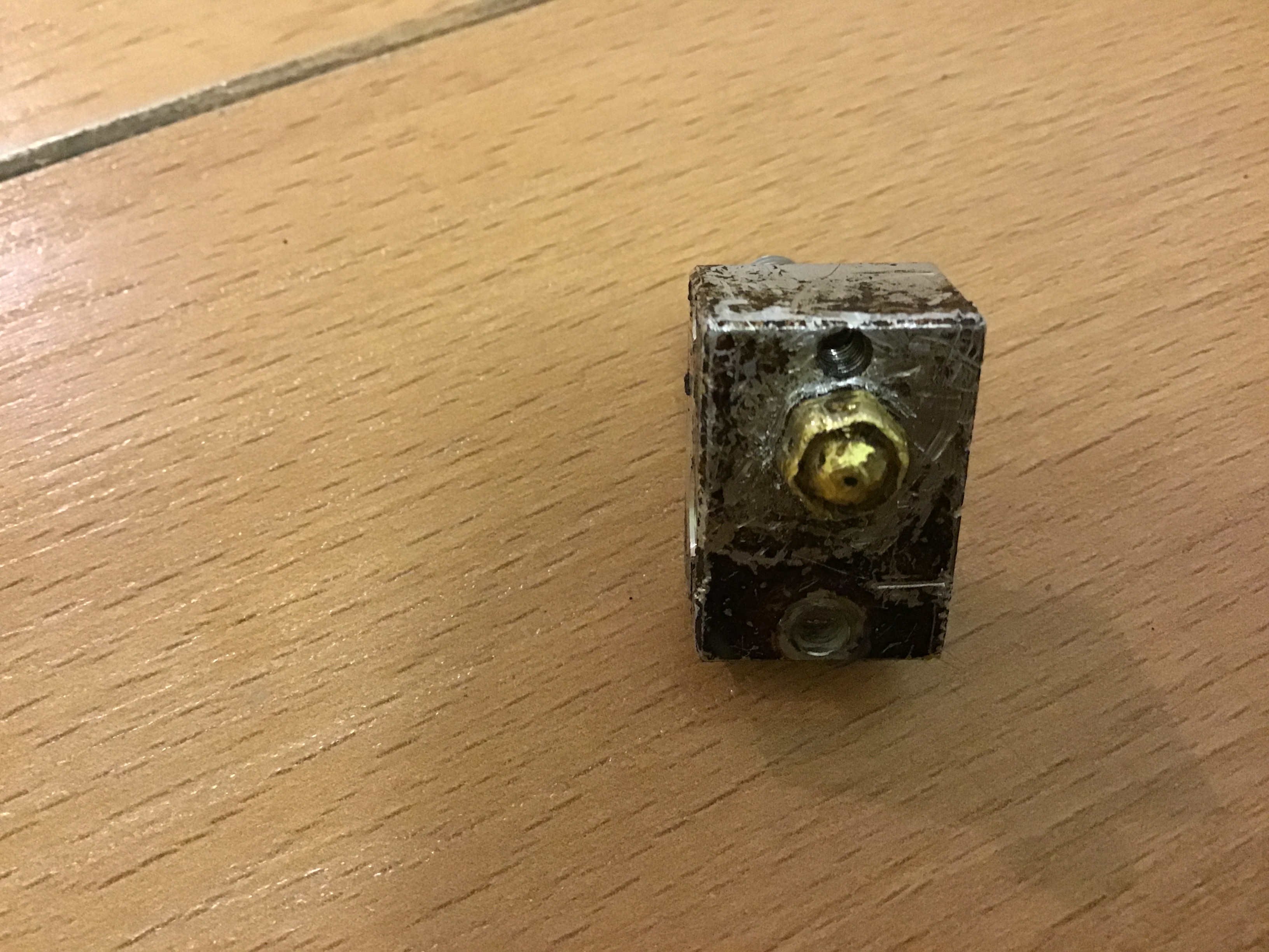

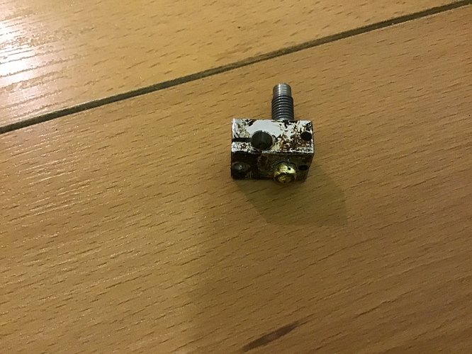

So here is the hotend after the wires were removed
Should I soak in acetone overnight
Don’t own a blowtorch so sadly that won’t work
What do you mean plastic got in between the threads
It’s only a couple of dollars or pounds on AliExpress. Just get replacement ones. It’s not worth it.

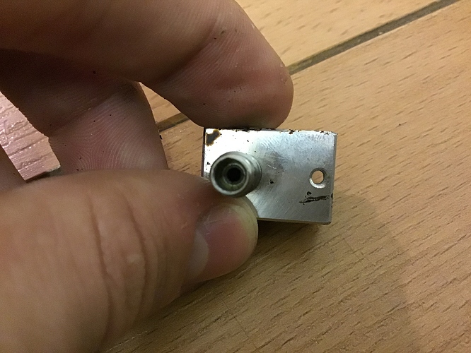

Yeah thats what we did but it only delays the samething happening again
So I ordered a new e3d upgraded hotend which comes with those sock blocks to prevent this from happening and a new nozzle so hopefully it should work
So I ordered the new nozzles and heat block and then 10 minutes later my dad gets home sticks the nozzle over a gas stove and burns the nozzle right out he got rid of tons of junk from out and I tried again with a roll of abs it is definitely feeling smoother but the popping still remains
I will replace the nozzle and if it still doesn’t work ( I have also put the filament in the oven) then I will use my new heat block
Thanks for the help everyone
For 10 mins? That’s not going to do anything. You need to put in there at super low temp. Like 60C for ABS for at least a couple of hours. Popping sound is moisture in filament. It has got nothing to do with nozzle or heat block?
