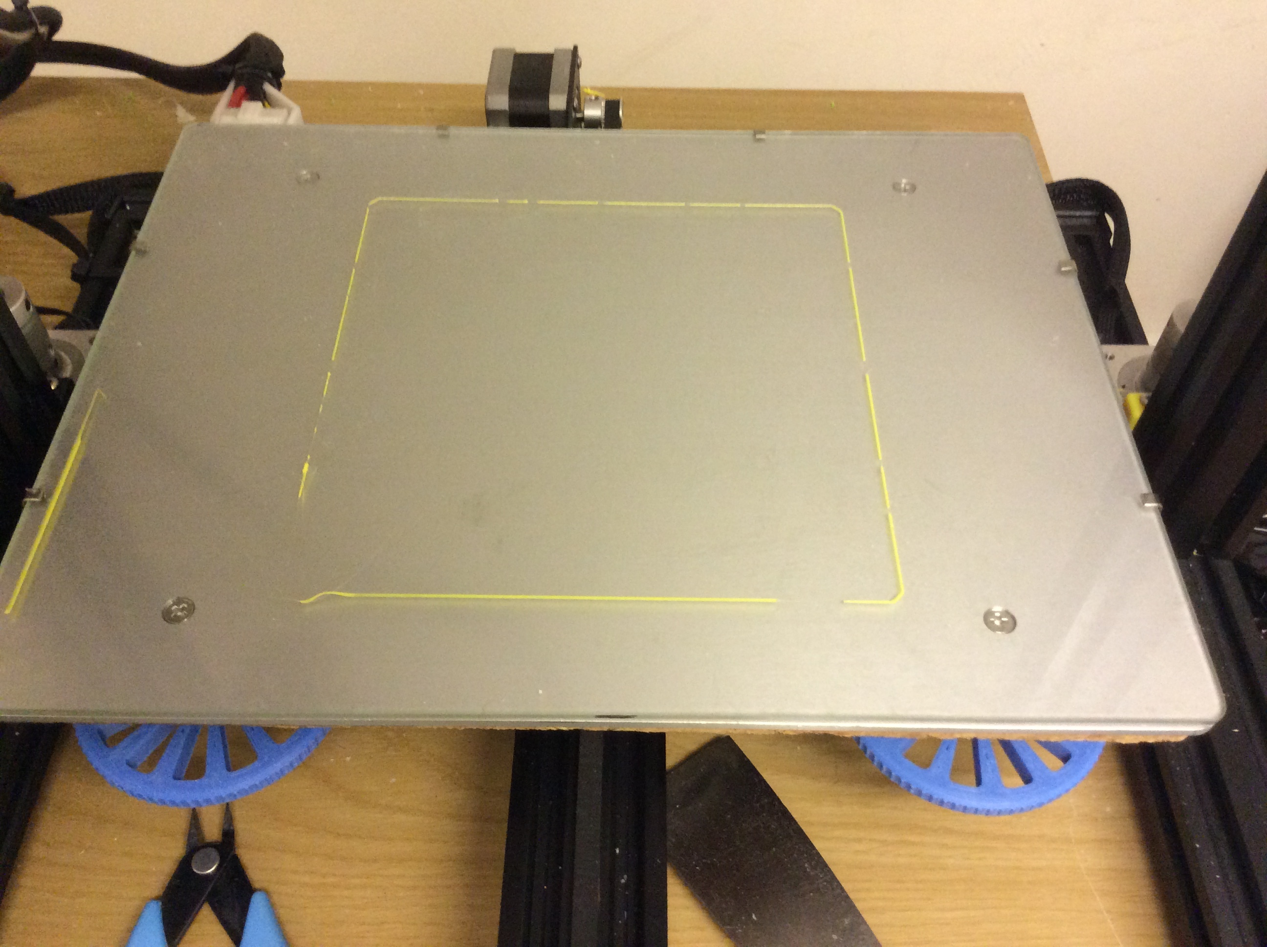

So I was wondering if anyone could help me with a problem I am having
Whenever I print a small popping noise comes out the hotend and then a small hole happens at the same time in the print (picture below)
I have confirmed it is not a humidity problem so not sure what it could be
Please help if possible
You’re getting gaps in your printing. That pop is when it goes from extruding filament to air. The holes are because of that air. Do you hear a grinding noise from your extruder like it’s clogging up?
popping noises are most commonly from moisture in the filament. I would recommend drying it before anything else
So as I said the filament definitely isn’t the problem I tried quite a few different rolls and all of them had the same issue
It doesn’t sound like the extruder is the problem and I don’t hear any grinding
rather I believe it could be because I superglued a bolt that wasn’t near the hotend and maybe the superglue might have seeped through a bit could that be the problem
