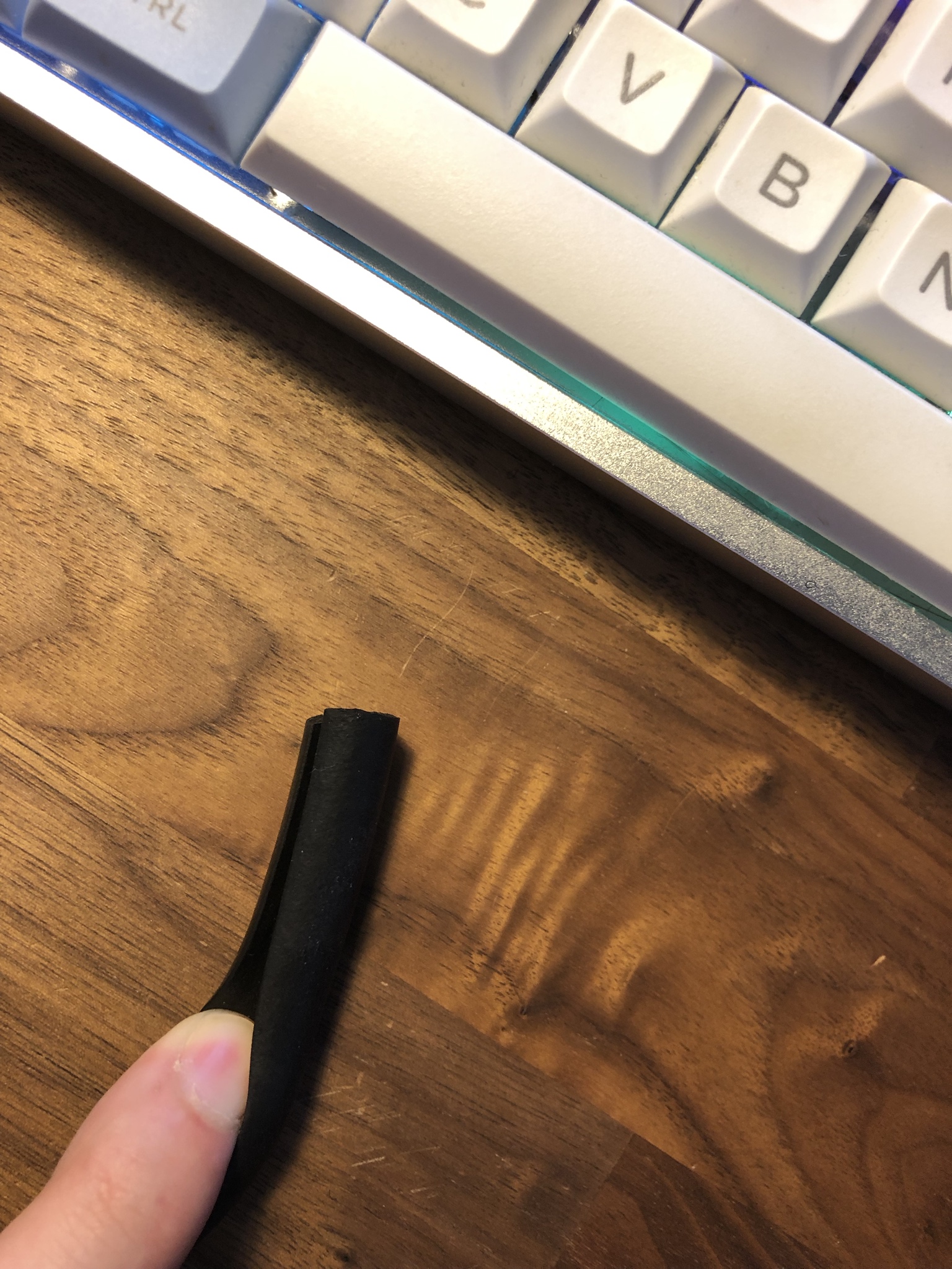

I have also added a rubber gasket around the battery and ESC enclosure. I used one which has this trace inside it, that I put over the edges of the enclosures.
