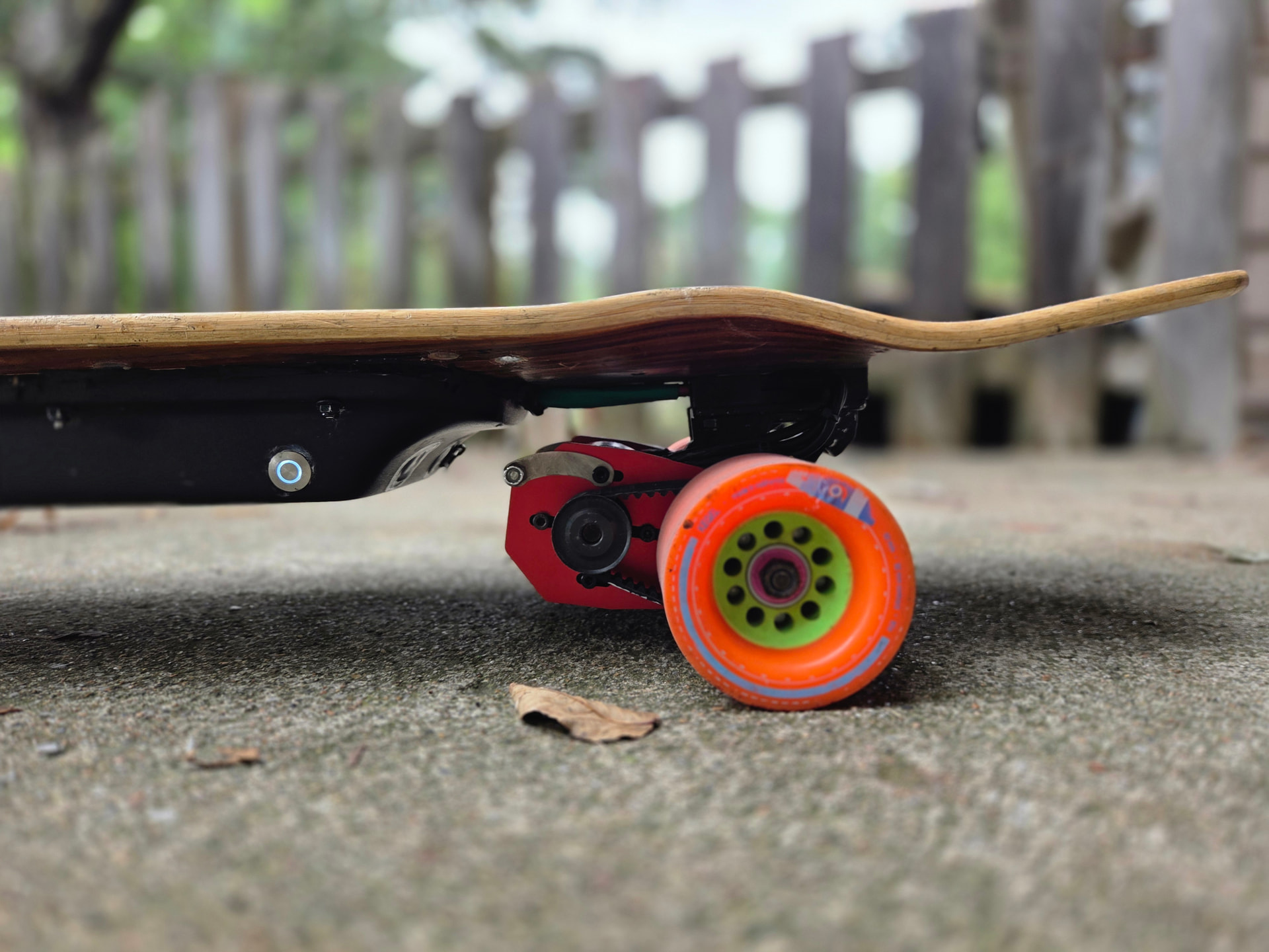

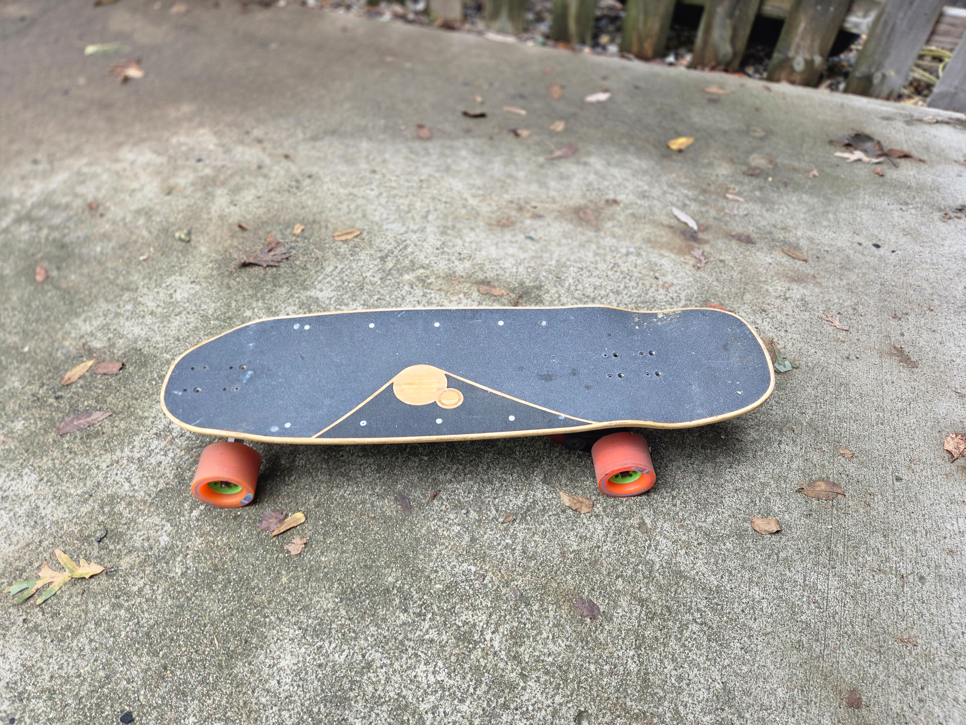

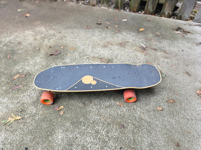

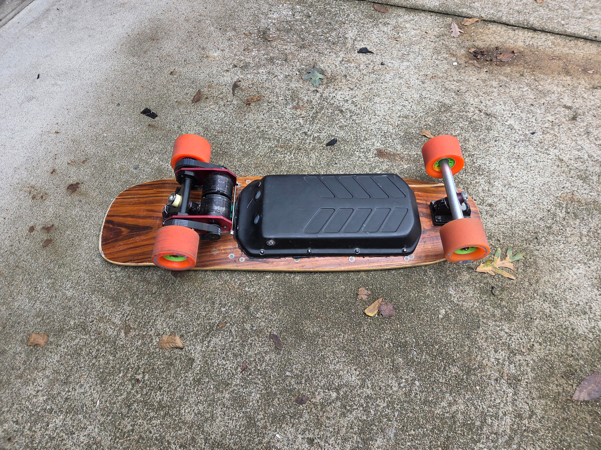

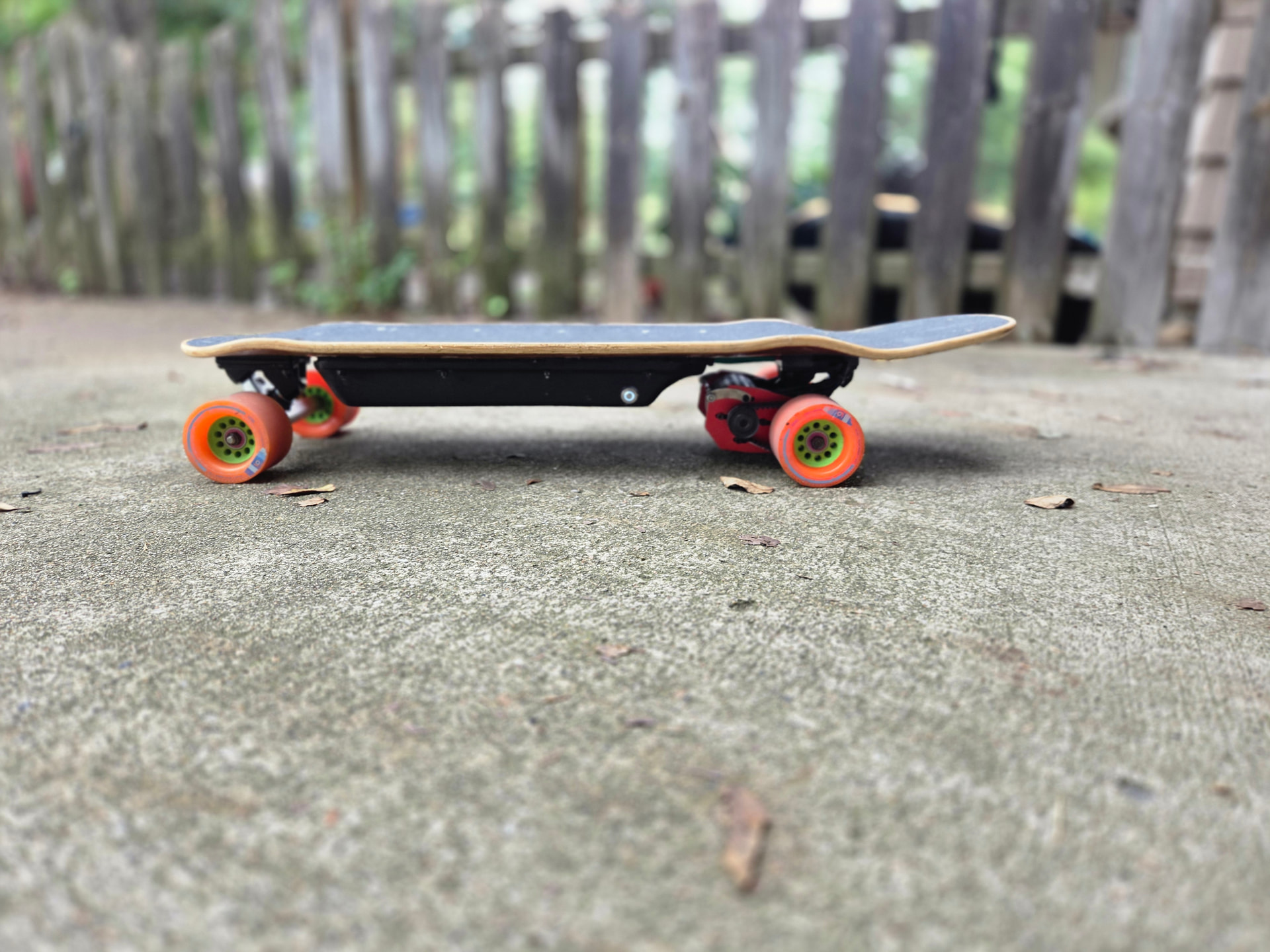

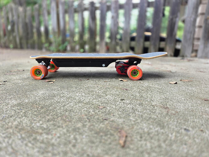

Hey kids.
Making a my little Omakase build with dual 6354 190kv
One is coming up sensor less.
Will it be best to run Sensored and rely on just the one side?
Or should I just go for silent HFI???

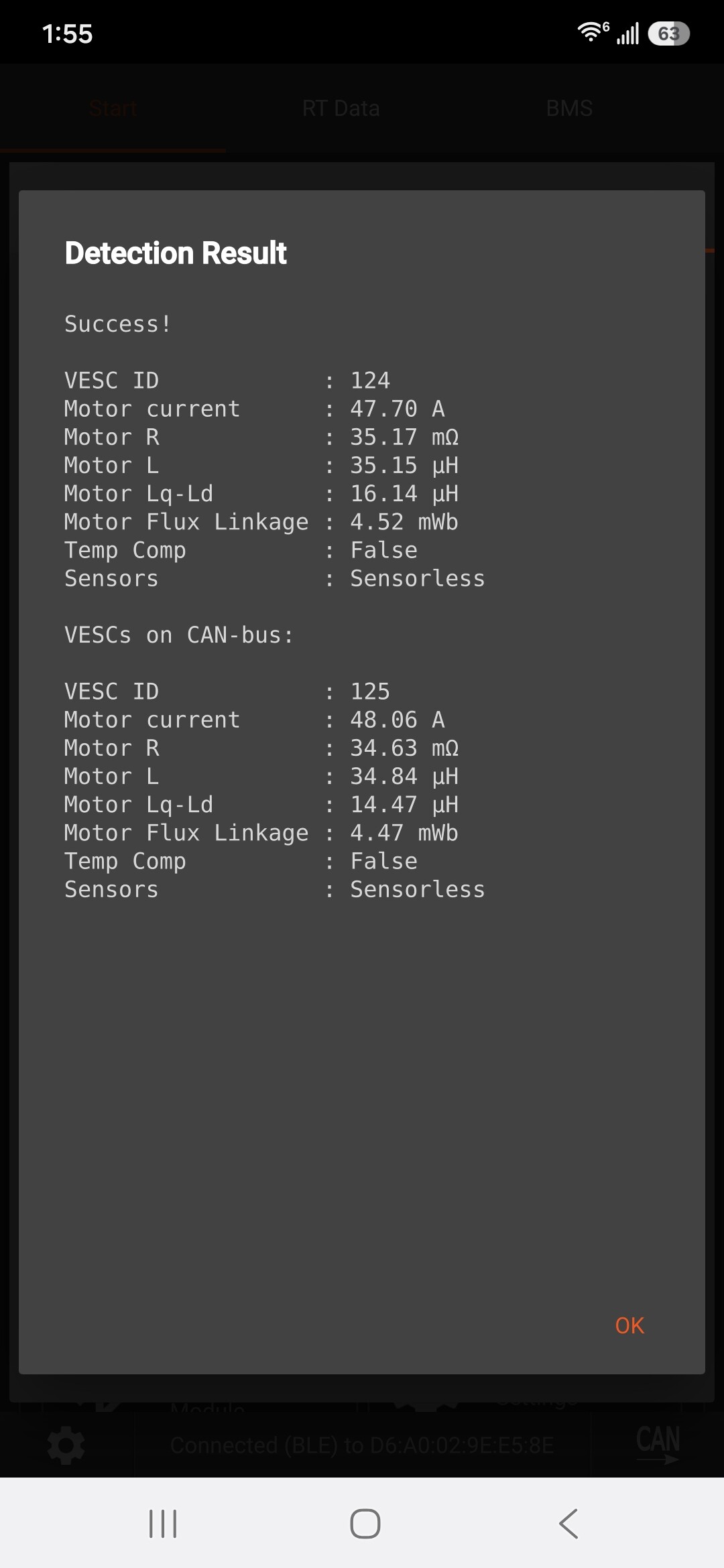

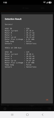

In my opinion, it would be better to run sensorless on both sides (yuck) or try HFI or sHFI on both sides.
What is the measured Lq-Ld difference as a percentage of total inductance of the motors? That would determine my next move.
To get that, in the VESC terminal for each motor, type measure_ind 0.2 for each motor. You will get something like this:
For that example, it would be 1.90μH / 15.04μH ≈ 0.126 which is 12.6% which isn’t great. If it’s over 10% HFI will probably work mostly, 15% to 20% it will probably work good, and if it’s over 25% it will probably work excellently.

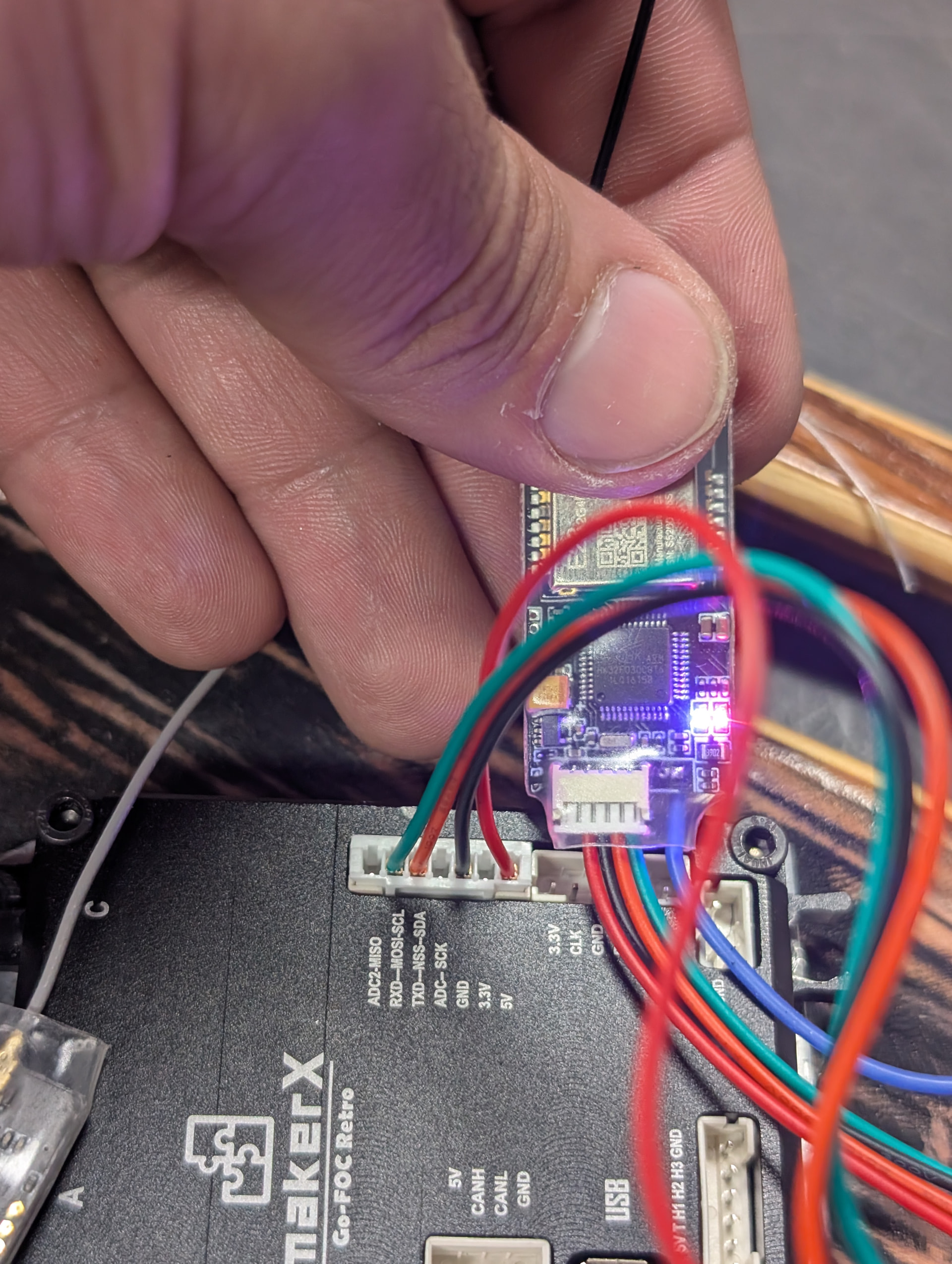

Installing a VX4 against my will and cannot get it to show any signs of life on the vesc side.
Are the steps not
  1. Confirm pin out on receiver and vesc
  2. Confirm baude rate
  3. Confirm the vesc connected is in uart mode (no vesc remote mode bc it’s an older vesc)
  4. Input wizard? There’s no option that seems to fit here.
Just give me a damn puck. The meaning of life could be on the remote display and I still don’t want one.
Nevermind the remote was locked by the customer when I wasn’t looking. SMH
I think it’s probably the same as the VX2 which I’ve used a few times, despite not liking the throttle curve that’s nearly impossible to tune around.
I don’t use the input wizard. If connecting with Bluetooth, I swap to the other can channel. Then set it in the app config.
To my surprise, the timeout value needs set in both channels of the app config. I’ve been setting that to 30ms since a broken pharmacy window incident. With the uart, it’s the vesc remote tab with the relevant throttle curve settings.
I think the vx4 has the option for ppm as well doesn’t it?
One of the sensors in my 2024 mach failed before I installed the ESD kit into it, so i’m running one side on hfi and the other side sensored.
Can’t remember what hfi mode i landed on but Liam and i just went through the options and found which one worked best without any tuning.
Apart from a slight ‘tick’ when i start from a stop, there is no other noticeable difference for me.
Oh I did not think I could do Sensored on one side and hfi on the other…
Oh well. Sensor wires have been chipped …
The kid I’m giving this board to lives in San Francisco… so sensors would have been ideal.
But I had to compromise on the motors… everything else on here is pretty Killer.
This is what I got on detection
Check for settings within the remote itself. Iirc Flipsky always had 2 modes, FSESC and focbox or something.
I’ve also done sensorless / sensors, worked fine. Theory was, one motor with less starting torque was better than both losing it.
