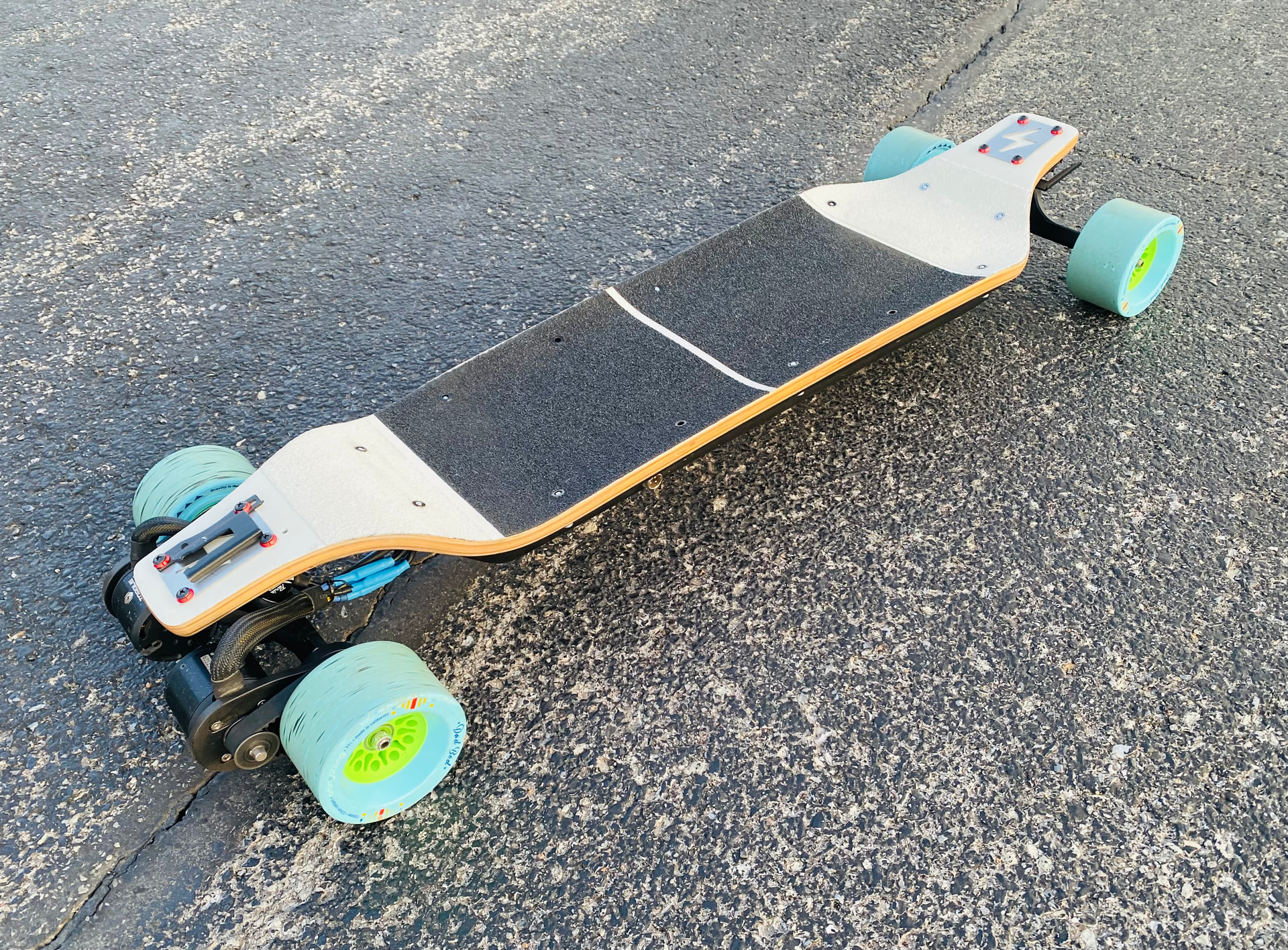

I made a little board for a neighbor kid.
I want to put setting in the Vesc to keep them from killing the battery.
I don’t want a hard shut down. Just a significant slow down.
Where and what do I set?
It’s 12S

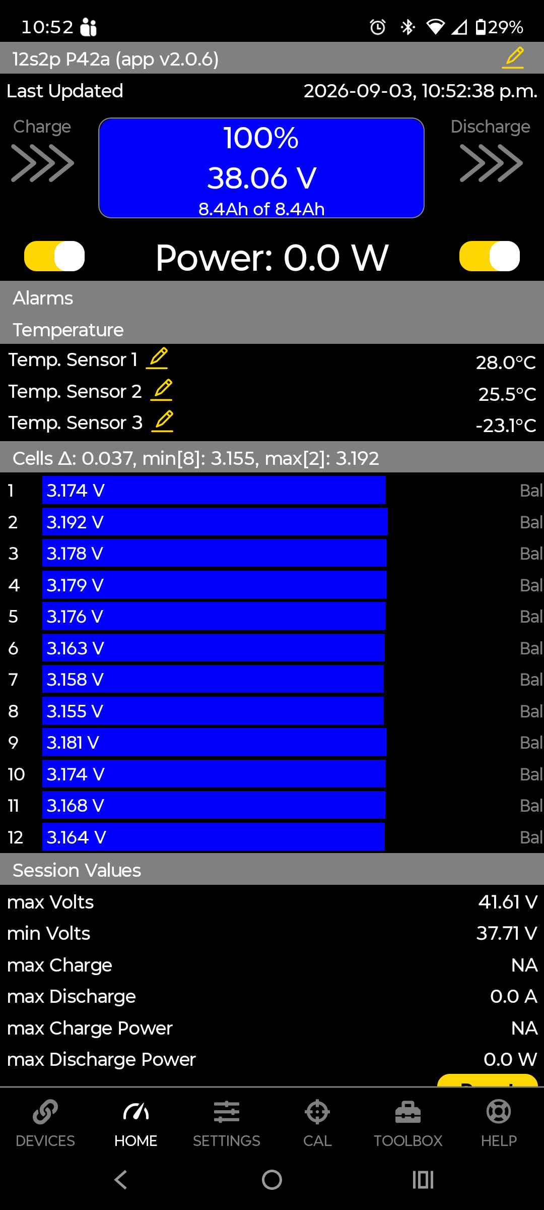

Just charged my board, when i turned on my vx4 it shows less than 1 cell still. I then checked overkill to see that one of my temp sensors is reading way off causing charge under temp. Preventing me from getting a full charge, is that something i can bypass? Is that unsafe if i know its reading wrong? Will i have to rip my board open to check the wiring? Or is that something i should have a battery builder diagnose, any help is much appreciated.
I did take it to the store after charging and it keeps running after the vx4 says its dead, im half scared its going to toss me on my way home or light up like a tiki torch :sweat_smile::rofl::sweat_smile:

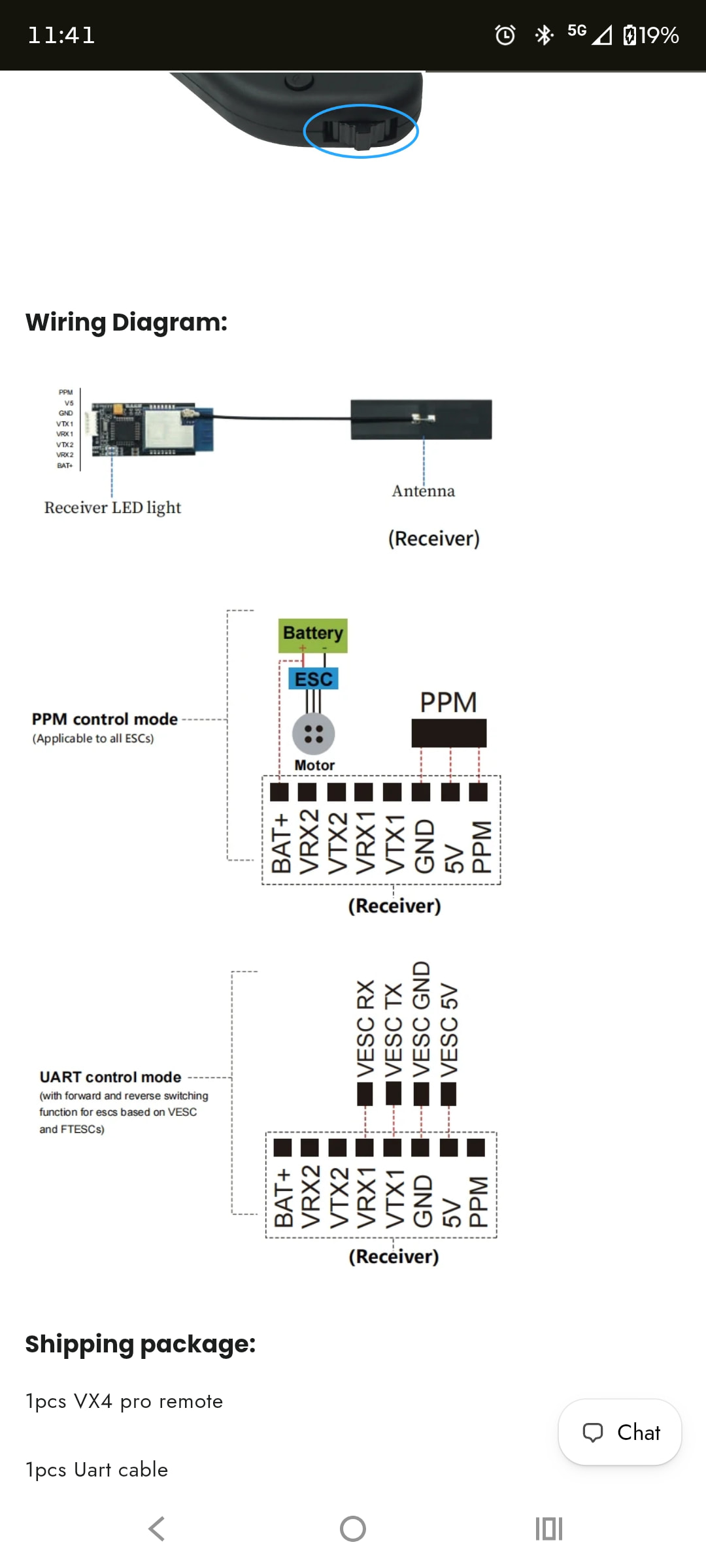

Where does the vx4 take the board battery voltage from? I remember old vx remotes needed a wire soldered directly to pack voltage, but i assume the newer ones get it from the vesc somehow.
What does the vx4 show while the board is charging? Is it possible the vx4 is reading voltage from the charge circuit?
The negative reading on the thermistor may just mean that there is no thermistor connected to that particular port. I vaguely recall being able to turn off individual temp sensors in one of the bms apps but i may be mistaken… its been a while :sweat_smile:
I want to say its opposite, but only in ppm. Pic attached direct from flipsky, i am running uart so i just taped the extra wire up in the enclosure.
I want to say it is an issue as i have never had any issues charging until today, and have had the board for a couple years now. I am just wondering how catastrophic it could be, i have had a gear drive lockup on my faster board and launched me, so at this point im more worried about fire.
On the overkill app im not seeing any way of bypassing the temp sensor, only to change the temp cutoffs which doesnt seem ideal, i will look again just in case.
