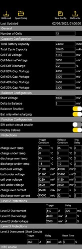

Here are my bms settings. 12s6p P42A
which cells is your pack made of?

p42A
Huh ok Same cells as my 12s8p.

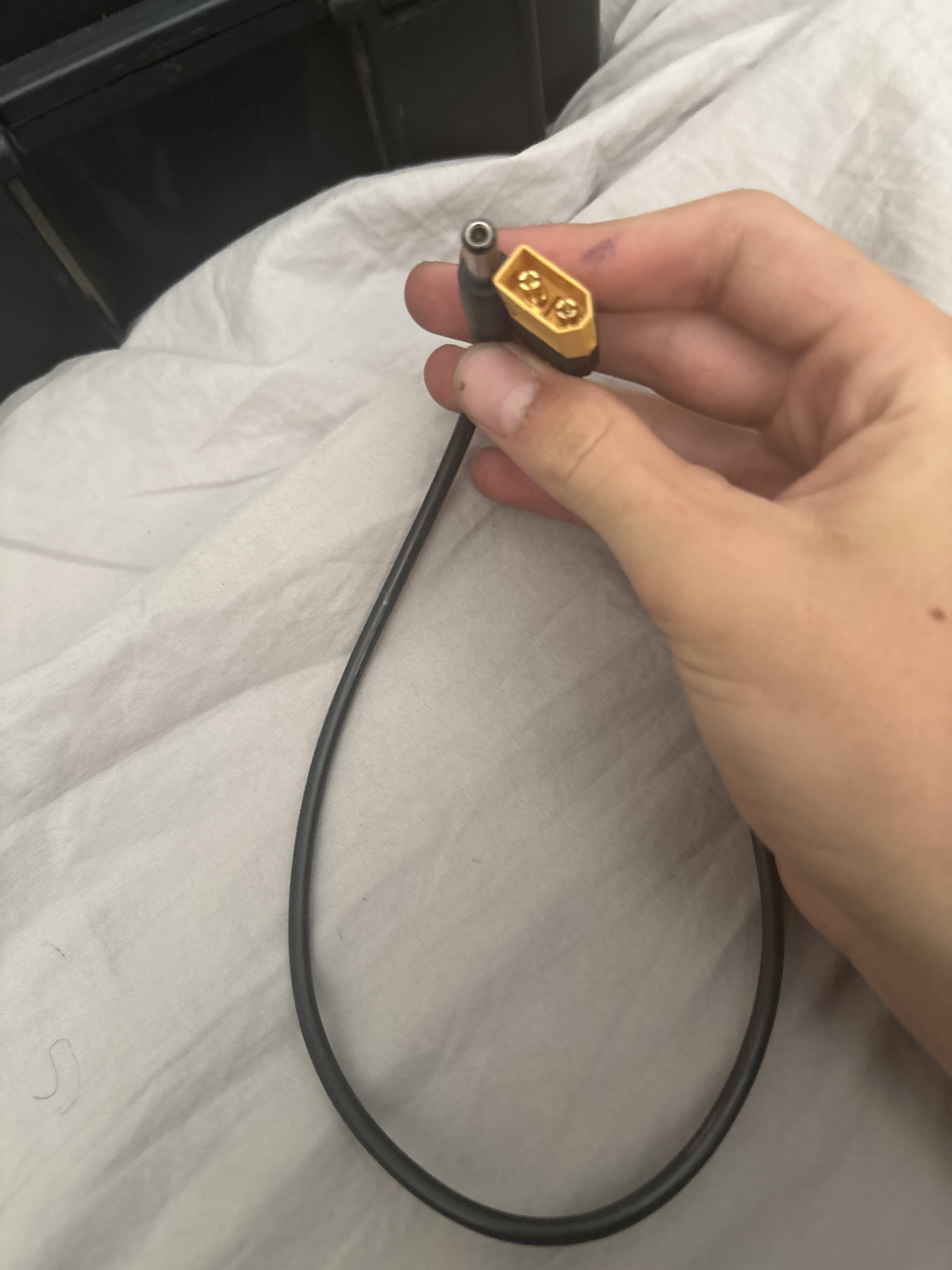

On another note, I just found this adapter, is there any way this thing could work if the jack fit?
That’s an xt60 btw
You should check the polarity but my advice: just get the proper parts for the job.
These might work as proper parts.
The only way you can fully factory reset is with the uart module connected to PC

weird that you have that adapter on hand.
I challenge you to look at your charger’s xt60 and tell me if it fits that adapter. :slight_smile:
:eggplant: :eggplant:
That’s what soldering is for my broskie
