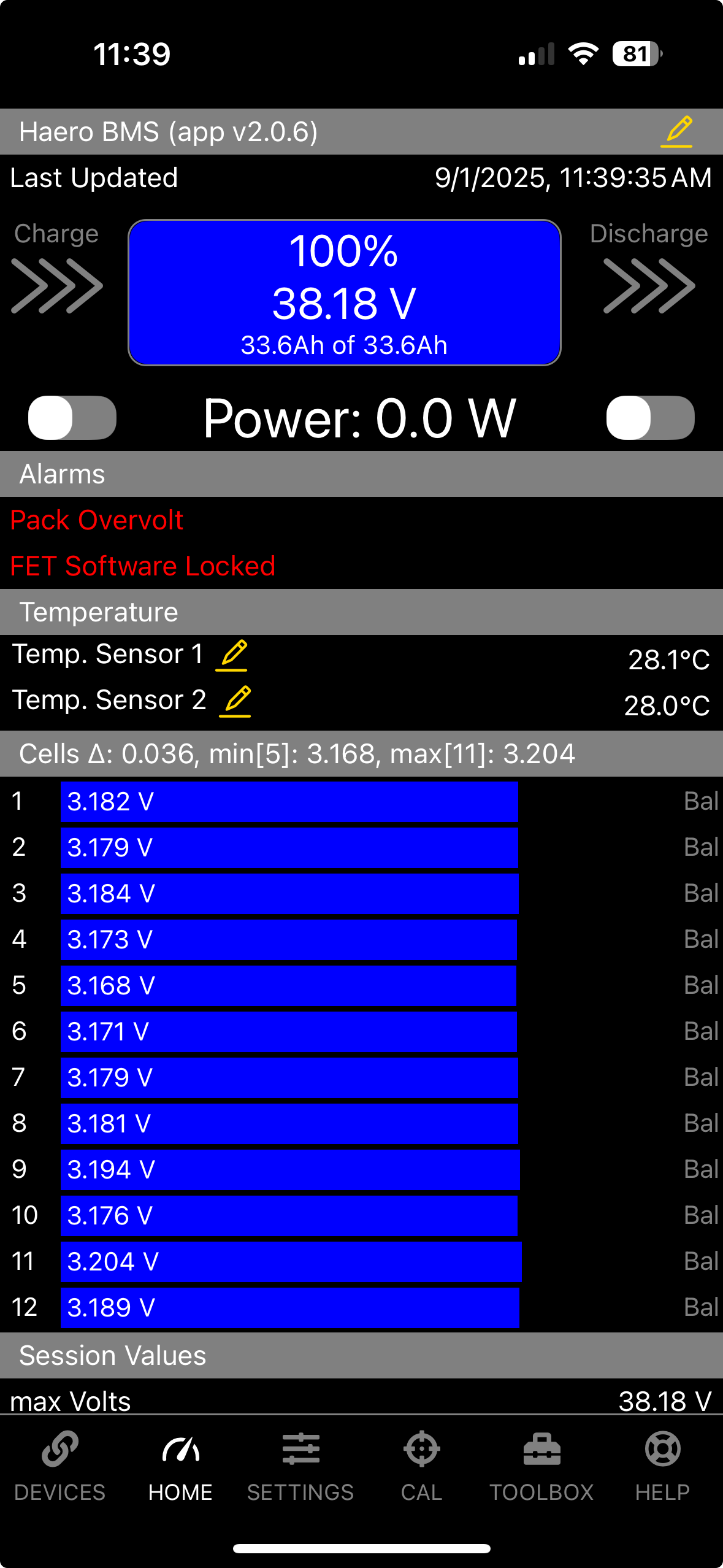

Why does it still show 100% and pack over volt if all the settings are right :thinking:
double check battery over volt setting?
Oh lol I see now

I wouldn’t worry about the percentage, it’s known to be wonky.

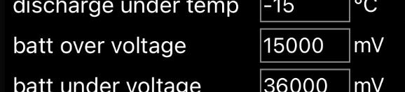

Those bms settings are 100% cooked
Is there a way to reset to default?
The trigger condition is when you want the bms to take action. So for battery overvoltage, you want it set at something like 4250mv. This way, if any cell reaches 4.25v, protections kick in.
The release value is when you want that protection to stop, so for overvoltage protection, i can’t remember what the default is, but you could probably set that at around 4200mv.
Currently your battery overvoltage is set at 15000mv which if the bms didn’t know any better, would let you charge your 4.2v cells to 15v. But i’m 95% certain the bms is ignoring that last 0 and cutting your pack off at 1.5v per cell.
But thats just one value. There’s others there that are cooked as well. Resetting to default liion settings is your best bet

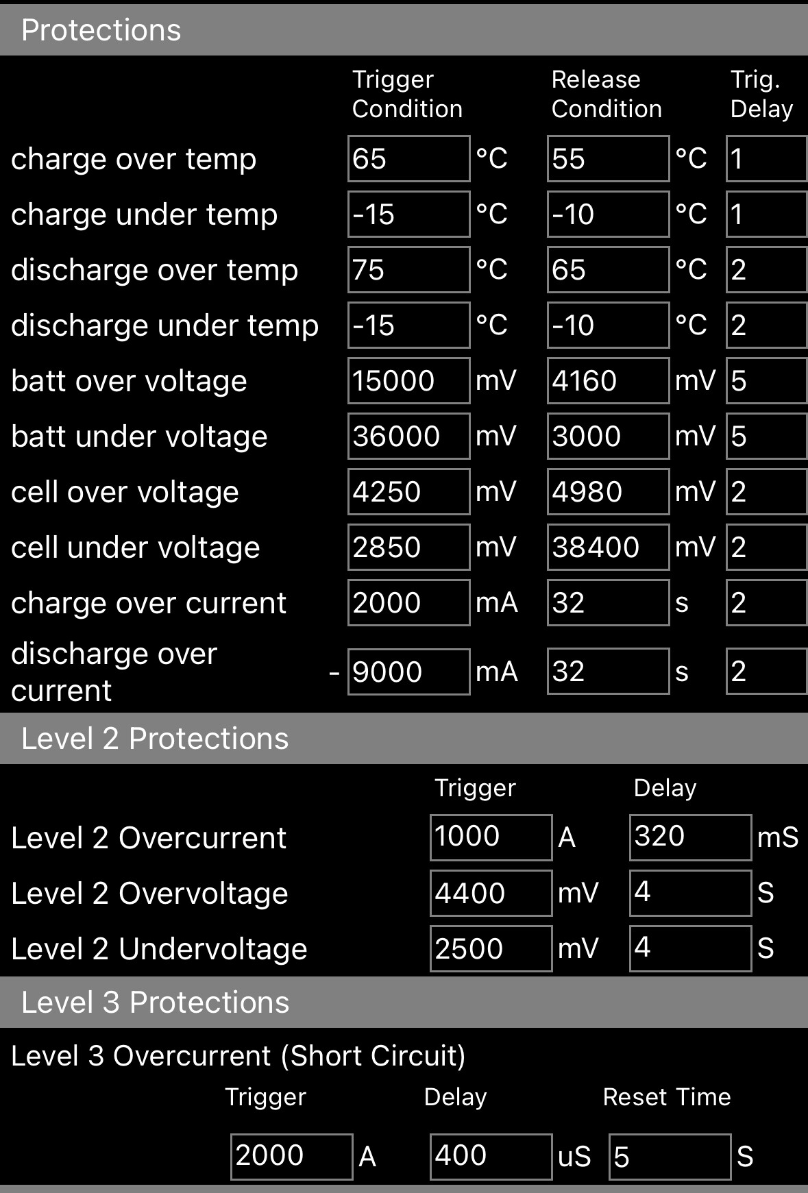

idk a way to do this.
totally agree they are cooked.
But fess showed me how to put more accurate settings in…?
and we need to confirm… ALL the settings… cause those numbers were sketch and make no sense.
and we should probably figure out if we can glitch it again… plug/unplug. idk what else.
So I need to confirm the settings on the battery and figure out how to make the xt60 and jack port compatible.
set it all.
then look it over. and think about wether it seems right.
then take clear screen shots and post it.
wait to see if any of us call it wrong still…
