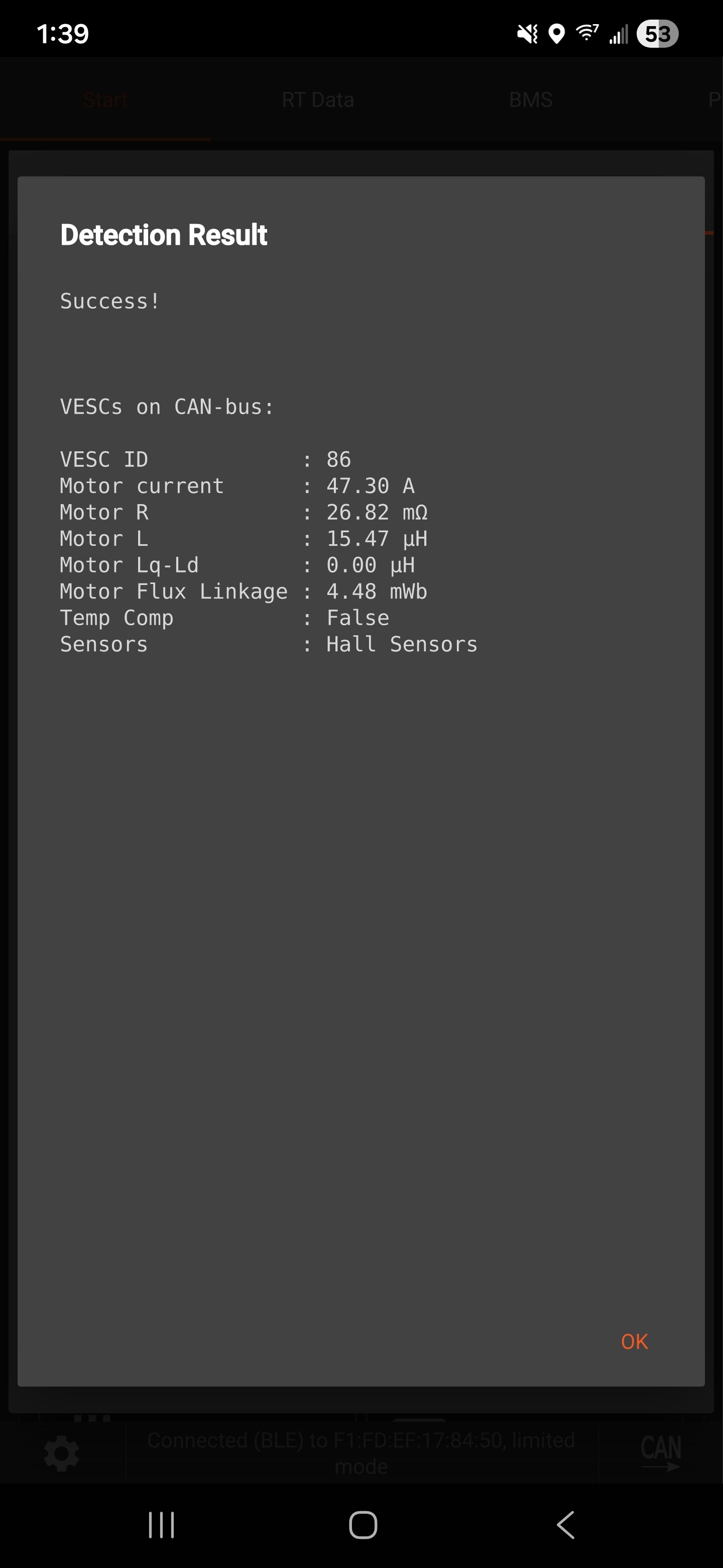

Ran motor detection on a focbox unity. Using hoyt 6361 Burnside motors (10 pole, 180kv).
Only one side of the focbox showed up. However when I continued to set up the battery amps, motor amps, etc…both the local vesc and CAN vesc appear in vesc tool mobile.
I set up a uart remote and both wheels receive current and turn. With that said, for some reason the torque feels weak.
Current settings
Max Motor amps: 68
Max break amps: -68
Battery amps: 60
Regen: -15
When going up a hill it’s very noticeable. Torque isnt just weaker, but it’s almost non-existent and I can’t make it up a moderate incline hill.
Never run into this issue before so looking for some insight. I ran motor detection several more times and still only one side of the esc shows up.

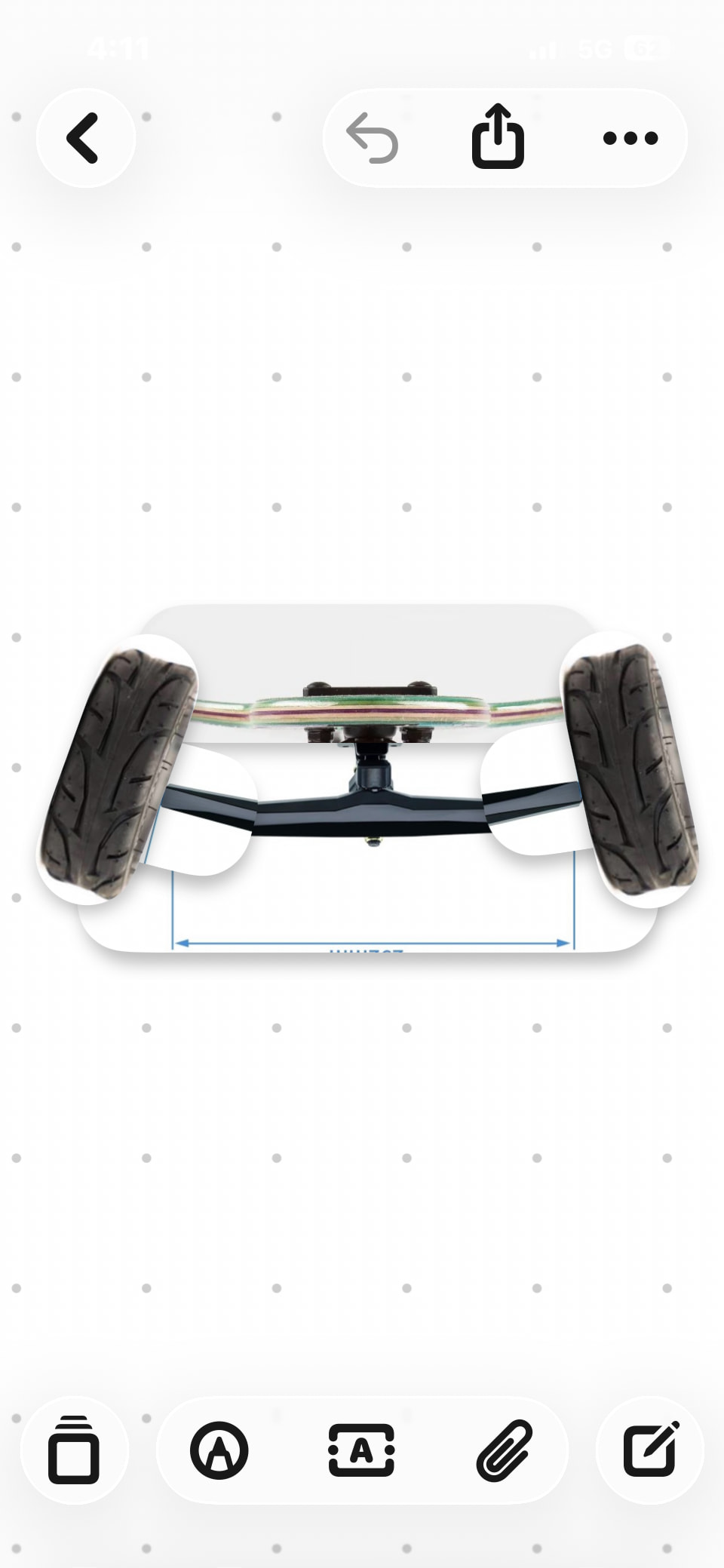

I was thinking this morning at school and was wondering if anybody’s tried camber on a board? I was thinking of prototyping something like this on my printer and if it works actually try it. This is kind what I was thinking. Then you would also be able to mount the motors on the angled truck part so you would have drive train issues. Obviously you would have less camber than this but this is the general idea.
EDIT: I wouldn’t be going much faster on this board than 15mph. It would kinda just be a project show board.
I don’t think the mechanics of a board correlate well to that of a car.
Under cornering, the weight transfers to the outside wheels in a car. Boards are more like bikes, in that the inside gets weighted up the most. I’m not convinced car handling has anything in common with riding a skateboard.
I’ve had cambered wheels due to bent axles. Putting aside drive belt misalignment, the only difference was the inside of the wheels wearing faster.
