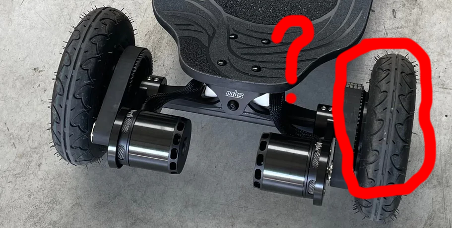

Very noob and quick question: which way should I orient the Hotas tires? I checked the Fluxmotion website but found conflicting info:
Is the orientation of the left tire in the photo correct?
Wild guess, no: it is the right tire that is mounted correctly. In this way, the tip of the “V” that hits the ground first sheds the rain outwards. Is this reasoning correct?
It doesn’t really matter, but I’ve always mounted them like the tire on the right.
