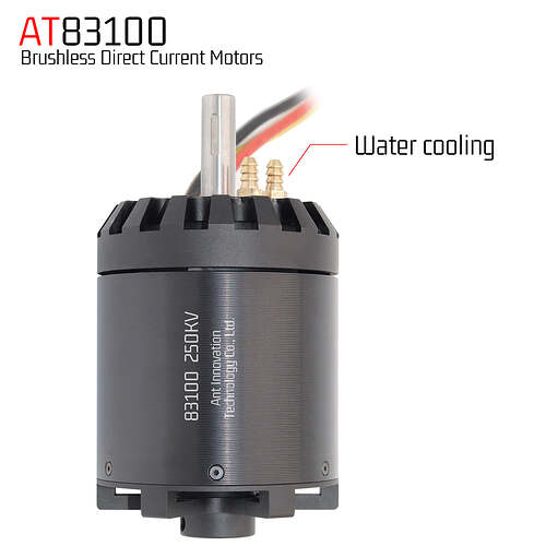

Ant Innovation AT 83100 9.5kw Brushless Motor with Watercooling System
The new design 83100 Brushless Motor with Watercooling System for Electric Jetboard. The stator is made of 0.15 Kawasaki silicon steel by special process. Improve power and torque. Reduce heat generation. The efficiency is greatly…
Price: USD 229.90

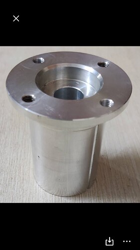

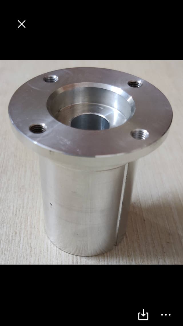

They’ll sell u the motor in parts and u can skip the Watercooling hub. Replace it with another hub. I have a hub version u can get made w giant bearings and good thermal mass.
This is the best motor available in this size with this nice lams.
I got three in parts. U want to use it on a board or what?
It shrinks the length down considerably if you swap out the hub n Watercooling tubing.
