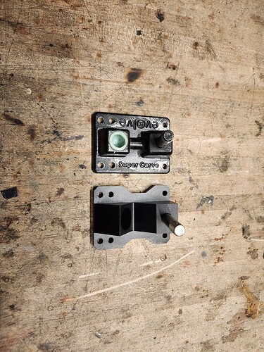

But for now Andrew sent these clamps from sendcutsend.
And I will use them with BN Plates.

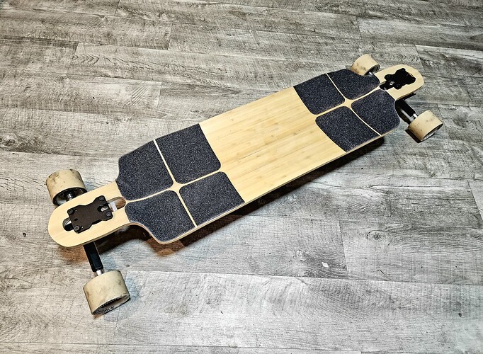

Got the updated @IDEA mounting rings yesterday and slid them on a set of hangers. Perfect fit. Great job Tom! Looking forward to swapping these onto my Demonseed this weekend
Just got mine. Amazing work Andrew! They fit perfectly and look really nice with idea mounts.
What is the width of the hanger and can I run them in a TKP configuration? I was thinking about changing out just the front truck of the Meepo Voyager to help with carving.

I started setting up my trucks last night.
I will get to push them around analog a bit later this afternoon.
I’m having a hard time getting over to my father in law’s to drill out the adapter clamps.
But soon…
Now I know these two things are not the same…
But it’s what I had to compare to…
Damn it! I need to give these a go!
Those are some really long axles.
Any plans to make longer hangers?
