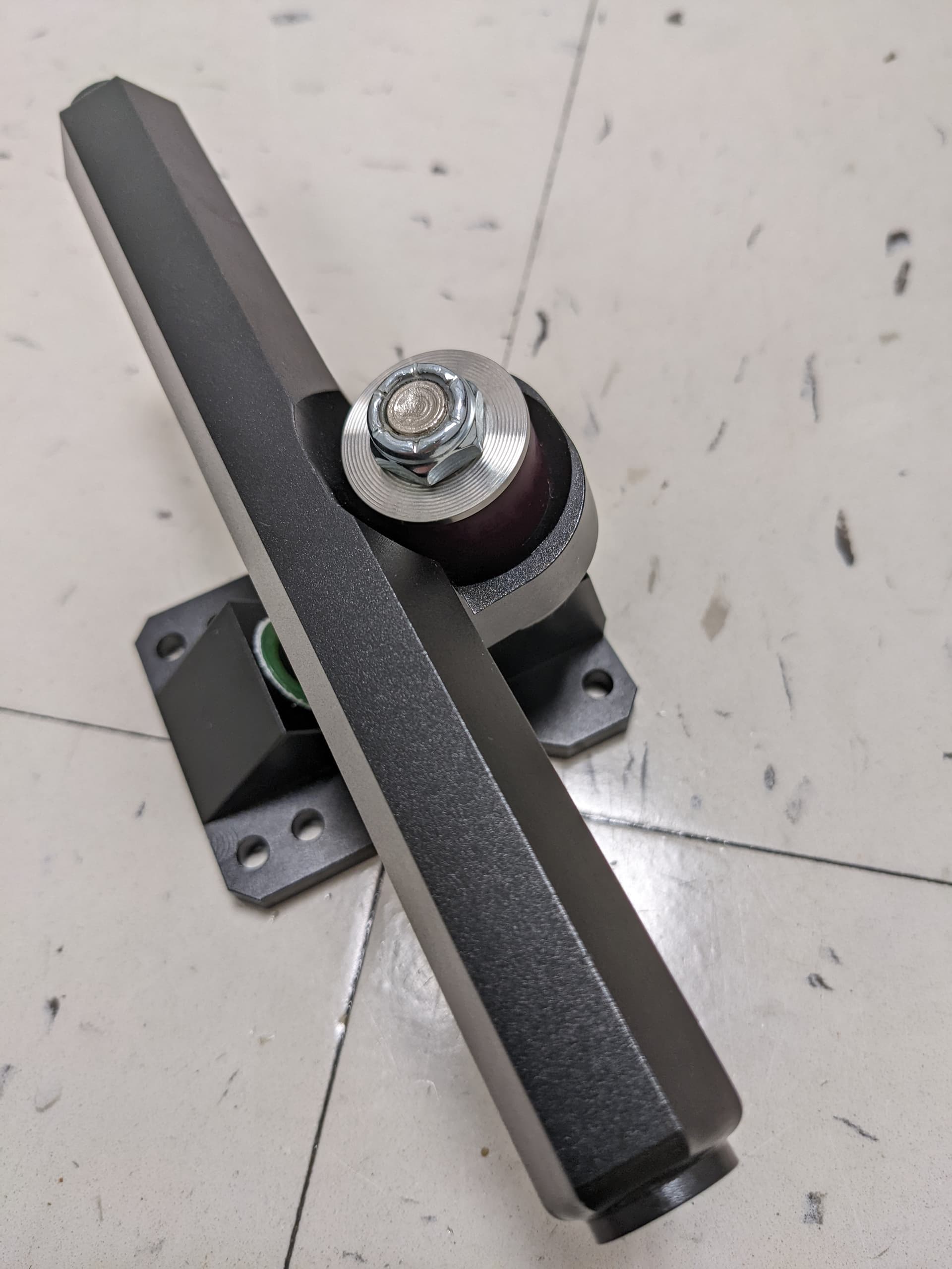

I have no real plans to become a vendor so wasn’t planning on offering up any other hanger lengths. But they should fit the Savage tkp hangers

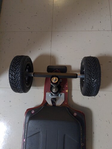

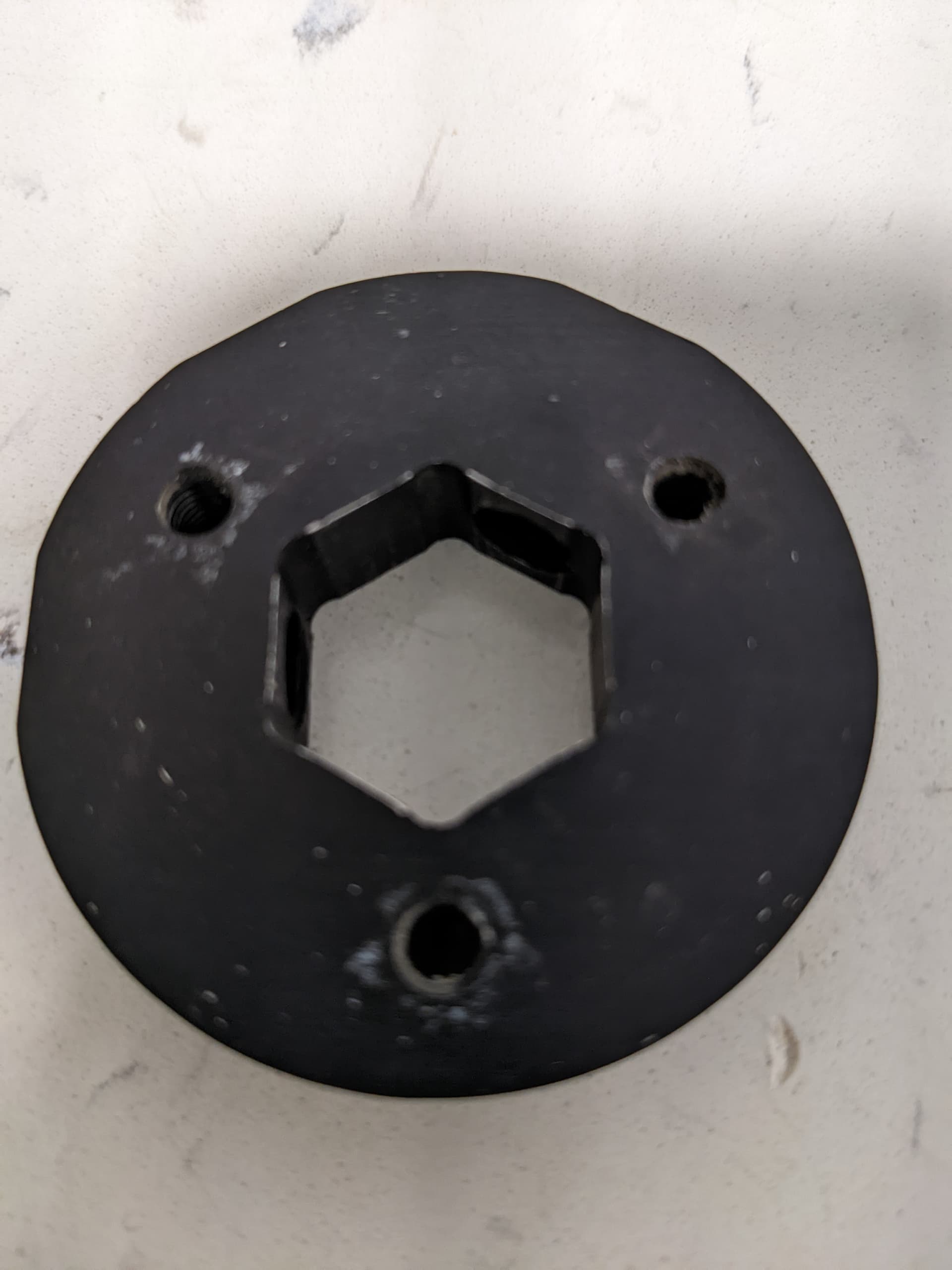

Just got done swapping out the trucks on the Evil Demonseed which used the SR motor mounts from @IDEA. I had to run a file across the insides of the mounts til bare aluminum was showing and sharpen out the corners.
SR hangers have all the edges camfered so the mounts have rounded cornering to match. My hangers aren’t camfered so that rounding had to be “sharpened” to match. I’ll upload some pics when I get a minute.
Clamp on mounts seem to fit on without any tampering. Whooshboards and a few others used to make some. I’m using custom clamps on another build as well.

How difficult/expensive would it be to have the edges chamfered on the hangers? It would be nice to have hangers fit with no modification.
I can modify the mounting rings to fit your hangers, it’s not a problem.
Ooooofff, right in the feels. They look awesome dude!
Awesome! I’ll dm you a mechanical drawing with dimensions when I get a minute.

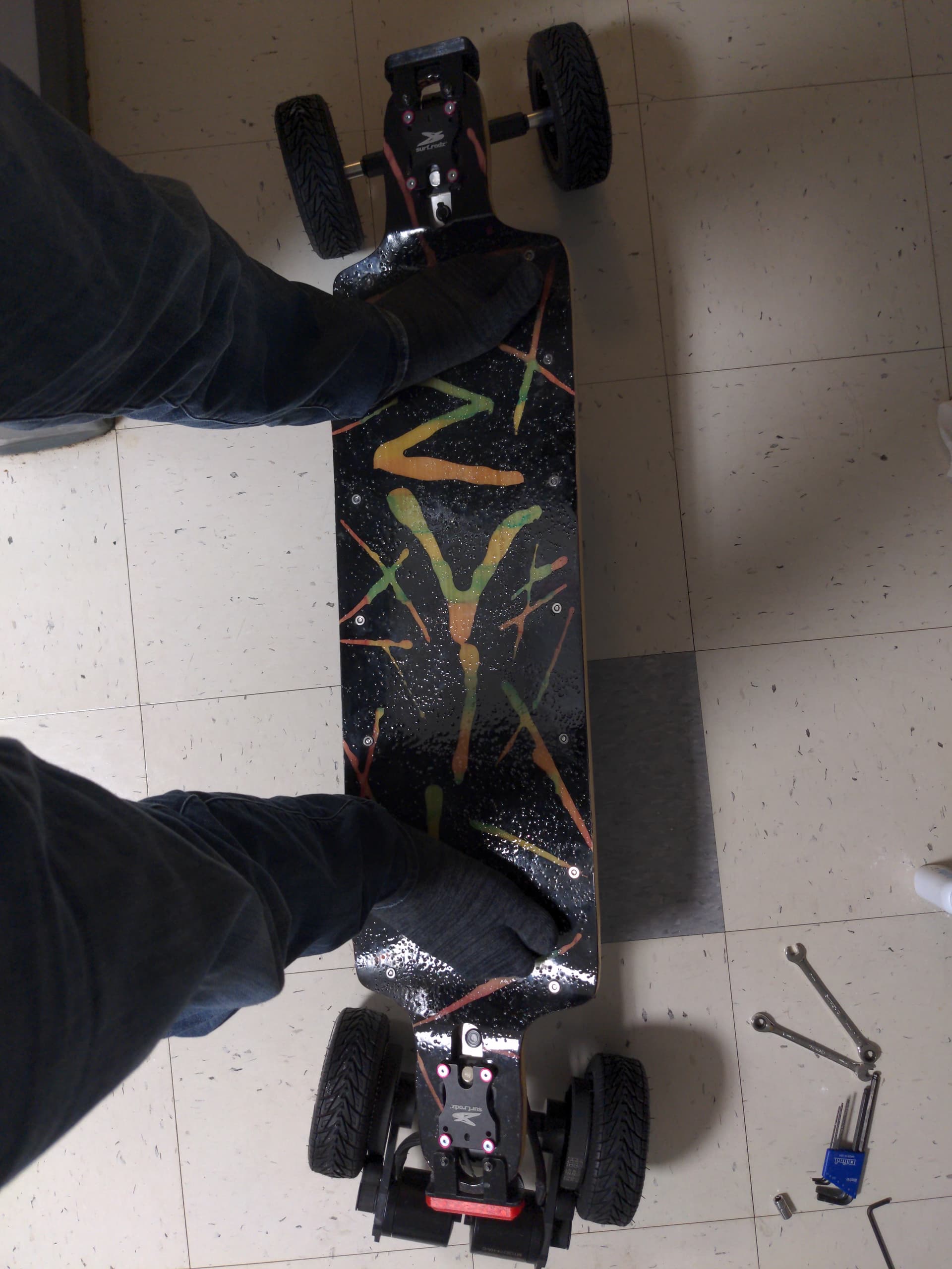

Used the truck swap as an excuse to throw on the BKB 6" tires. We’ll see how they handle massive carving on flipsky rims.
I think you are going to be pleasantly surprised. I love mine for tighter turns.
One thing that can sometimes happen with DKPs is they can get a bit squirrely with typical pneumatic tires. The larger contact patch and more predictable grip of the BKB tires really compliments DKPs well. This is currently my favorite 6" tire. The only wait to improve on it is to get rid of the tread and make the rubber slightly softer.

Trucks felt good across the crappy streets, wood slat bridges, and smooth pavements. I am thinking I’ll be dropping the bushing duro down a notch to make things a bit looser, but it will be a little more riding before I decide for certain, because about 1.5 miles in the right motor mount came loose.
Stopped, tightened it down and started to head back at a slower (this really sucks) speed. About 1/2 way back I had to stop and tighten the mount down again. Eventually made it home, only got in 3.5miles with a top speed of 18mph. Aside from the mount, the ride felt great. At no point did I feel uncomfortable and it took a shit ton of will power not to open it up on the ride out.
Not sure what’s up with that mount, but I’ll clean the grub screws, realign and red loctite it again. Hopefully give it another go this weekend.
