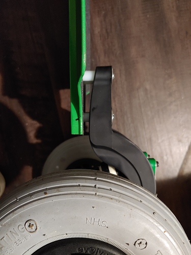

I built it up with the deck intact, it was comically tall with the 8in tires DKPs. So I went for the gusto with the saw and DD brackets.
The deck is stiff as hell, brackets are designed to, and do, flex. Its an interesting feel just jouncing my weight on the board. I think this combo will soak up bumps quite well. I’m fully aware of the weakness of DKP at speed, but have tamed it with the hydraulic damper successfully on the other Evolve board… Stable at 27mph, which is plenty for me. The motors are only secured by 2 screws until the DickyHo 63mm plates arrive, so I’m not so eager for a test ride yet. No room on the Evolve motor plates, with 63mm motors, for the stabilizer stud, so that has to wait for the new plates too. Bat is a used no-bms 10S 10Ah Lipo from a carbon GT. I hioe gets me at least 10mi. (

The adjustment range is indeed +/- 15deg, so no go as a way to mount channel trucks unless you’re adding 15deg some other way. If you took advantage of the 7deg angle on the bottom of the mount plate, and added 7deg wedges, that gets you another 15deg, but 15deg is a LOT of angle on the fasteners… So long as you’re using washers ground at the appropriate angle (so the seats of all fasteners are square,) have ovaled out the holes in the deck to allow this much skew, it should physically work, but would be super sketchy.

Okay, I could only find 1in nylon spacers locally, and gawd awful ungraded screws, so this isn’t final. I’ll end up ordering 1/2 OD x 3/4 long x .194 ID (for #10-32 screws) spacers and using alloy steel 10-32 x 2in socket head cap screws. The 1in OD stainless fender washers worked great. I’ll find a way to blacken them and use them instead of a plate on top.
I will scrape the enclosure over speed bumps like this, and maybe even in a sharp turn if I hit a bump. Adding 1/4in by using the shorter spacers would be as low as I’d ever want to go. This may be fun for smooth paths, may be too low.

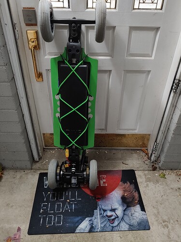

Well, I “finished” it, took it for a brief shakedown skate around my neighborhood. Since last photos I installed thr DickyHo 63mm plates, (I drilled and tapped an M6 threaded hole for the stabilizer in one) cross plate and a much lighter solution for the top stabilizer mount. I’m using a 60mm + 30mm M8 socket head screws + a coupler nut, 2x 608 bearings and a pair of aluminum 7/8in (22mm) handlebar clamps. The battery case hides an ugly & tired 10S1P carbon GT pack, 35A dumb BMS and a flipsky anti-spark switch. The gray ESC box is a plastic outdoor outlet cover + a painted steel blank cover plate. (The idea was to use it as a secondaet heatsink… The Heatsink on the bottom of the ESC sits on it.) I’m using a VX2 remote + receiver, flipsky’s cheapie BLE adapter. Phase wires need to be tidied and secured, but I’m pretty happy with the way it looks and skates. The brackets soak up bumps nicely, it carves quite easily. I was skating by flashlight in 40deg weather, topped out at around 18mph. Runs 27mph on the bench with 200mm tires, 12/66t pulleys, 190kv motors. Questions? Comments?
