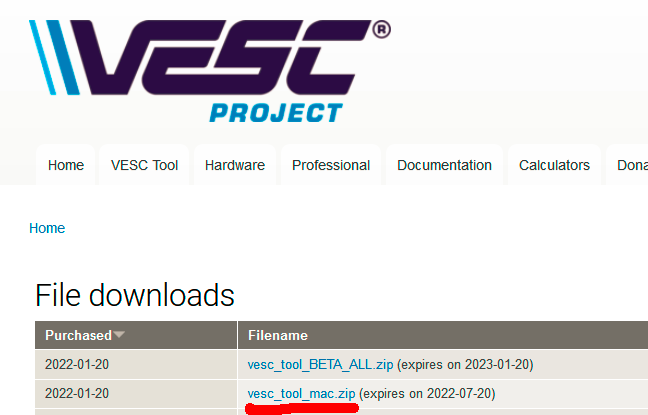

Jeffrey compiled the Mac version. To drop this into your purchased files container, you need to visit this page and complete a checkout again.
https://vesc-project.com/vesc_tool
This will also make the BETA available under purchased files .
