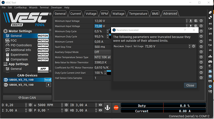

i have 2 others questions ,
the first one is the maximum input voltage limit and i don’t know i why but i can’t set it to higher value then 72v and my battery voltage is 75.6 at full charge
and my last question for today :laughing: is it possible to get some brake regen if lost remote signal or if my battery cut ? i don’t remember the name of this option at the time i was on ackmaniac , but its very useful if can stop on hill or just imagine losing it a 40mph no brake at all is scary me
Because 67V input is about the max for a 75/300 and probably also the UBOX. You always need headroom for voltage spikes! So at 72V the voltage protection is triggered.
16S LiIon is the max for those devices.
my ubox is v2 75v 100A J version with 100v mosfet maybe spintend forget to tell me to change firmware
Mosfet is one thing, shunt amplifiers and voltage regulators also have limits. The component with the lowest limit is the one that sets the safe voltage limit.
Typically you try to avoid 100V Fets in 75V devices, because the 100V FETs have a way higher internal resistance and perform less good (produce more heat).
i contact spintend and they send me a special firmware for it
