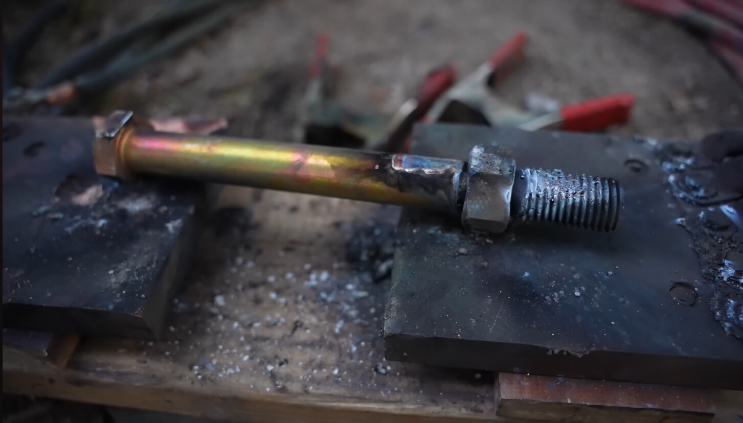

My VESC was fine the soot I was talking about was just on the plugs. Here is an extreme example from Styropyro on YouTube it’s the only example of the stuff I can think of. That’s a nut and bolt across 60v of car batteries but that messy black stuff is holding it off. That assembly was copper coloured.
(I can already hear “ye I don’t want that in my esk8”)
