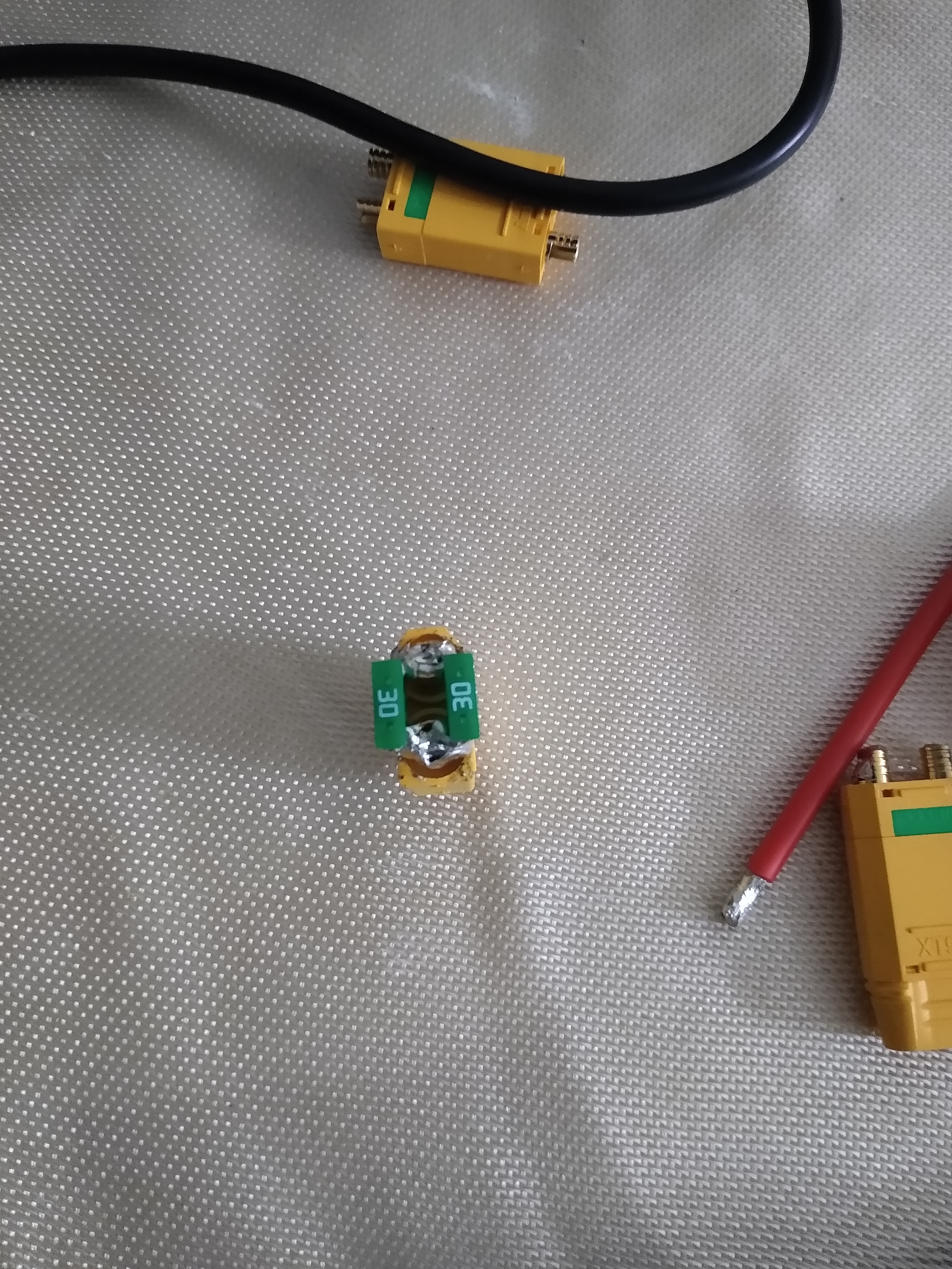

I couldn’t fit a fuse holder in a zboard 2’s enclosure so…

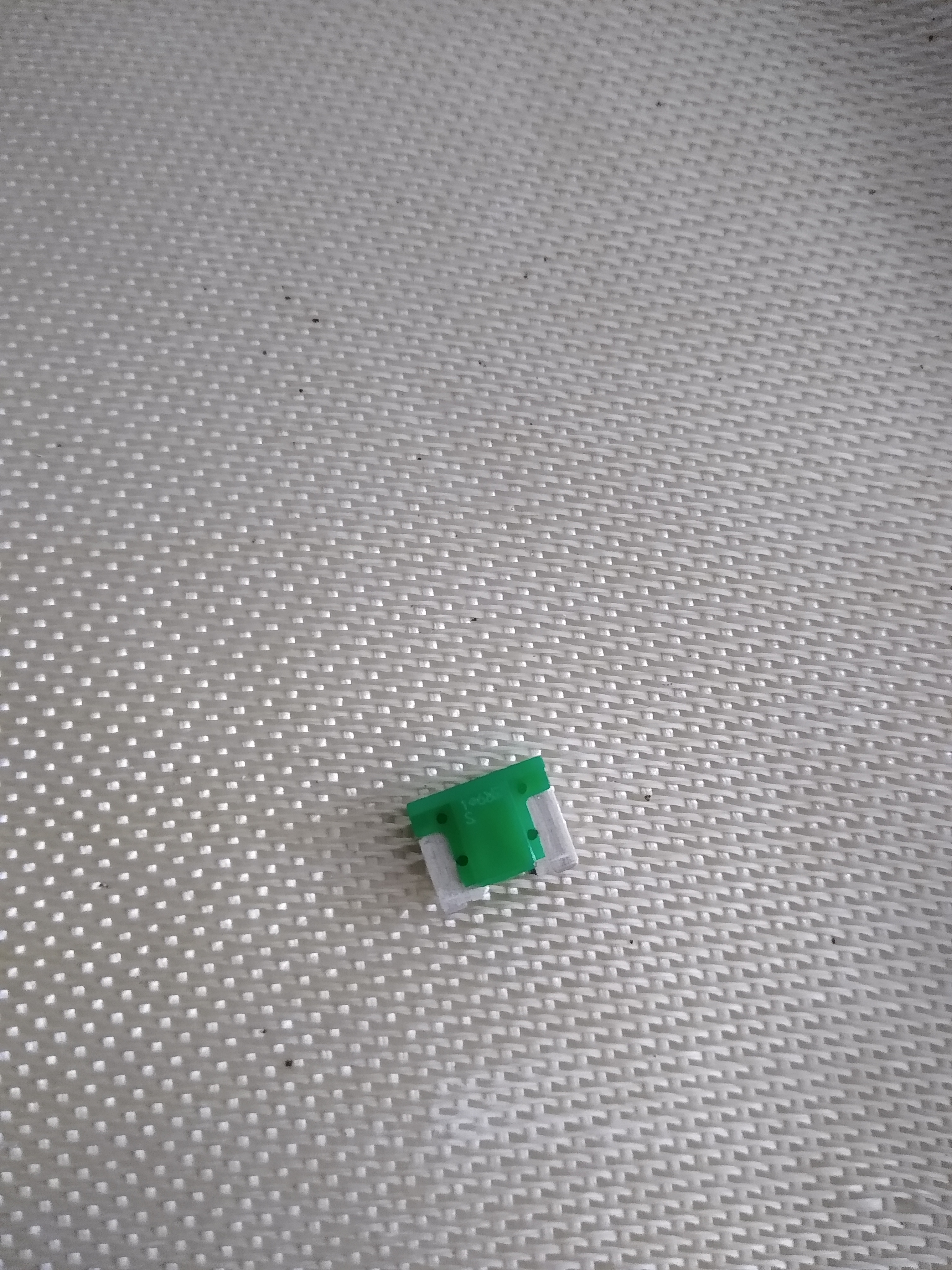

I soldered two of these little 30A fuses in parallel to a XT90S. They will be coated in liquid electric tape to prevent water getting into the fuses. In theory you could do this for a reasonable powerful board with with larger 80A blade fuses, but I intend to use a fuse holder on my from scratch build.
The zboard 2 blue I’m converting isn’t exactly high power. Max battery amps will be set to 25A. Hopefully that gives me enough head room so the fuse won’t kill me. It still has the original battery 10s originally 6.6ah battery using god knows what cells 2p or 3p (I plan to replace it).

Not only do I not recommend fusing the loop key at all, but connecting fuses in parallel is not simply doubling their rating.
The best case scenario is that nothing happens and the fuses never blow — the worst case scenario is a fuse gets melty which forces more current though the other fuse, which melts that one, which causes both of them to blow.
And then you’ve achieved what you’ve set out to do: cut your own brakes at some random moment in time.         wait, what? you really want to do that?

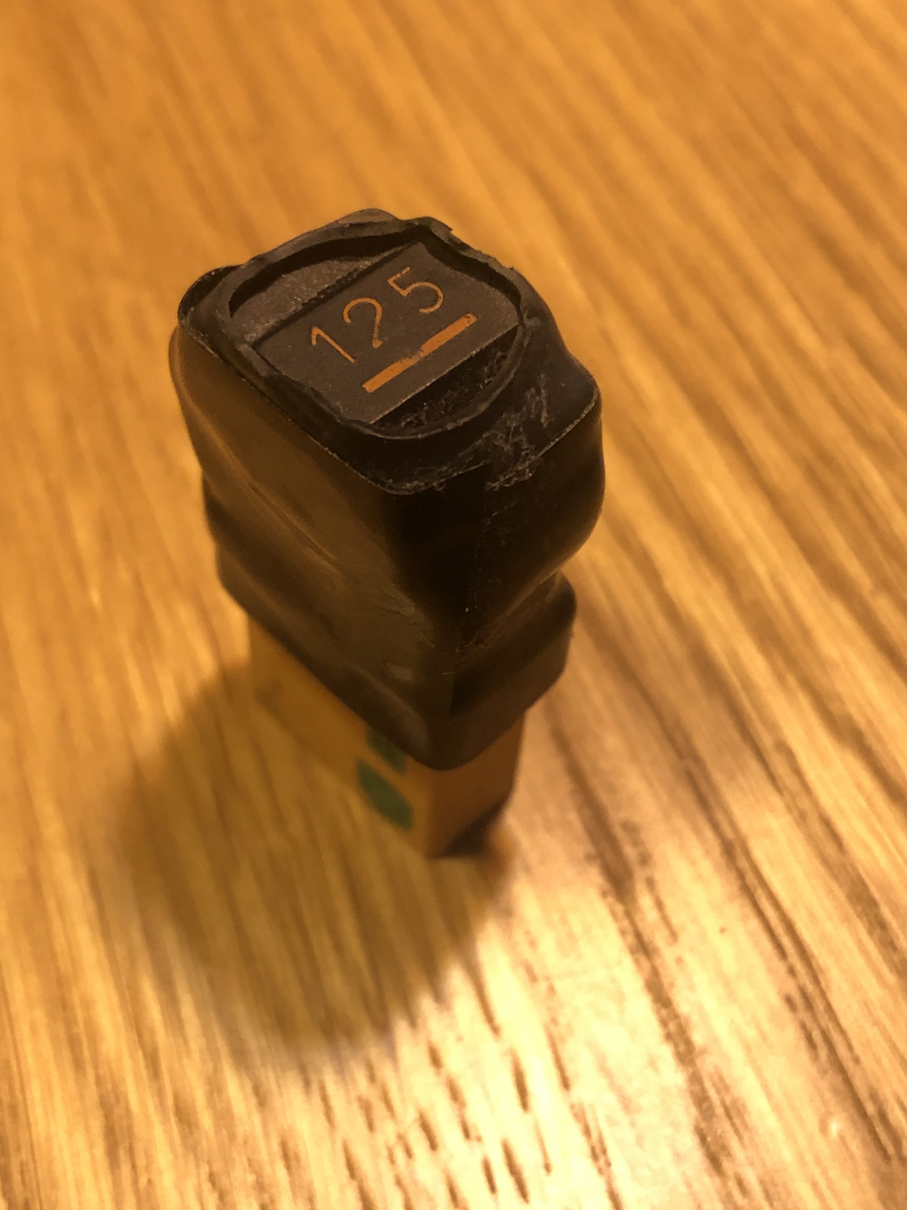

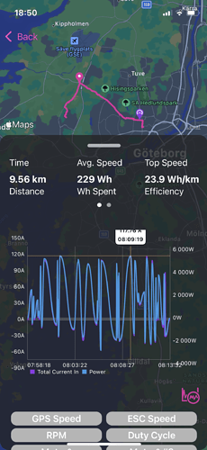

I have a 125A loopkey fuse and I hit close to 120A frequently on my route to work. Has held up for more than a year.( Yes the tolerance is a bit small and I should do something about it):shushing_face:

I’m aware of the limitations of placing fuses in parallel. I understand it to be not as simple as the oft quoted don’t place fuses in parallel. The limitations come from using different fuses, manufacturing differences between fuses of the same model, and the by products of non symmetric circuits. All of this means the rating of two of the same model fuse in parallel will be less sum of both ratings and significantly more than each fuse’s rating. Am I missing something?
In this case my circuit is nearly symmetric (slight difference due to soldering), both fuses are rated at 30A, standard blow, the max continuous rating of each fuse is 5A more than the expected max continuous load on the entire circuit. I only feel comfortable doubling my expected load because the math says my battery pack even in the worst case (if it was composed of high capacity, high internal resistance cells in 10s2p) would still produce an astronomical amount of current when shorted blowing the fuse before thermal runaway (see fuse datasheet on mouser).
I could be convinced to use one of the larger 80A fuses I have on hand, or that I calculated the short circuit current wrong and need to use a smaller fuse. The thing I am most worried about is using the wrong range of numbers for the time required for a shorted cell to begin thermal runaway. Hard to find good data for this, and it’s an influential variable in my calculation.

Can someone show me a log where breaking produces more than continuous max battery amps? That would be pretty convincing.
