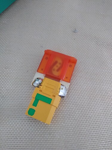

Also your solder looks cold.
Yeah, that’s my primary worry did I calculate a shorted amps wrong. If my calculation is to high, and my fuse won’t blow in the event of a short that’d be terrible. I’m less trying to protect my esc than my house from thermal runaway.
Thanks, I’ll make a new one, and set my iron hotter.

Just search fusing, you’ll see plenty of arguments in previous threads. I’m not really all that interested in continuing to argue about the if fusing is a good or bad idea. I’m very interested in people critiquing this method of fusing versus it’s alternatives (e.g. a fuse box, are there any others?).
seems more work than needed, no? I’m also against fusing, but if you wanna do it, just get a nice fuse holder. Less hassle to change if you blew one and survived to tell the story, also less risk of getting bad contact.

My suggestion is that if you’re going to use a fuse, that you use a single fuse with the proper rating and not try to parallel them. And if you do that, then it would be a good way to fuse. If you were going to fuse.

I urge you to use a single fuse, not soldered to, and to check the Current vs Time (I2T) graph for the fuse. It will tell you what rating you need for the current flow you are expecting.
Be sure to also check the rerating/derating graph in order to adjust the fuse’s current rating for a higher ambient temperature. It can be a lot warmer inside a sealed enclosure, with warm cells and hot electronics, especially in Summer. That causes a fuse to blow sooner and/or at a lower current level.

I read the datasheet of each fuse when I was purchasing them. I selected based on expected current, and short circuit current (calculated from a range of possible (high capacity vs high discharge) internal resistance value’s in the possible series parallel configurations).
Here’s take two with a single 40A fuse. Unfortunately soldering is required, since I can’t fit a fuse holder in this enclosure.
