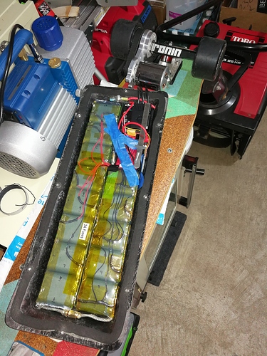

Do you have pics of your battery builds/wiring harnesses floating around?
Also, measuring continuity aside, is ther any visual indicator to tell if they’ve popped? Is the one convenient thing I like about other types
Pics, let me see if I can dig some up.
This shows (kinda) balance lead fuses. You can see where the balance leads have the thick heatshrink right where they attach to the groups. It’s marine double wall self adhesive shrink. I know the balance leads are not well organized in this pack :slight_smile: But they generally don’t cross over, and where they do there’s the same thick heatshrink.
I think there’s a charge port fuse under the tape somewhere… I’ll try to find a better photo.
There’s other weird things in that pack. There’s a break in the middle so I can charge the subpacks on a hobby charger (I made a JST breakout board. And I have a nice hobby charger). There’s a LittelFuse Midi inline on the discharge wire. AS150 for antispark, with a 3d printed housing to hold it in place. Some crazy looking AMASS 8mm and 6.5mm stubby high current bullets. 13s3p VTC5a (75a discharge).

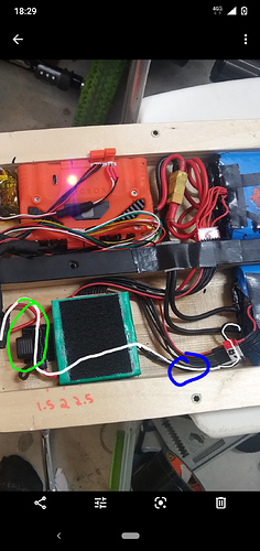

Not the best, but check out this picture.
Green is “before BMS”
Blue is “after BMS”
White is the negative charge wire I tapped off of negative mains
Larger black wires are negative mains to ESC
As you can see, I fused before BMS (bypassed, charge only) but I’m actually pretty sure it’s better to fuse after BMS with the cheap shit we use. Closer to the battery is always ideal for fusing - moreso in the case of us imaging the BMS throws the reason for our fuse to pop. If we really wanted to protect our battery and BMS - fuse before and after.
I also know just about nobody here does it, but fusing your positive mains to ESC is also a really good idea. Closest to battery as possible. Most not-tedious and esk8 way I can think of would be to use midi style fuse w/hydraulic crimped ($30 for crimper on Amazon, useful thing to have in general) marine grade lugs. Little bulky, but that would definitely solve a large bit of esk8 fires…
Post a pic of the battery and wiring if you need more clarification

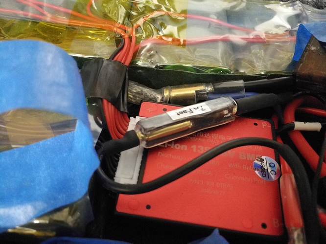

Lol in my brain I was supposed to take detailed photos of the fuse in place, doh! Anyway, here are the not-requested-photos…
Simple 10A axial fuse. Super tiny. The connector is XT30 and the wire is 20AWG to give you a perspective on the size.
