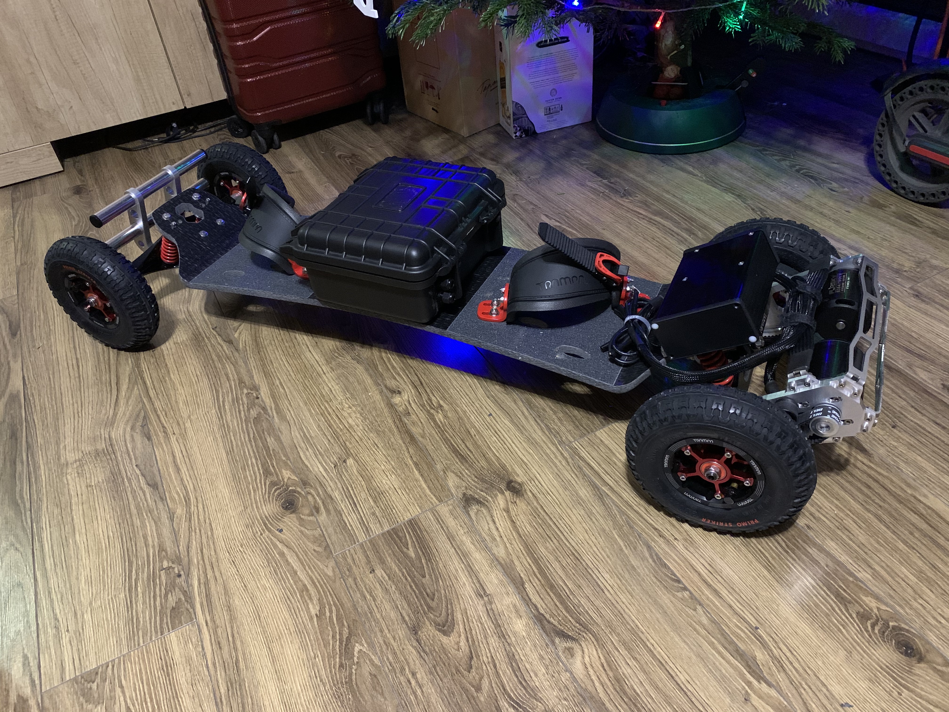

Project is moving forward, thanks to kindness of @IDEA got my board and few other things. Now its time to put this together what I already know will not be as easy as I thought :slight_smile:

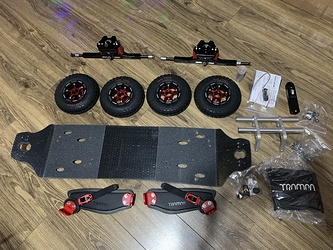

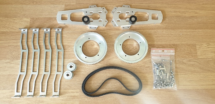

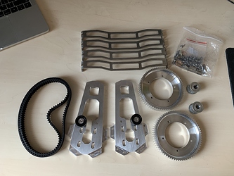

First mounting setup has arrived:

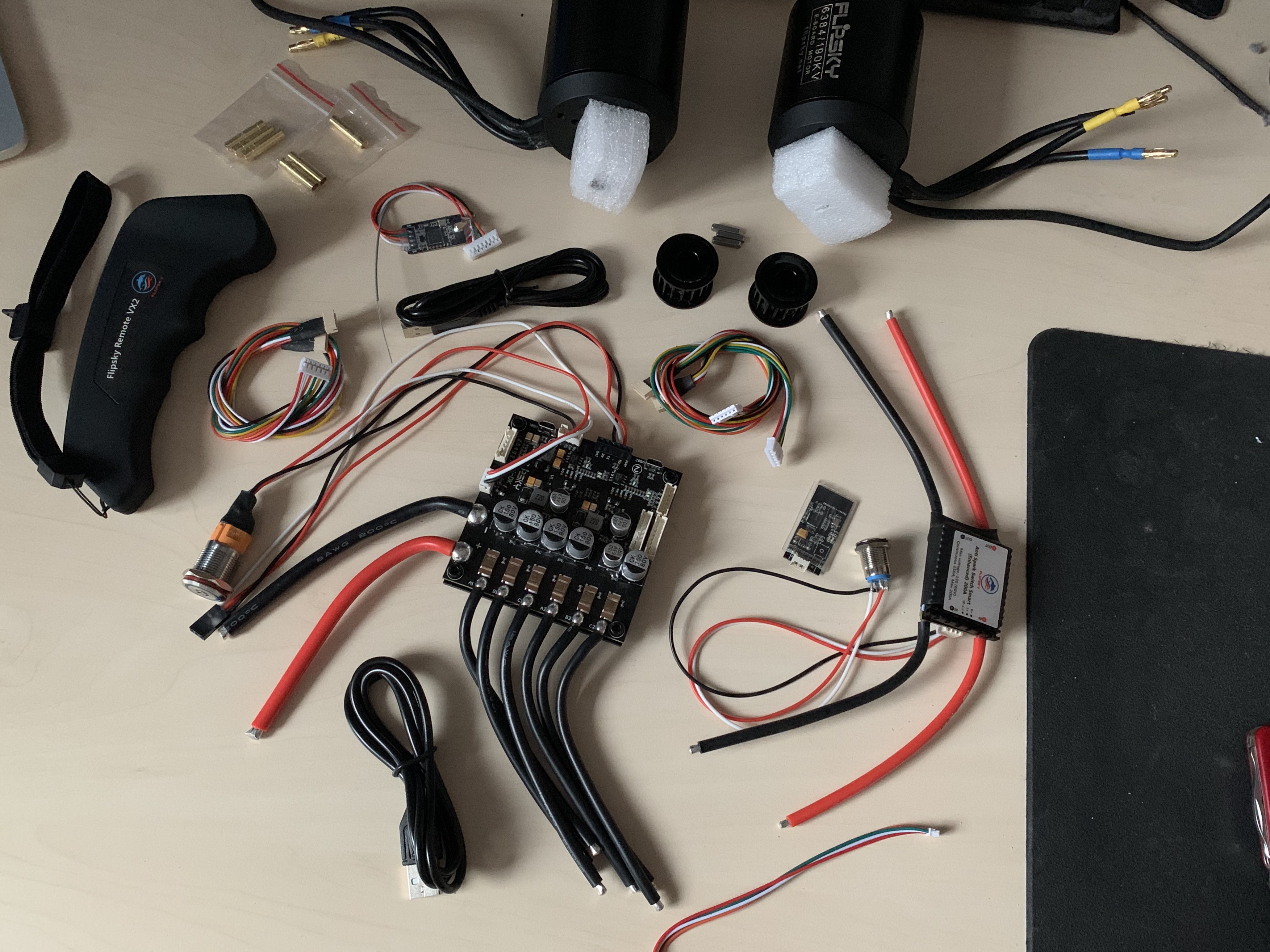

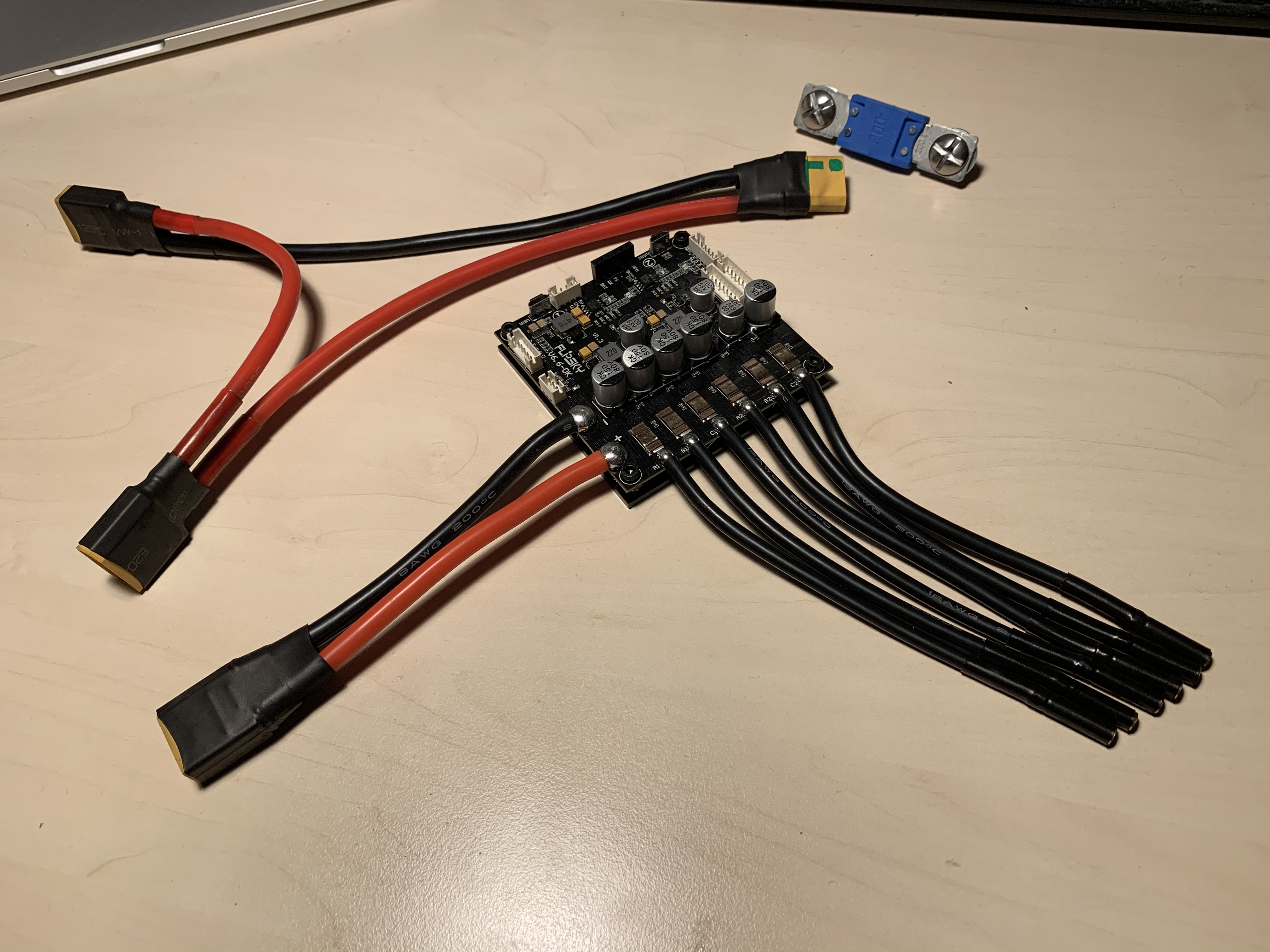

Later on I got package from Flipsky (ESC, motors, some other parts):

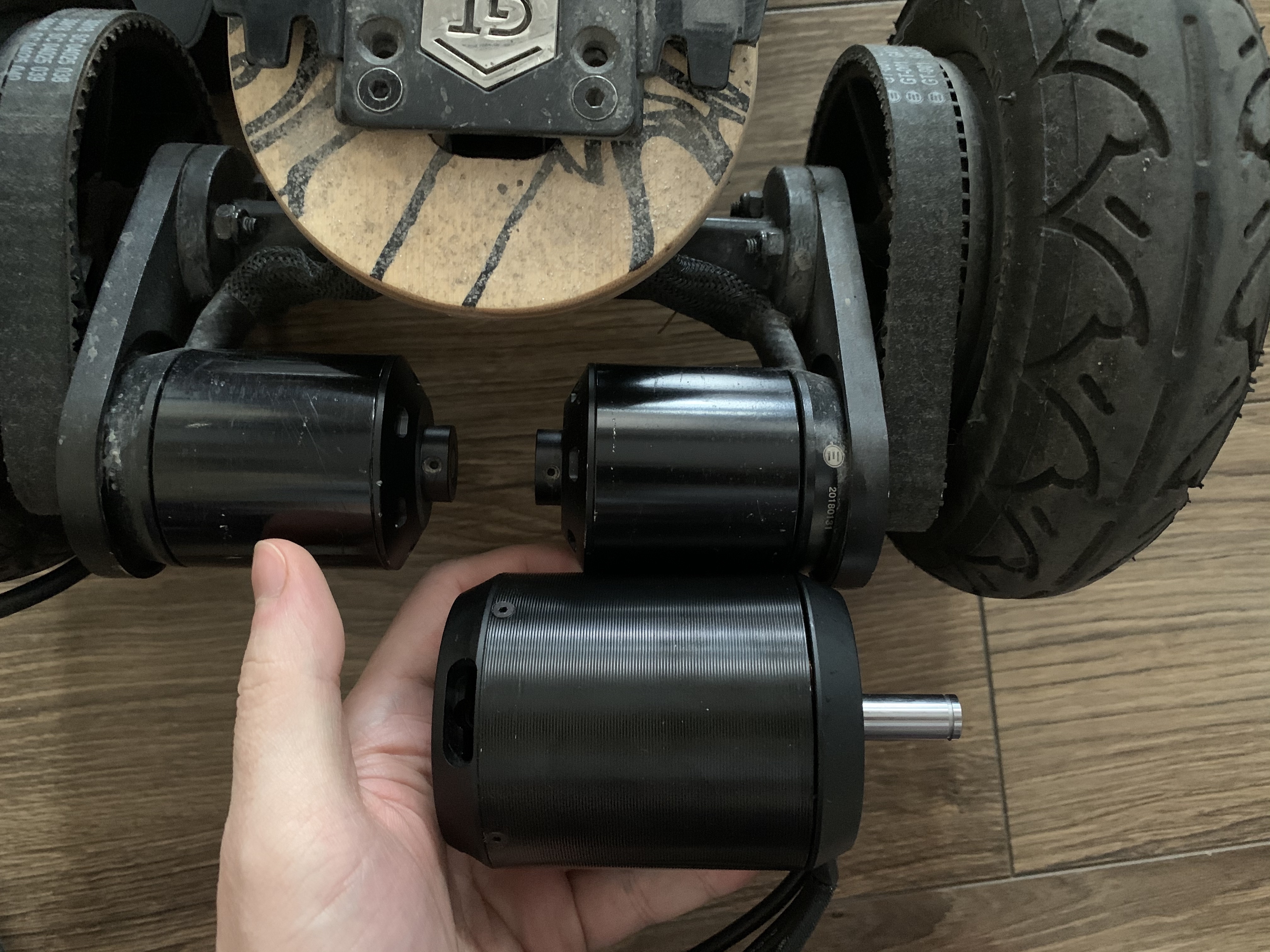

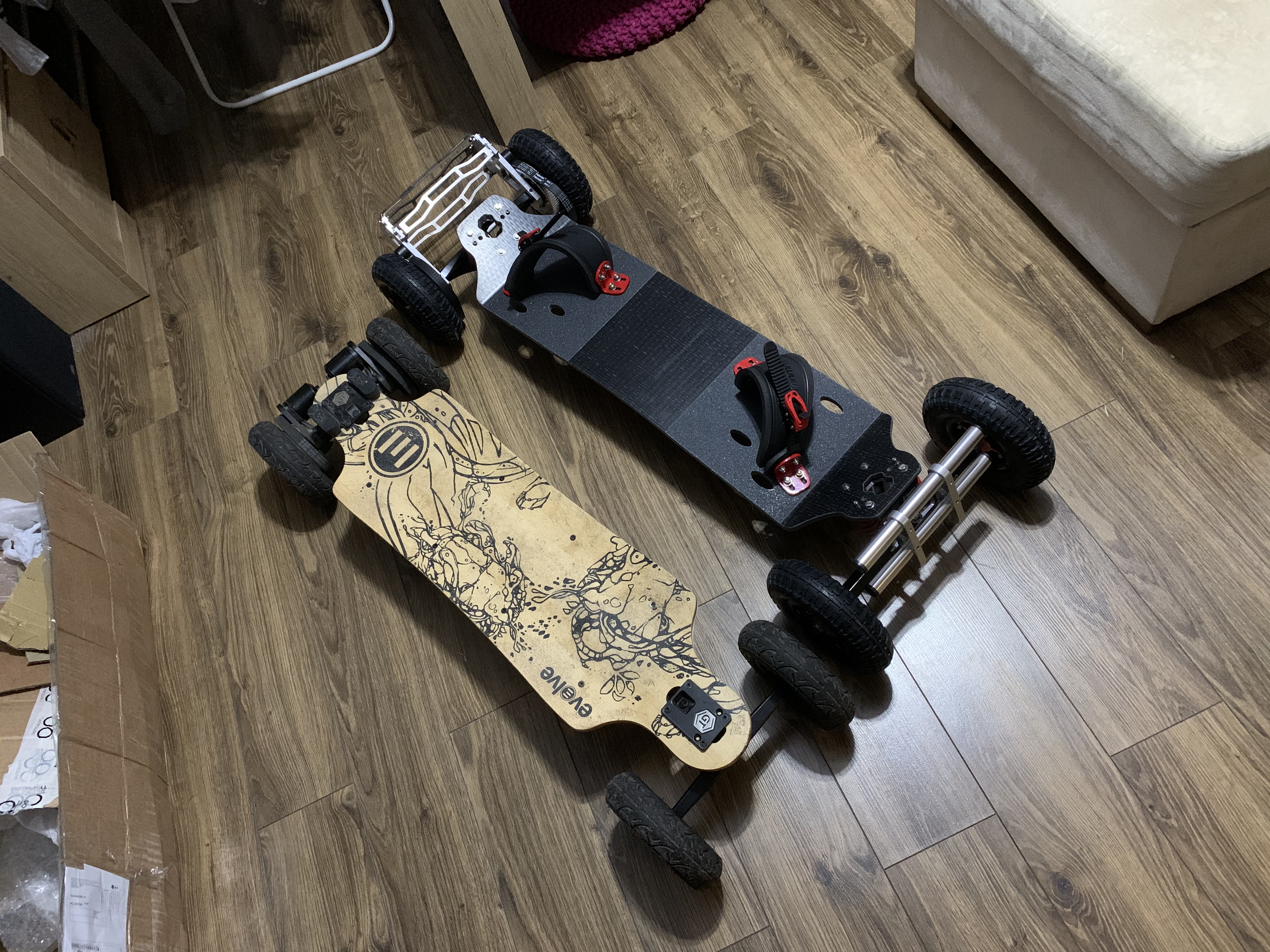

Motor comparison to Evolve strictly points that is was good idea to build something new :slight_smile:
Just before Christmas Santa gets me a board :smiley:
Moment later…

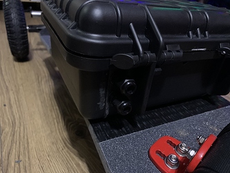

Got box for battery and ESC as most likely everything would fit there, not sure about correct ventilation as box is sealed, but will try find out that later (I’m thinking about external radiator, still keeping it sealed thought). I plan to place it on the back (same as Trampa Beast Box) as it will fit (I will omit cable routing problem), until I will not find a good reason to have it in the middle of board:

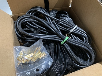

And here problem starts… Needed to reorder new cables due to incorrect thickness, few connectors and so on, so on…

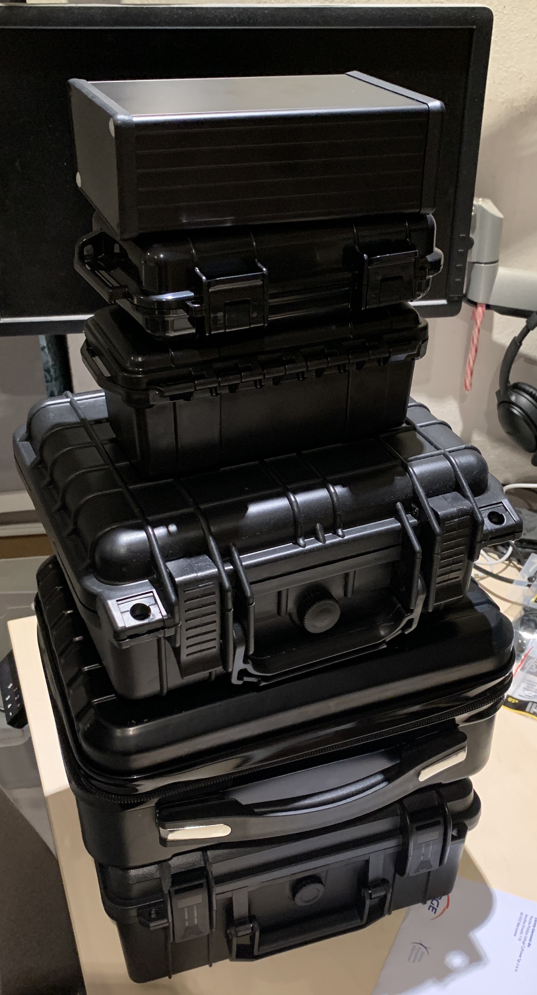

In the mean time boxes has arrived, good to have much more choices to test with:

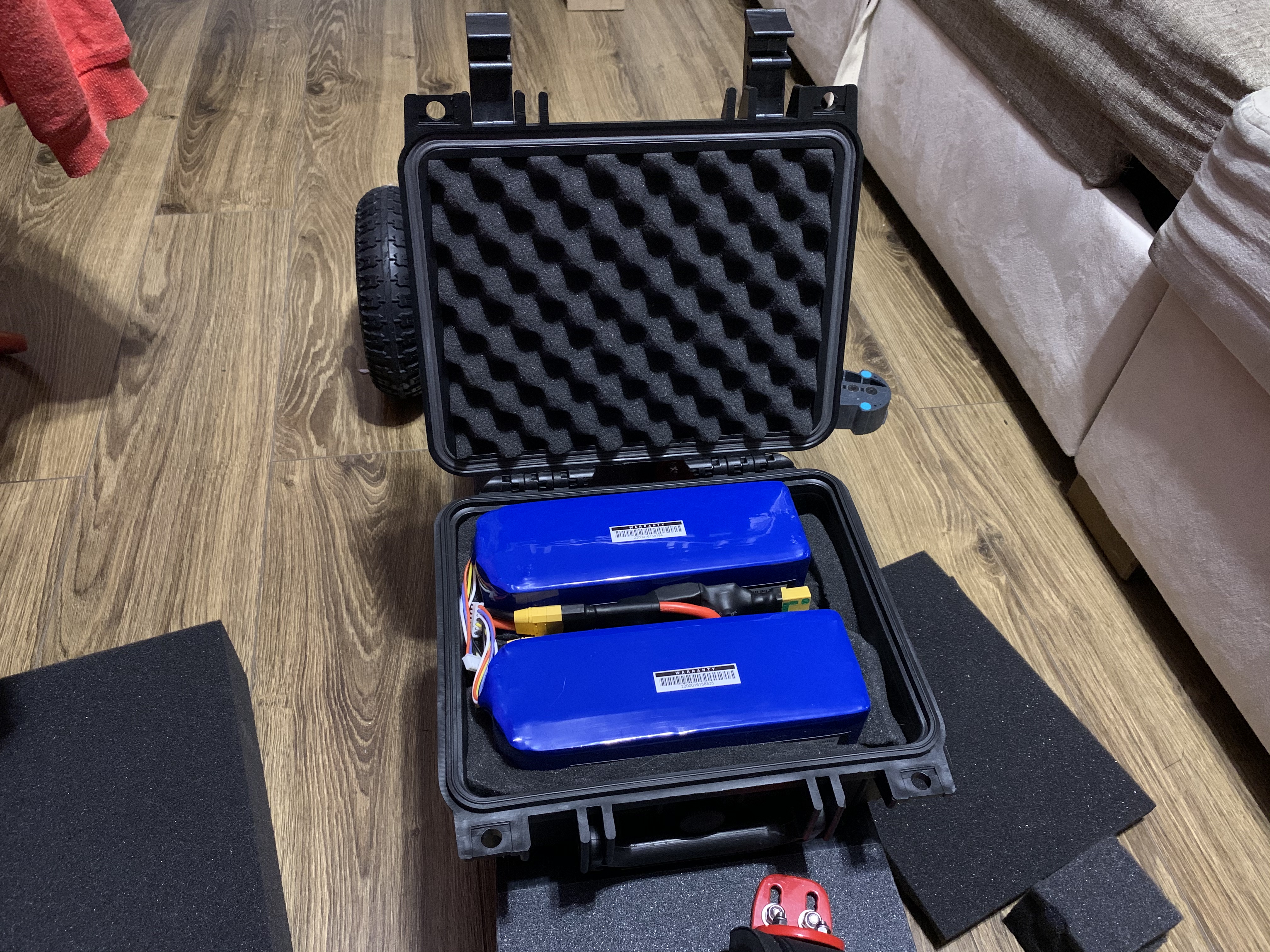

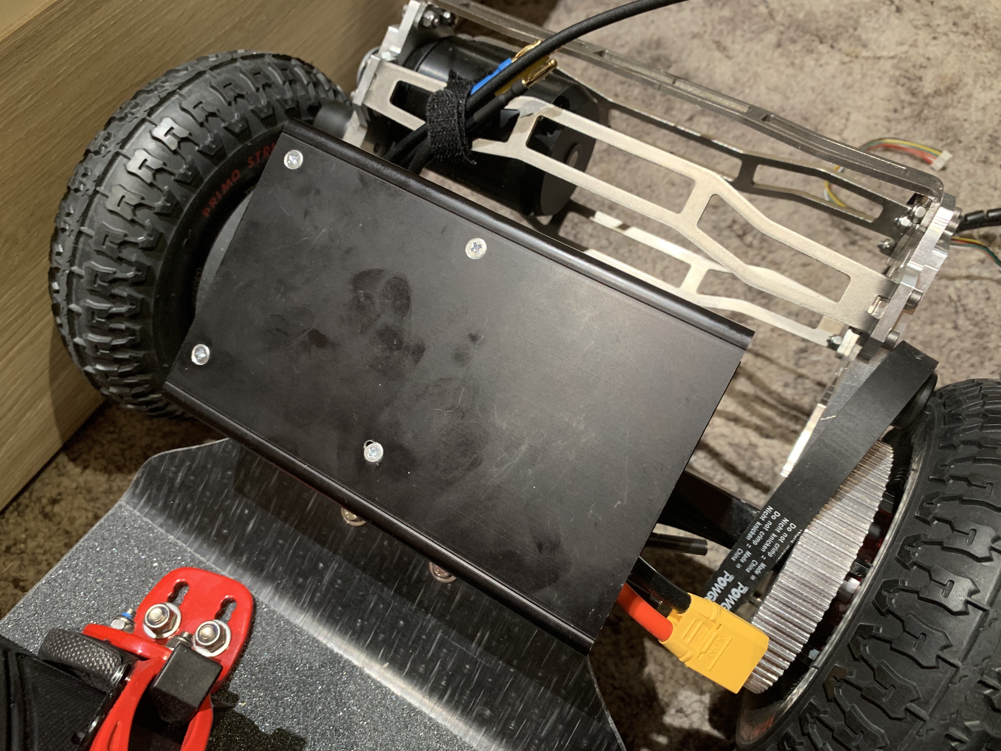

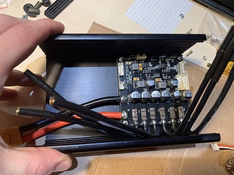

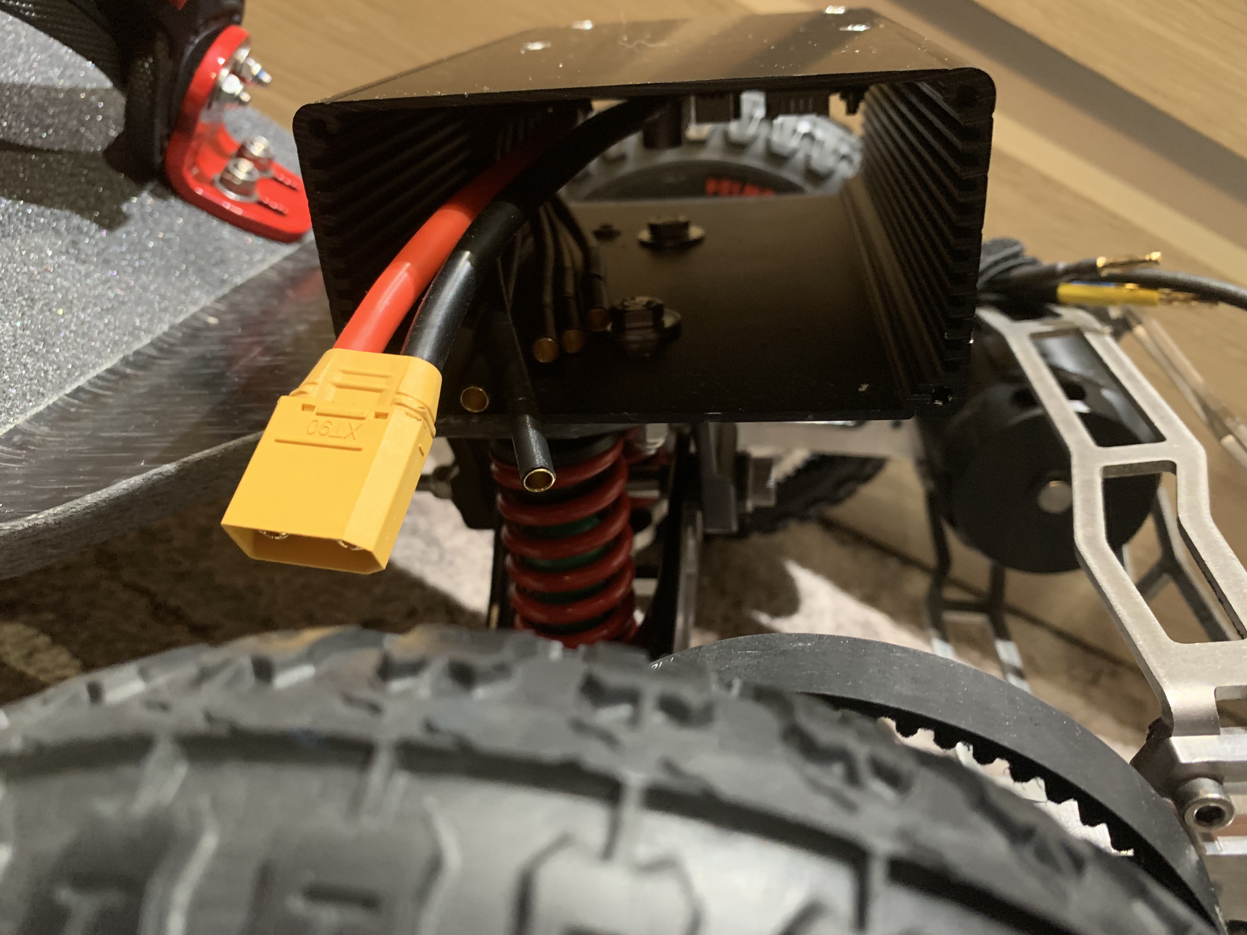

As there was not much space to put battery with ESCes on back of board (because of lack of space between box and tyres) I decided to go with “standard custom” design and dived ESC and battery. For ESC I have choose metal case to also act as radiator as I was reading Flipsky 6.6 Dual Plus likes to be chilled :slight_smile:
As I found in local store charger and power supply I was able to start connecting pieces and check if everything is working nicely :slight_smile: Got scared as FAQ hearing that noises during motor detection :smiley:

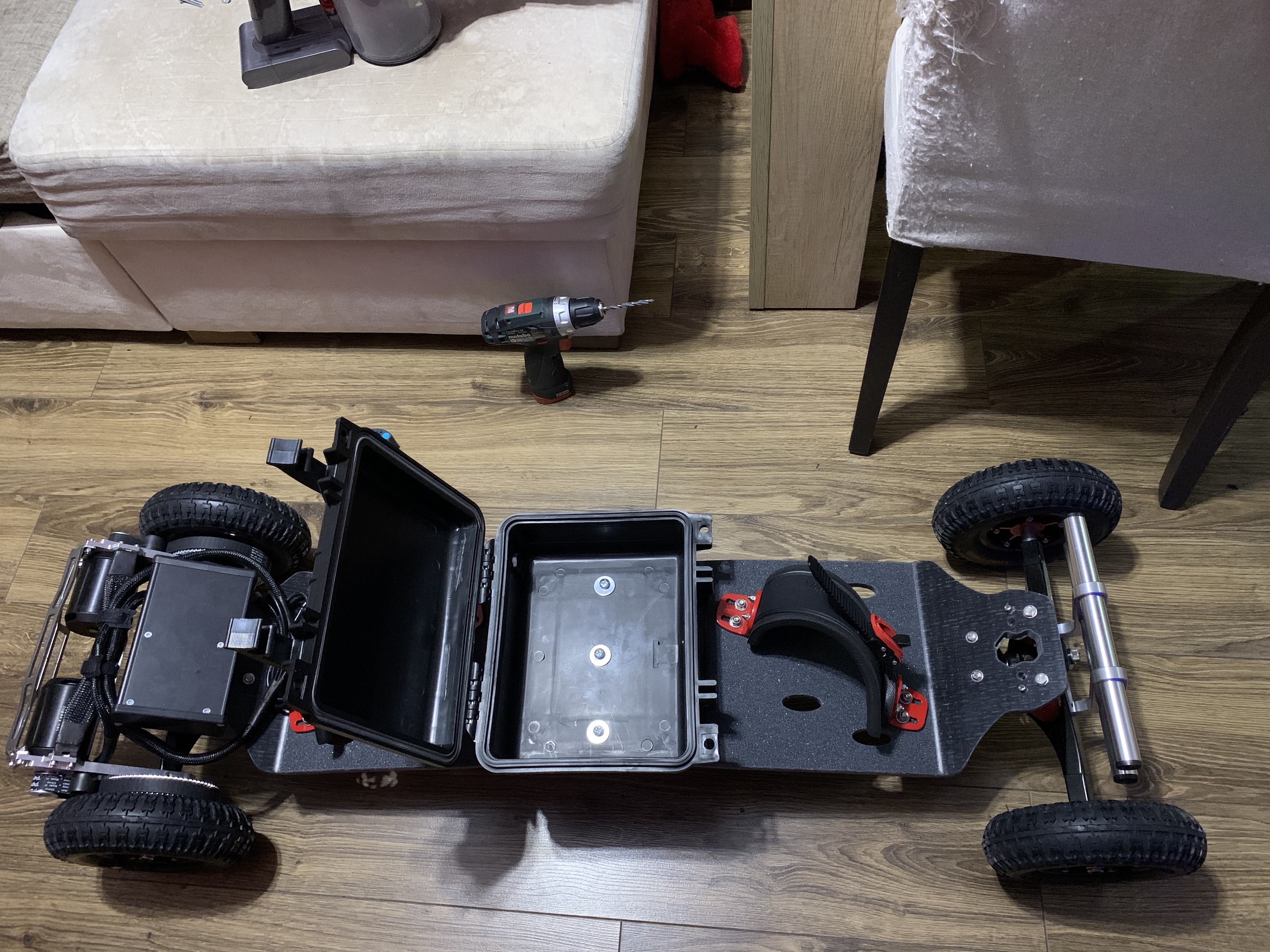

Engines were mounted, cabling for motors were done, box was suited, so time for batteries…

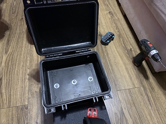

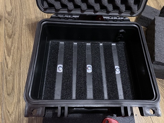

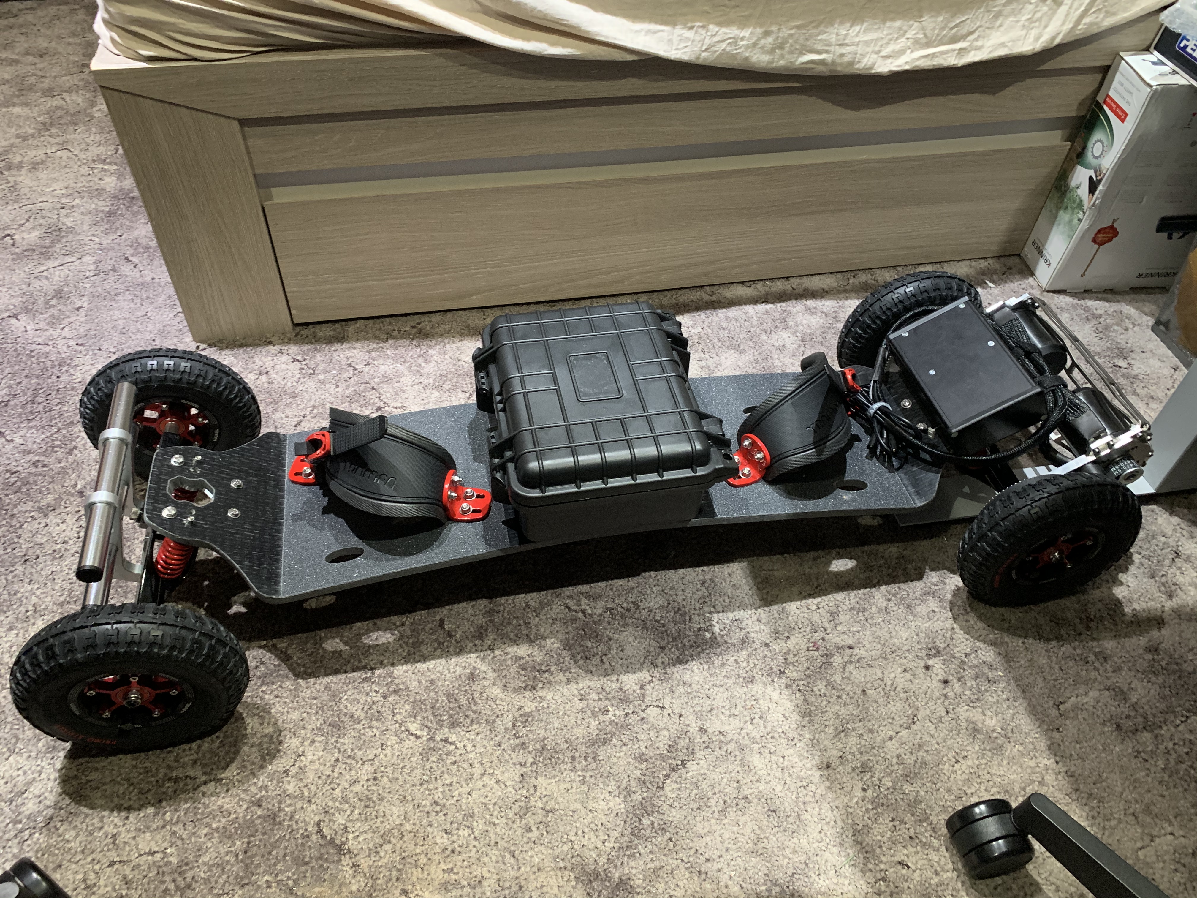

Box I decide to mount same way as Monster, using three screws with big washers, not sure thought it will hold on long, but will try as box got really think walls. If not… I will end up with Monster Box… cannot lose :smiley:
But first… lets make cables passthrough:

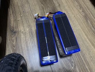

Battery arrives so lets fit them. Got resolder serial connector as it was too long and too stiff with fuse, but now it is time as possible and fit perfectly between batteries:
Now I just need to find a moment to finish power cabling and connections around ESC box, but for now everything is almost finished… cannot wait for a test ride :love_you_gesture:
