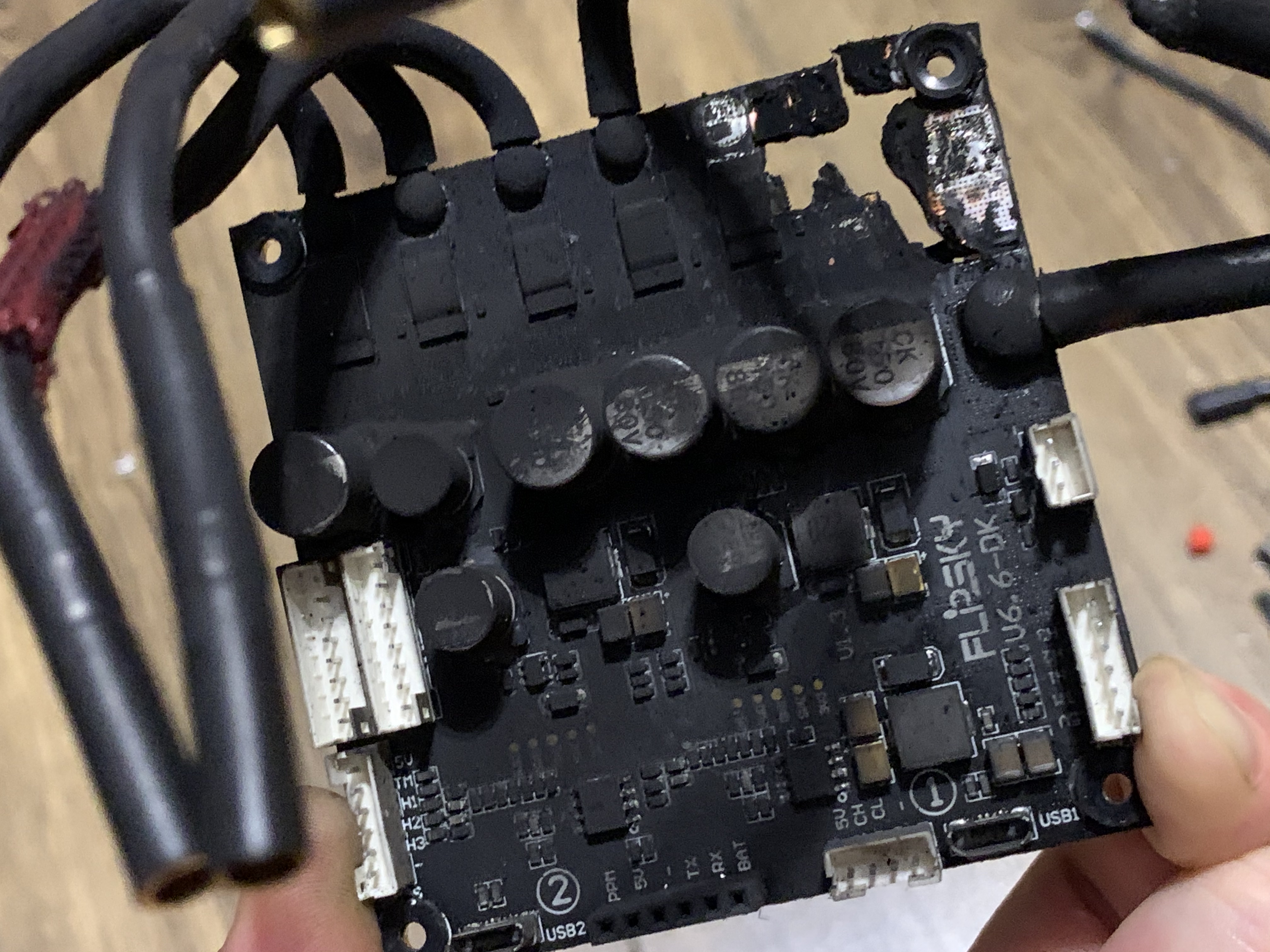

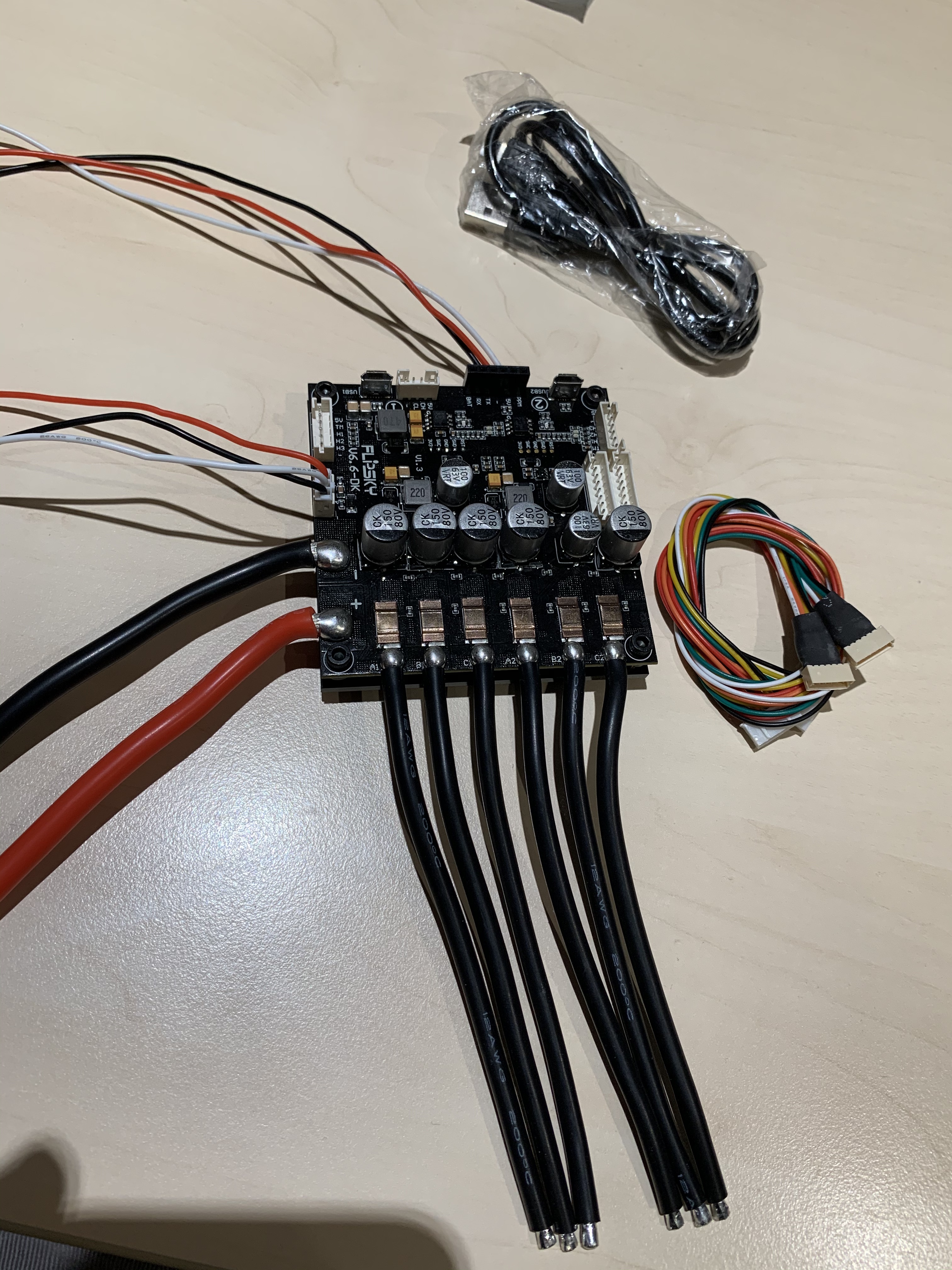

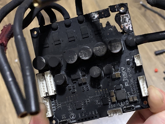

But not everything went smooth, after closing case, finish cabling routing this happen…
Saying mad is was not enough to describe my feelings… it happens after all tests when everything was ready as it was 4AM at night when I was happy to making road tests next day… terrible time.
Was searching for issues from my side, VESC configuration, connections etc. but find none… it just burned. After contacting with Flipsky (thanks guys) and describing problem with all my “documentation” from here I was able to get replacement. So I advise all of you to do such documentation when playing with electronics, because root cause of such problems can be on each side with similar probability.

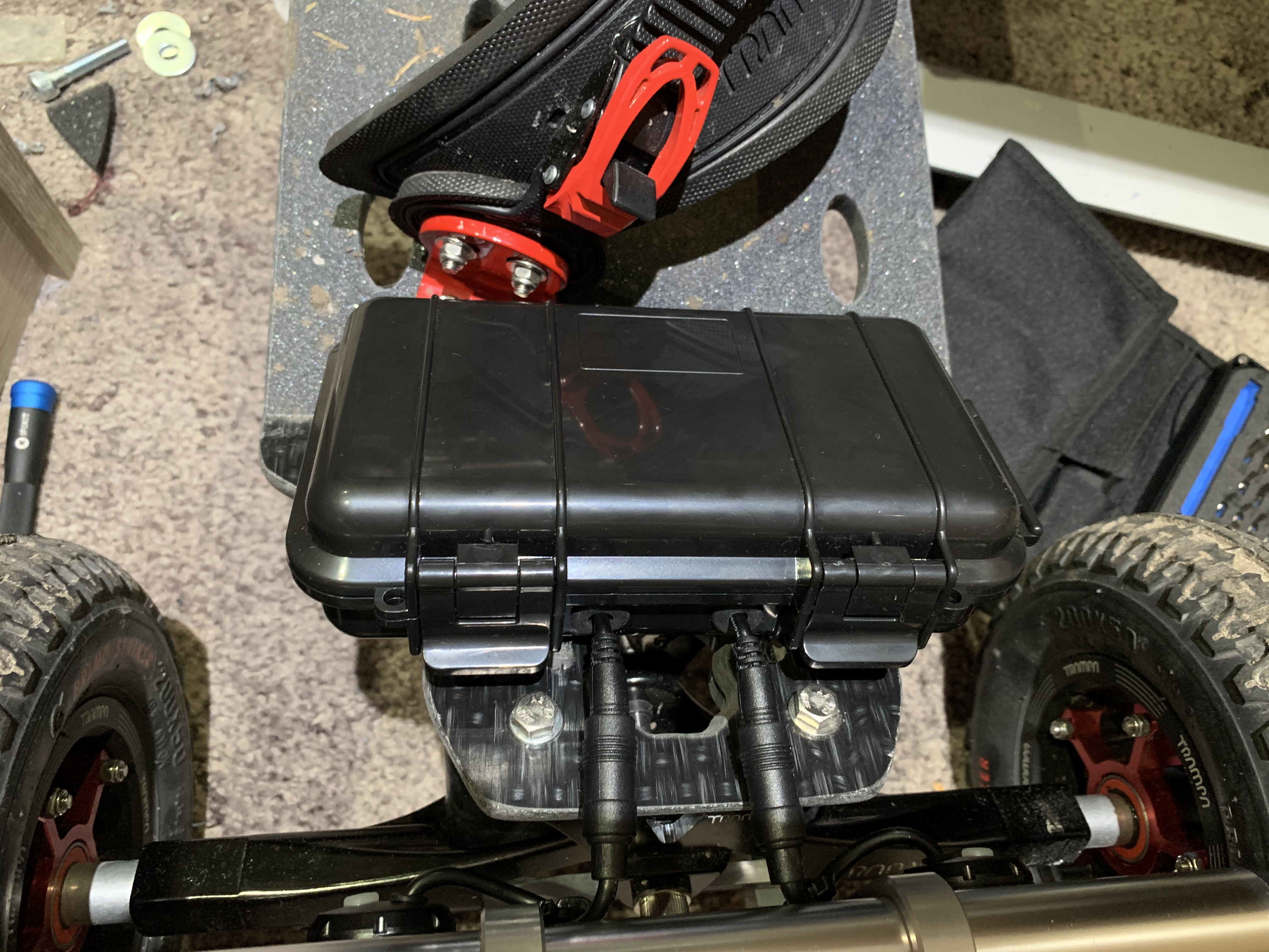

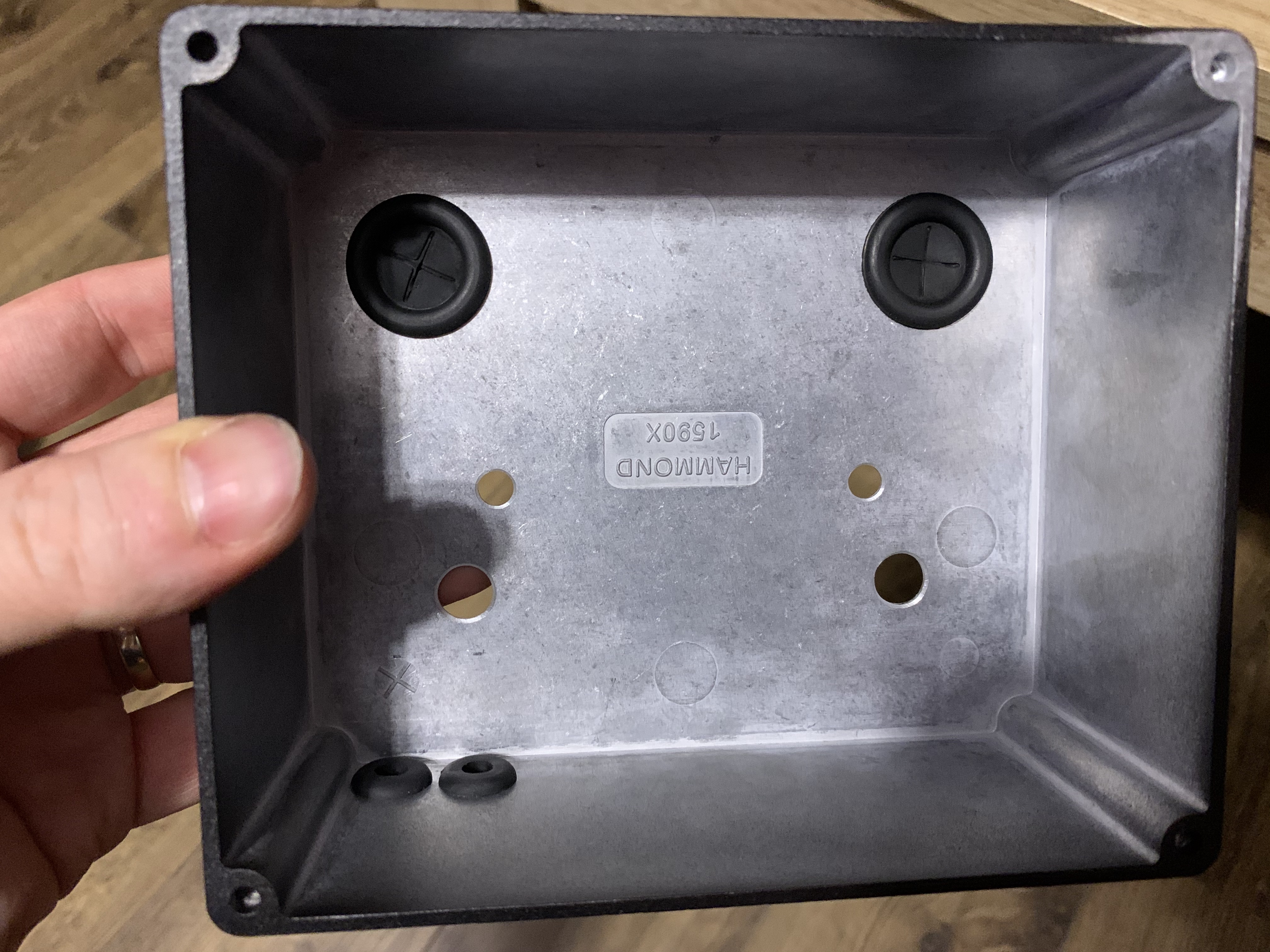

During that time got many new ideas so I end up with different box - easier access, a little bit more space and IPX resistant :smiley:
Thanks god Flipsky made it before koronavirus and get me replacement quite fast:

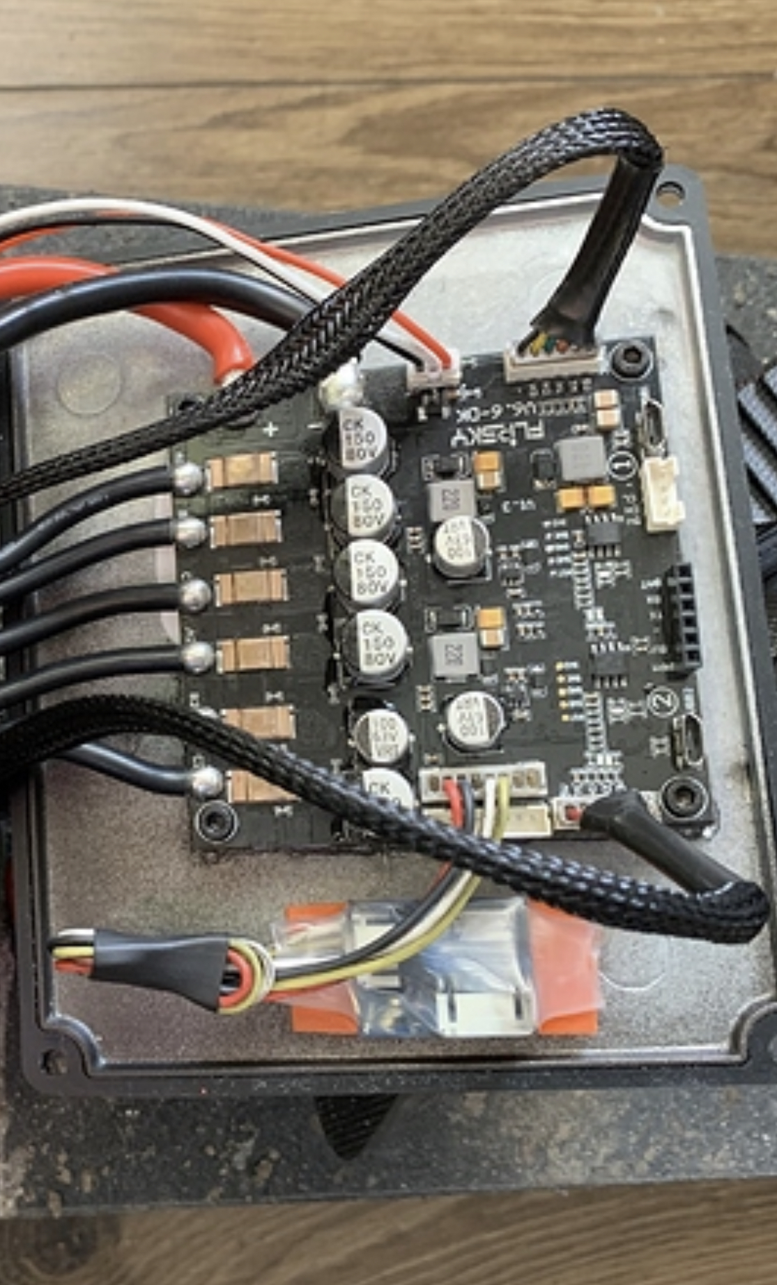

After “few” (counting in houndreds :smiley: ) approaches got a final case:

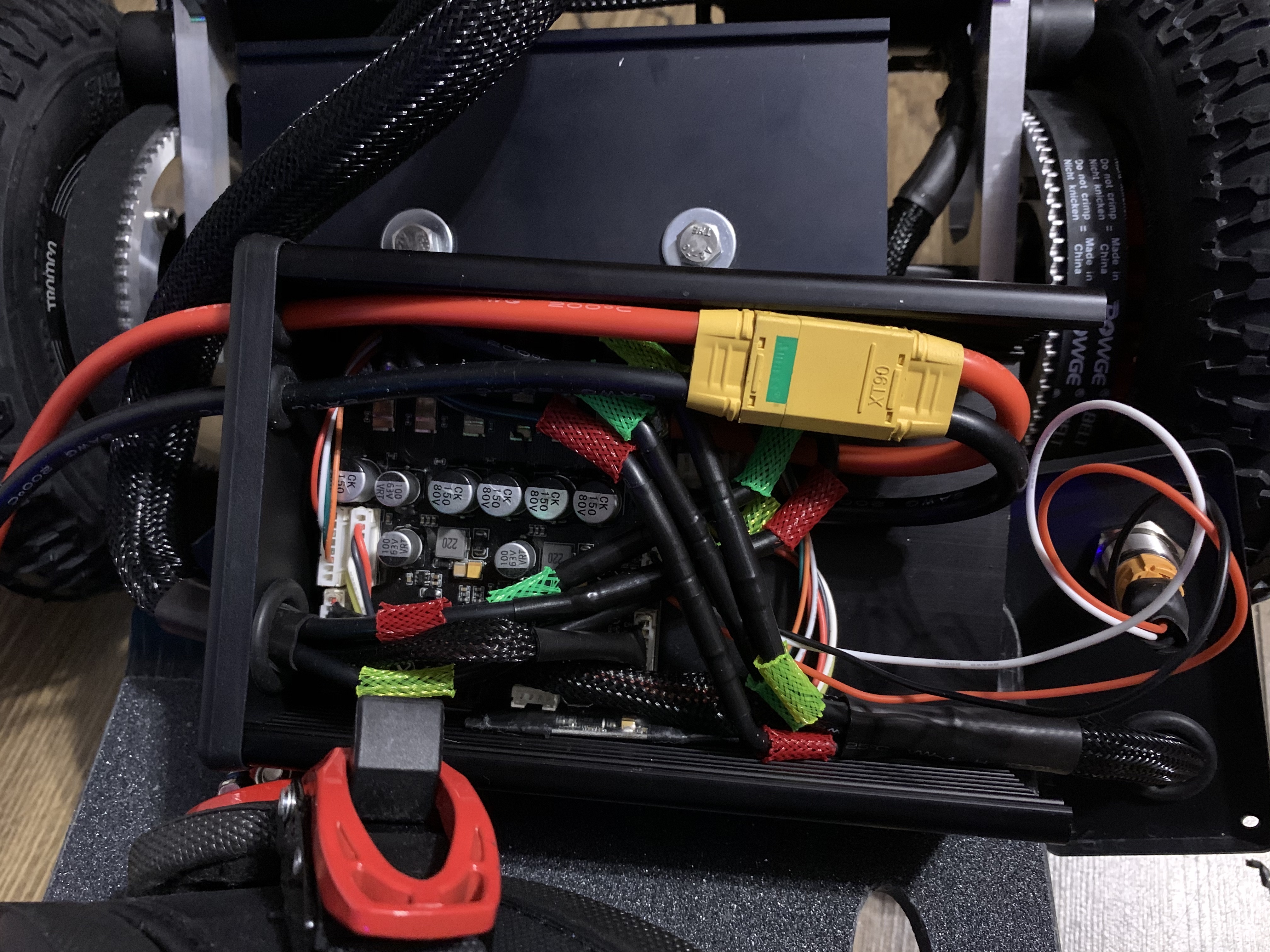

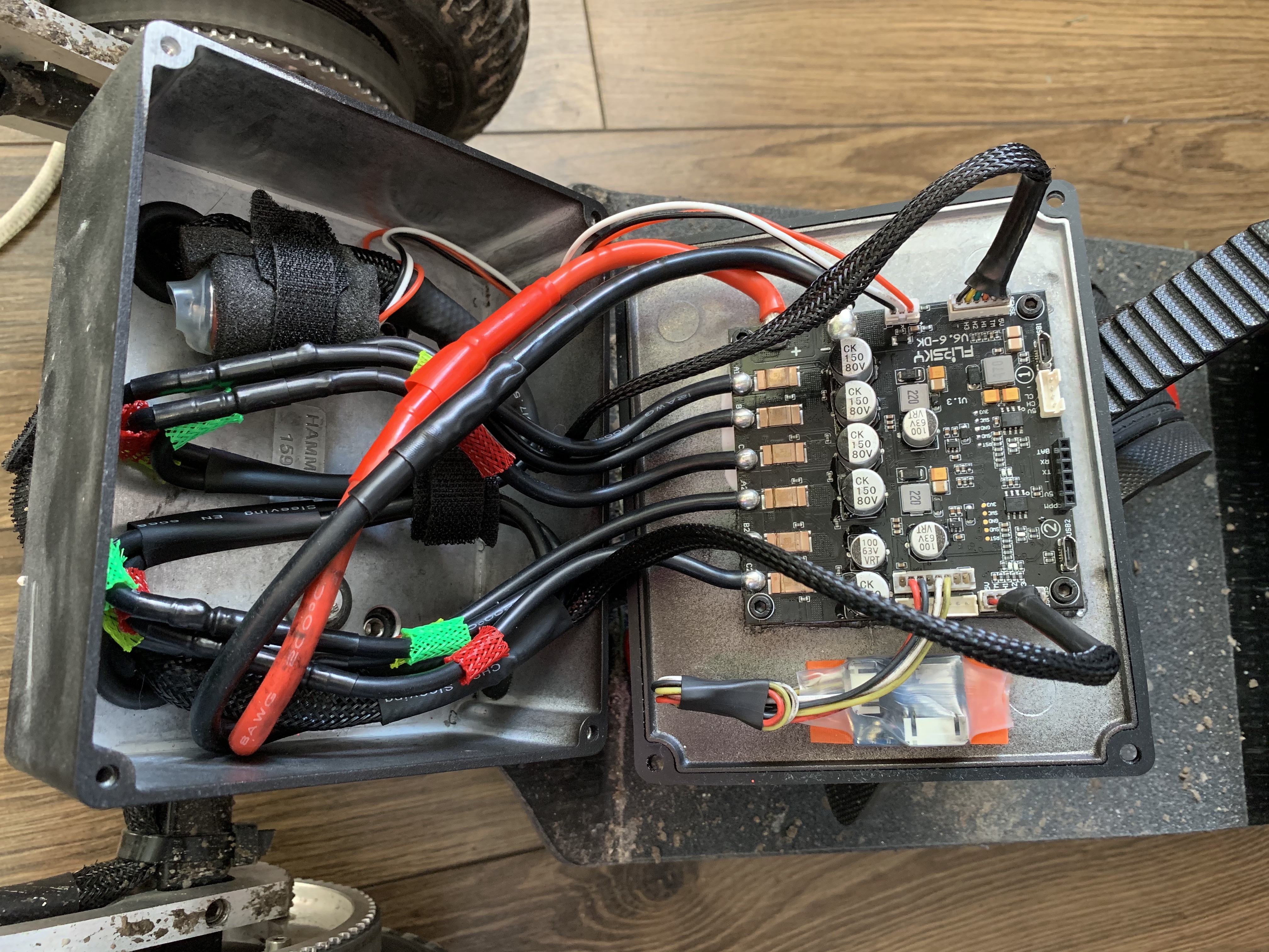

ESC this time is glued on heatsink edges to lid, being in same time connected with use of CPU thermal paste to lid to increase heat distribution. Also added some foam to cover cables from nuts and ESC from cables.

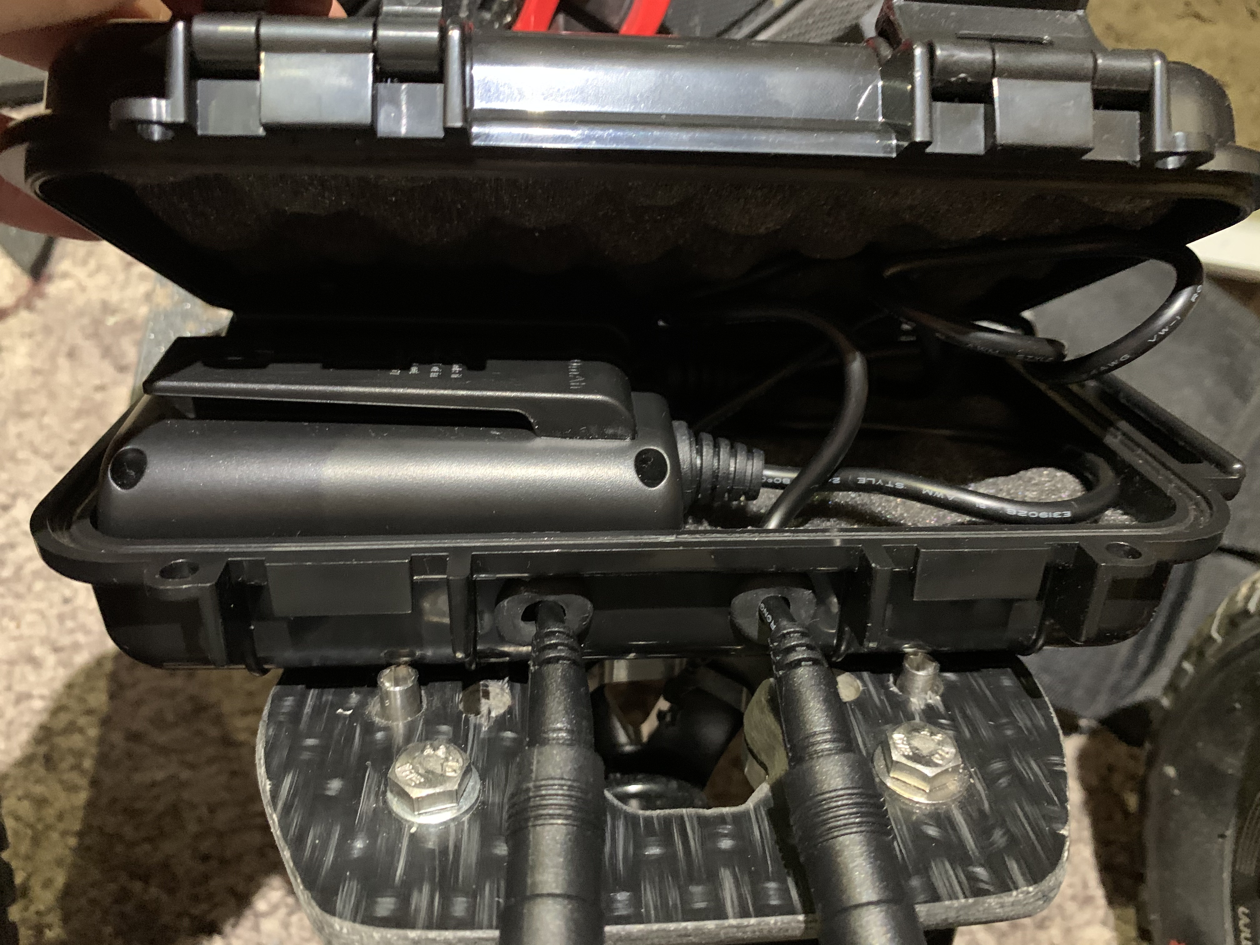

One issue still remains for future as yesterday find out that receiver is losing signal due to polarisation (case is acting as Faraday cup so signal is weaken). This still needs to be addressed, but already got some ideas :smiley:

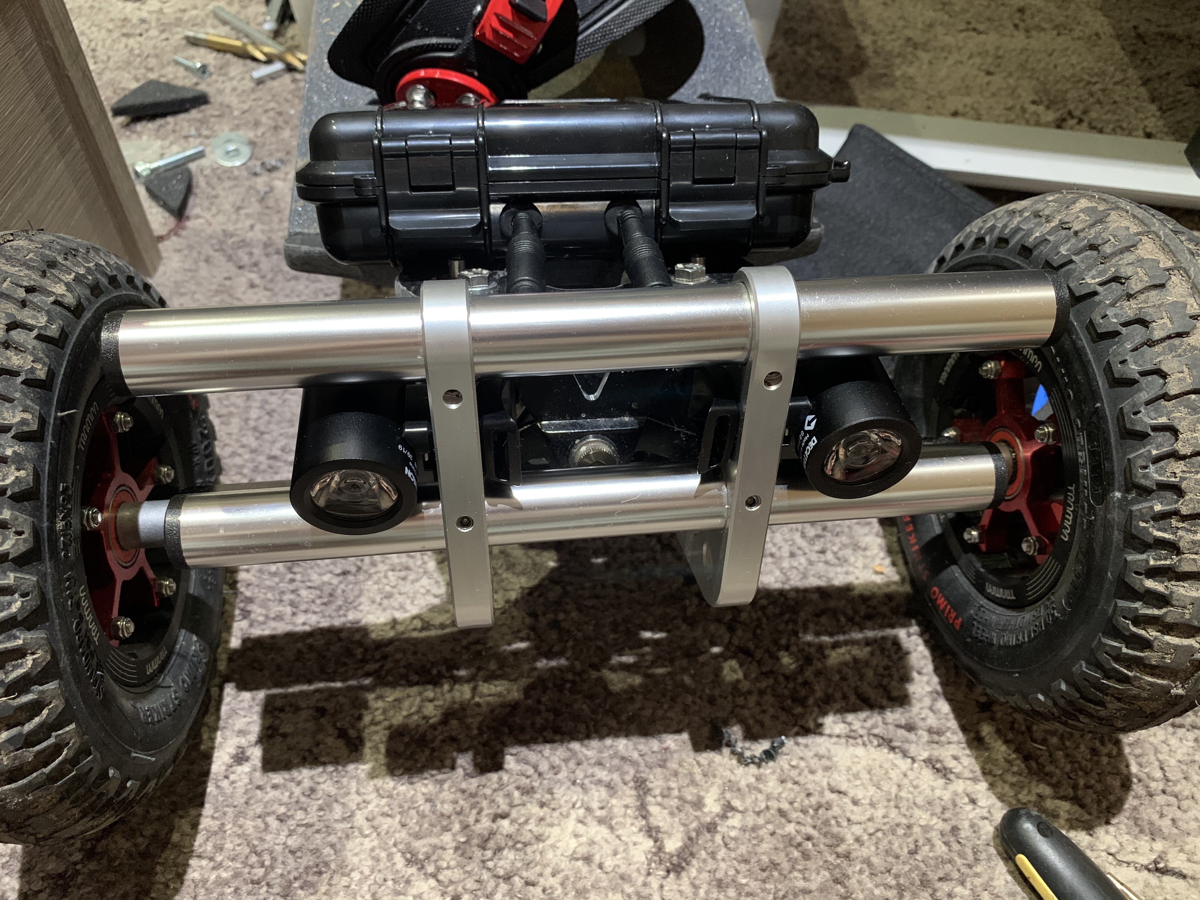

Last day I have also some spare night time to add lightening. Not final solution, as I want to supply them from main battery, but need to buy regulator from 48V to 8V to do so. In the mean time I have temporary used one of tool boxes I have ordered at beginning. Lights are double 260 lumens / 46Lux LED lights from bike. @Lee_Wright you might be interested into them basing on your last approach to Cyclop Beast :smiley:

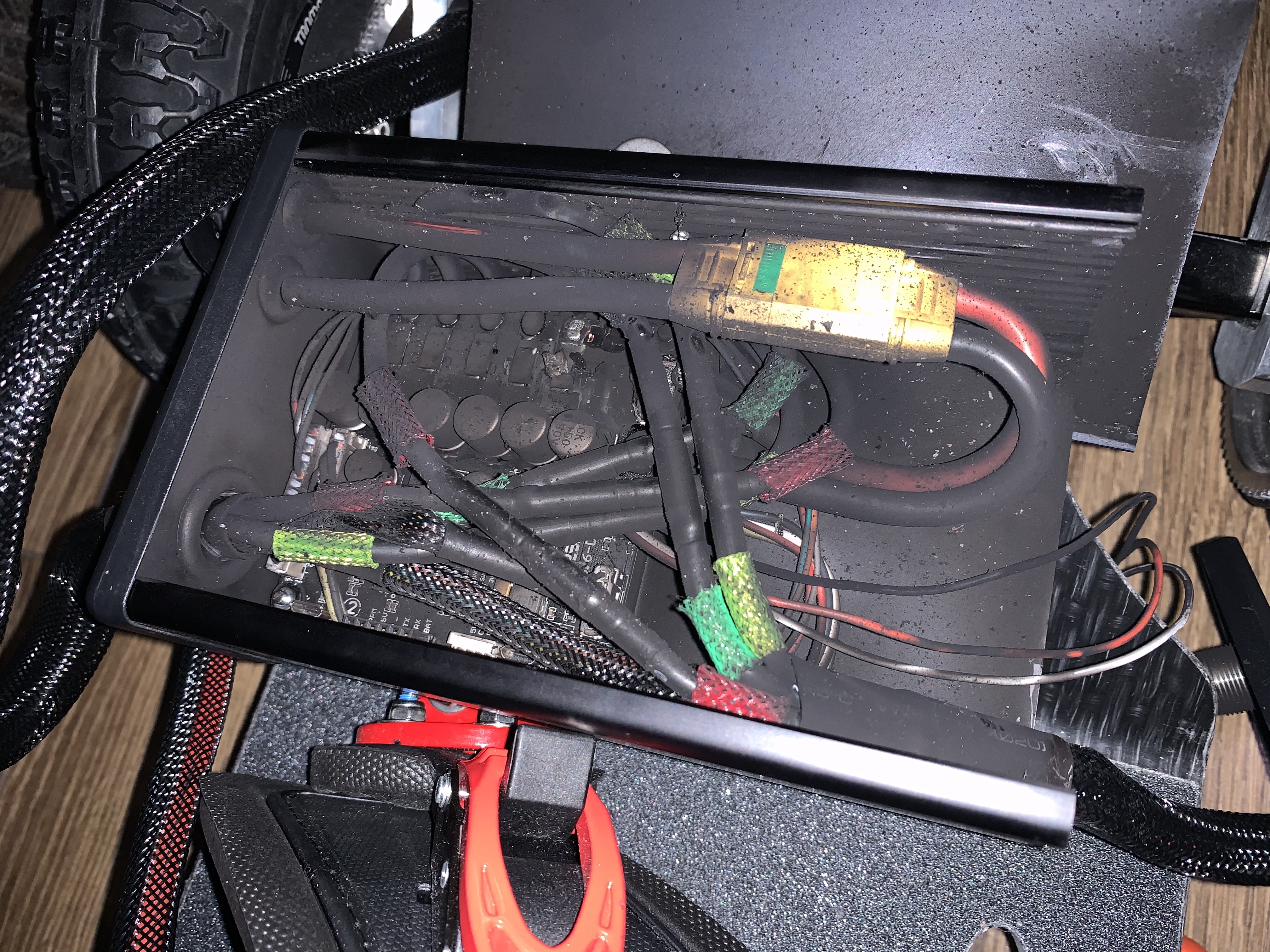

I would definitely cover the top side of that esc.
You placed bare connectors in a metal box. That’s no good, man!
Just waiting for your next short.
I agree with @Andy87 - removing the heat shrink and then leaving the ESC open is dangerous. Maybe heat shrink the ESC or do something to prevent it from getting shorted!!
Agreed this is another fire waiting to happen, from the looks of your last picture, I am not 100% sure the esc fire is 100% flipskys fault. Glad you got a replacement though. Deffiently make sure you manage your wires better, and shrink wrap that esc. Board could theoretically be renamed to “FireMaker”

First time it was not a short circuit. Bare connectors are not an issue if board is fixed to case. Previous it was mounted by screws, now its glued. Beside that it is divided from other things that might move and isolated.

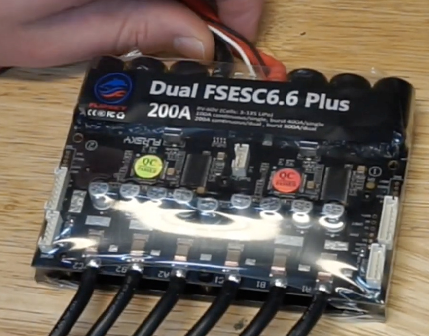

You know, that ESC comes heatshrinked in a way where you don’t have possibility to plug connectors, right? So this is producent call. Trampa does far better job in that manner and if anything will happen with that board I will go for their ESC, because of fabric casing, mounting points etc.
@Andy87, @robedude, @Skyart thank you guys for worry, but first to get shortcircuit there must be loose element that might cause shorcircuit. Everything in that box except ESC is isolated, board is fixed to cover, so there is no possibility of that one. Of course I would also feel more comfortable if Flipsky would offer some casing for top part, because I fear more of cables that could physical damage to board elements or water that might somehow get there rather than shortcircuit it. That is why I was looking for something like that sprays (e.g. Lexuma X2O (10ml) - Waterproof / Water Repellent Spray for Electronic) that does make your electronic waterproof, but not sure if that won’t make board to overheat or something.
Also seen a project where a guy put everything in some kind of plastic making its board waterproof. But this for sure might cause overheating problems. At this moment thanks to metal box I got ESC at level of 32C under full load (4C outside temp), which is great, comparing to one of previous setups when ESC was closed inside and got almost 90C during a load.
BTW you might get shocked how many electronics are in metal boxes and boards are not isolated… take a look of laptops or PCes for example :wink:
But if you got some ideas, or maybe a ready project of 3D printed case for that ESC I would be glad. Its not that I don’t agree with you, I do, but got some experience with electronic, electric etc. and I’m aware of what I have to fear.
I had always thought that the original heatsink was there so that you could only cut away the spots needed to connect your plugs. You aren’t supposed to completely remove the shink-wrap unless you plan on rewrapping it.
To be honest… I have no idea :slight_smile: That shrink-wrap does not make any sense for me, because beside covering ports, it is also decreasing heatsink efficiency.
If it would look like here:
I think I would leave it, but as it was looking like below it was natural for me to remove it, especially looking at power cables and its bend radius:
On my FSESC 6.6 Plus I have the heatshrink around the power cables cut, as well as for my remote, metr, & hall sensors. Everywhere else I leave the original plastic wrap. It works really well and keeps the ESC pretty tightly enclosed and protected from shorts. I ended up covering the power cables with electrical tape too since they were a bit exposed. I think this is the easiest way to prepare the ESC properly (as opposed to re-wrapping and cutting slots later).
I didn’t thought about it as master plan was making an box part of heatsink, due to known problem with overheating of that ESCes. But thanks for tips :slight_smile: I think It might be possible to cut a hole for heatsink, as it will hold on on corners.

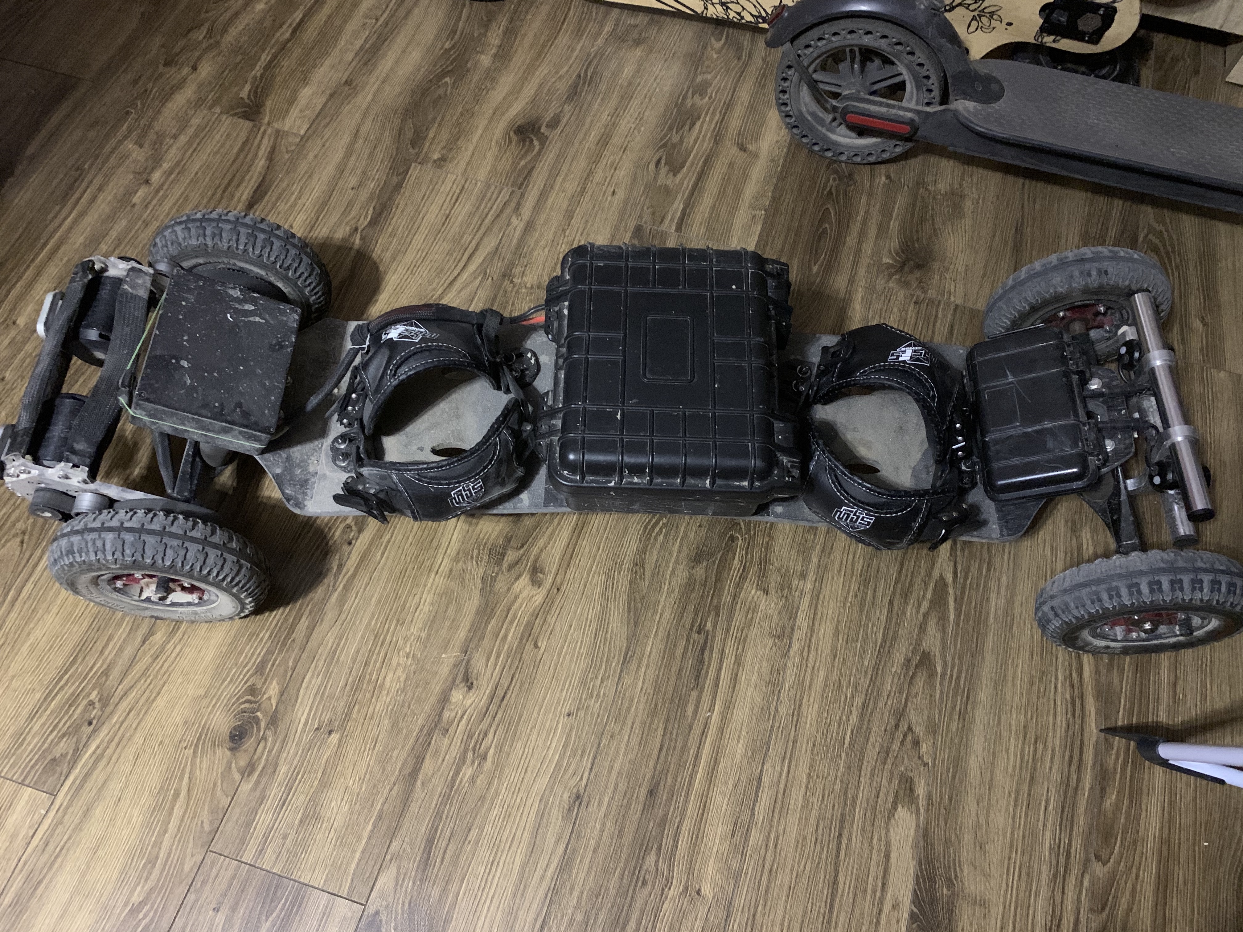

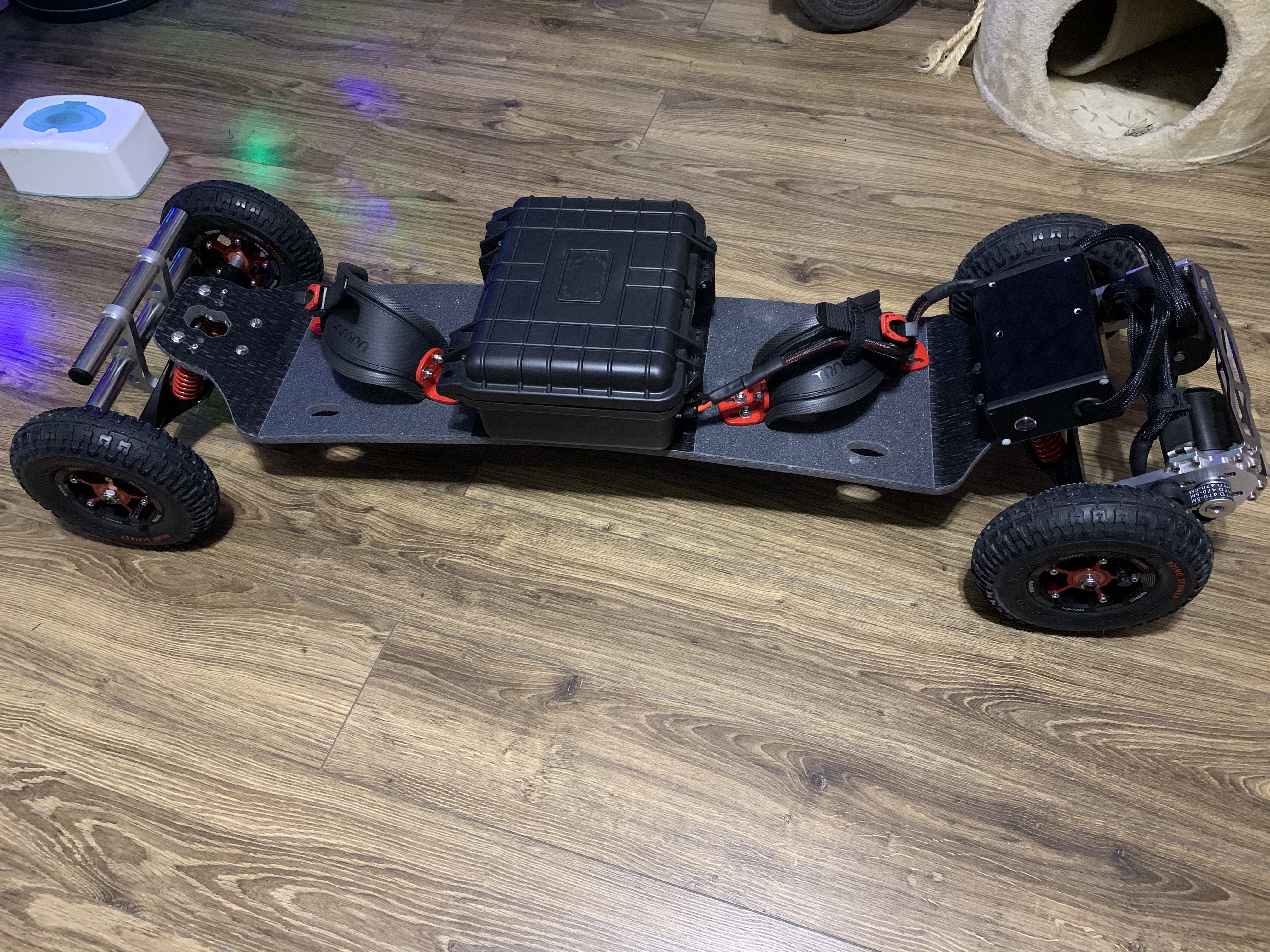

From news, got new bindings with heel straps - best choice ever :smiley:
Was a little afraid at first of having foots fixed to board, but after a first ride it was good decision. They gives so much feeling of control and overall board feel - it is awesome.
