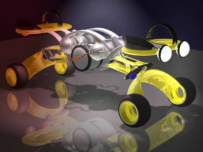

Back to year 2000 or so, there was a lot of hype about Hydrogen fuel cells, Aprillia even had a working
scooter. And I was thinking about using that as a power source for my emerging skate design.
O.k. so it looks laughable now, but at the time I thought I was on to something.

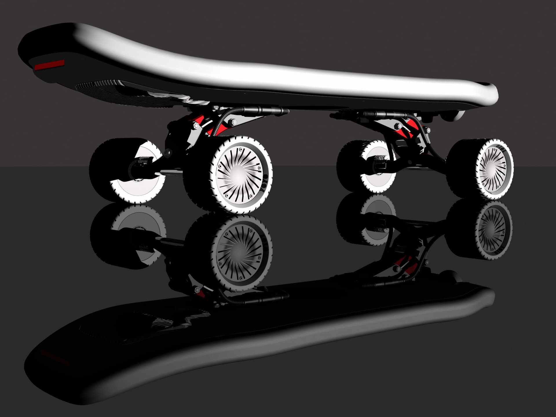

built one but recently I went a different way with the design and I wanted to show you guys to see
what you think of it. The main focus was to use leaf springs instead of coils. as a way to make a
compact, durable unit. While researching advances in the tech, I was surprised to find lots of other
interesting designs, some composite, some titanium. For this on I’ve based the spring on Ti grade 5.
For the quantity required the cost shouldn’t be that bad(wild speculation). Also there has been no
FEA testing, this is eyeball engineering at it’s best/worst, you decide.

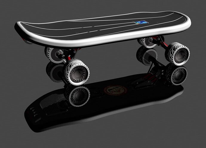

It’s a short fat 32" x 12" x 1.5", or roughly 810 x 300 x 40mm. It has about 45mm of travel.
The wheels are 100 x 65.

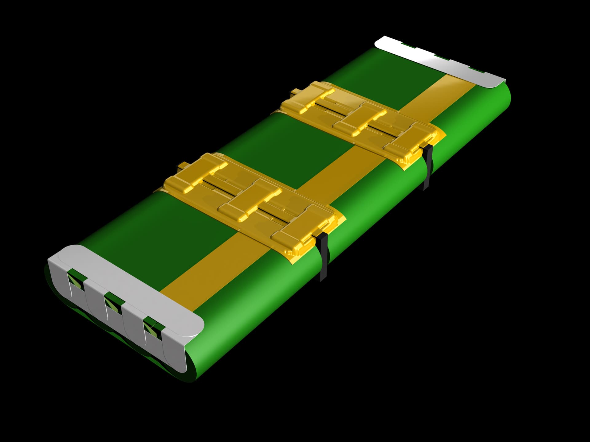

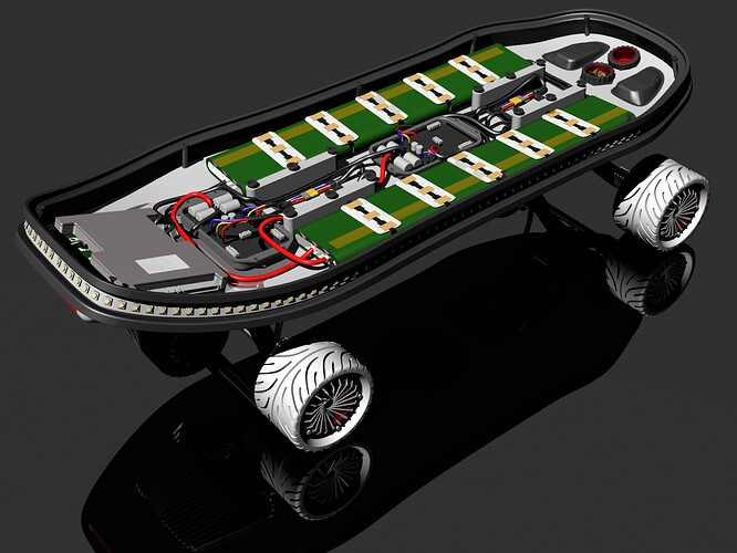

I’ve got a bit of a thing for hub motors, I know not for everyone but for this they are
clean, quiet and reliable(Hobbywing at least). As to the electrics inside, it’s just me
dicking around, nothing has been decided. Really though the trucks are the focus here.
The exploded view is of the rear with rose joints to act as an adjustable rake angle.
The front is set at 27 degrees, very close to Bioboards 27.5. Again, I just guessing.
Your thoughts would be appreciated.

So you want suspension for a smoother ride, but you also like hub motors? :thinking: Hub motors are the exact opposite of smooth when it comes to anything that isn’t perfectly paved. :rofl: I’m still on hub motors so I’m not bashing them
That aside, if you have that much height by default then you might as well take advantage of the extra space on the underside of the board to store the esc and battery pack. The suspension system already adds some complications to building the board and there is no reason to add to that by storing the esc and battery inside the deck, or at least not for the initial build.

I don’t think its a board I would enjoy riding because of the small deck and high ride height. With the deck so high above the pivot axis of the trucks it may feel quite weird to turn, and the suspension appears to have a lot of travel which will make the handling not that predictable because you’ll have a partial steering delay as the suspension loads up in a turn, and then unloads coming out of a turn.
I have learned a lot with suspension on skateboards but I hold most of it close to my chest for now.
Is there any damping in the suspension or just leaf springs? Damping will be very crucial to make that board feel predictable
I would like to add, have you checked the stress and deflection in the suspension linkage under the torsion and lateral loads that will occur during a turn? That may degrade handling beyond what the ‘idealized’ scenario that Tony outlines above. Those parallel link arms smell kinda spindly to me, but I’d like to be wrong about that.

About the battery being under the deck, I like the thought that it woud add to stability but I’m going
for a bit stealth. It’s still illegal to ride these in most of Europe, so it’s just to help you stay under the radar.

Tony, do you think raising the pivot point, closer to the deck would help?
As to damping, there are soft rubber dampers above the leaf spring, not very well shown, and another
one where the end of the spring where it connects to the bolt running through it. Not exactly oil damping, but better than non. I have actually rigged up an oil damping system, but I pulled the plug as
it was getting way too over complicated. However, it is still an option.
Flyboy, no stress testing so far. I’m kind of with you on the linkages, a bit more meat wouldn’t hurt.
Also the pivot on the axel hanger looks a bit of a weak point.

Let it be hydrogen fulled, now that would be epic

My one comment is that I would predict that in real life the small wheel size is going to be more of a disadvantage than the suspension will be able to compensate for. I would opt for bigger wheels in the same overall size footprint.
That being said, I’ve never ridden a hunter board, which uses small wheels and suspension, so maybe I’m totally wrong :upside_down_face:

Meat is good, I was also thinking of putting a shear web between the links. That would take out all the lateral compliance you don’t need.

Love the design, however going stealth but adding 4 hub motors, a lightstrip on the side and big ass suspension seems a bit contradicting. Maybe the word “sleek” Is better.

Hi Plurf, I’m not .so keen about the high pressure Hydrogen cylinders though :grimacing: Kaboom!
Hi rusins, how much bigger would you go? The Hunter is the closest thing out there and the
reviews seem pretty good regarding the handling/carving. I havn’t riden one either, I would love
to try it.

Bavioze, Ahhh shit! I may have over looked the zillon LED’s. I like sleek though.

I had a tinker with the parallel linkage and ended up linking them as Flyboy suggested. They are also
much thicker, from 5mm up to 9mm and no pockets/cutouts for weight saving. The part they connect to is
also wider and thicker. I kept half of the rose joint set up at the rear to maintain adjustability.
Tough enough??
