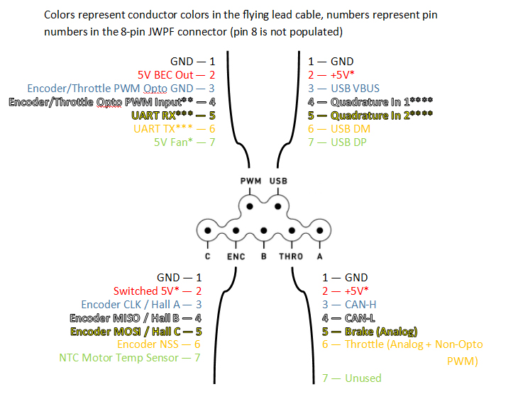

The arc200 has his one connector types which don’t fit our jst stuff we use usually. Do they come with adapter, i mean just the other side of the plugs you can thsn crimp solder your own stuff on. Or do you need to source that by your own? If by your own, could you share the name/type of the plugs they use?

I didn’t, but you can cut the connectors and solder on whatever you want. There are wiring diagrams in abundance at the Freefly Wiki .(https://freeflysystems.atlassian.net/wiki/spaces/FRP/pages/269844541/Wiring+Arc200)

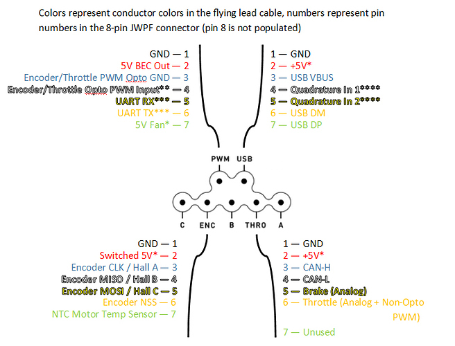

Here’s a illustration of the pinouts,does that help?
totally! Everything clear now.
