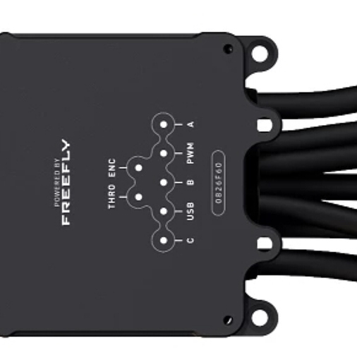

Oh i just realized they aren’t 6 of the same Connectors. The white background tricked me lol.
They are for USB, PPM, CAN, Sensors, etc. The connectors are waterproof also.
I would say it’s this
@mmaner can you tell me the electric noob what is the ā€žencā€œ and ā€žthroā€œ connection used for?
I don’t remember off the top of my head, give be a free few mins to go look at my board.
Sure, no stress. Do you know if arc Plan to integrate something like Bluetooth connection and an monitoring app?
How about nrf based remotes, would they work with this esc?
Throttle and Encoder.
The throttle threw me for a minute since I’m not using it. It’s for snapping control, control toes other than PPM/PWM.
Encoder is for sensors.
They have mentioned using the built in Bluetooth for a mobile app. I think if there was a demand it would happen. There’s an entire team of people that develop this product at Freefly.
I haven’t heard anything specifically about NRF, but I doubt it. There’s little need when you have digital control built in.

I didn’t fully understood that. Language barrier :sweat_smile: what does the build in digital control have to do with the the remote? I mean there a lot of people using remotes like firefly or similar and it would be good if it would work with it.

All I meant was that it’s not a necessity to have NRF remote capability when you already have the capability for PPM/PWM control and analog control.
