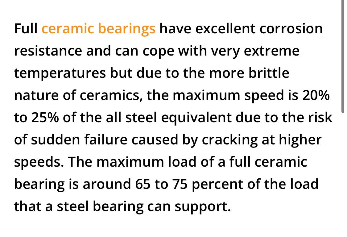

Here is a nice little explanation:
They will still shatter. Ceramic cant handle strain at all, under any kind of shock loading it will just fail.
No.
When the bearing shatters either your wheel locks up and you get yeeted off the board or the wheel falls off and you get yeeted off the board
Pneumatics is actually worse because they brake harder when locked than urethane and it’s a bigger drop if they fall off
For the lazy bois here:
ceramic is brittle
it’ll explode on your first bump and any damage will cause it to also explode at speed

Here is some calculations:
https://www.skf.com/sg/products/rolling-bearings/ball-bearings/deep-groove-ball-bearings/productid-608
This bearing is rated for 48000rpm.
Pneummie being 200mm diameter usually.
200*3.14= 628mm circumference.
48000*628= 30.144.000 mm/min
30.144.00*60= 1.808.640.000 mm/h
1.808.640.000/1.000.000 = 1808.64 Km/h
0.25*1808 =452 Km/h
So technically you would be safe rotations wise. I would still NOT advise this since this is without bumps etc.
Also this drastically changes when you have a smaller diameter wheel.
