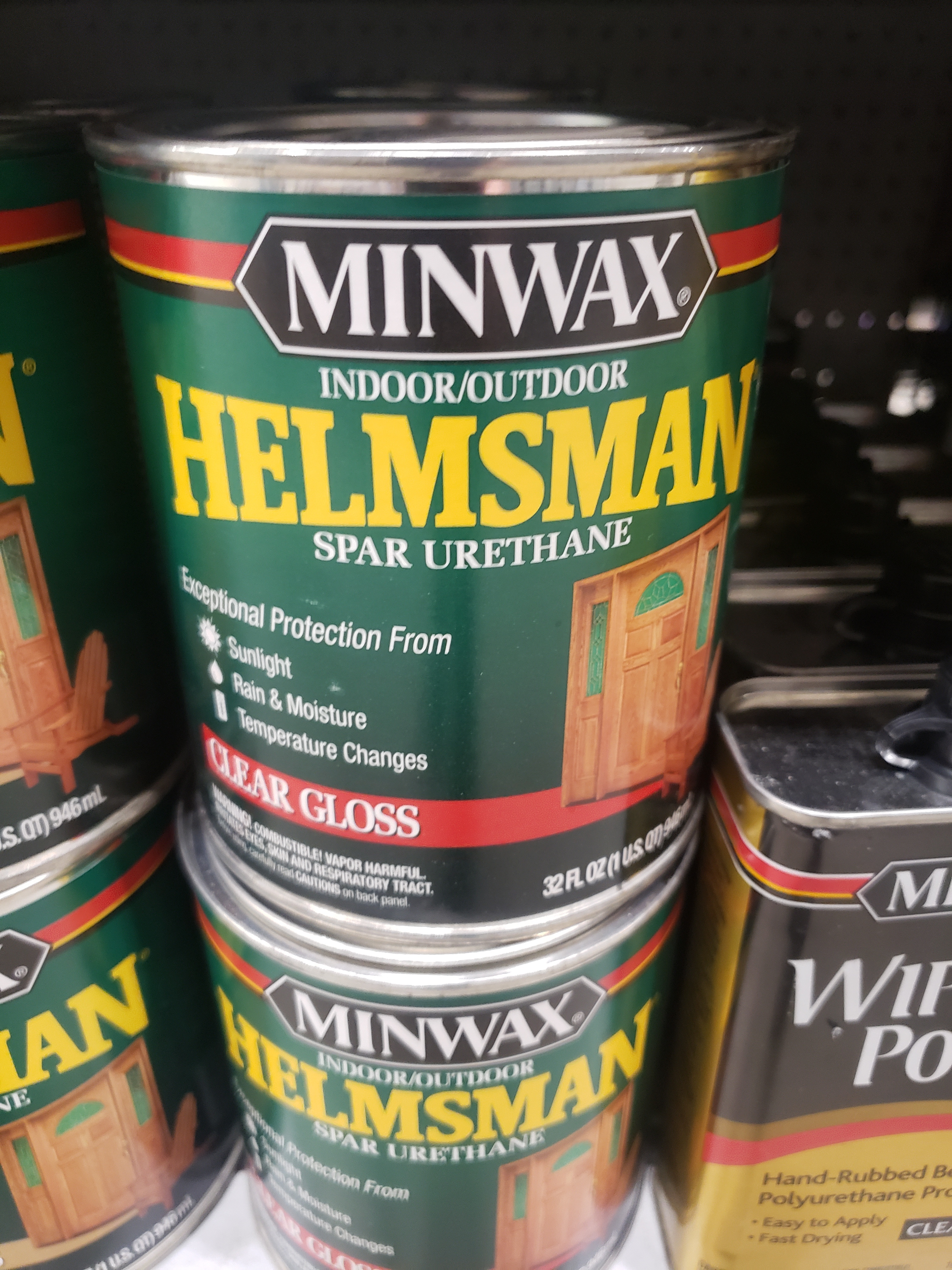

Ok guys, just went to the hardware store, i need a recommendation for what to get… medium frit is on the way.
onecoat poly? regular poly? spar urethane? pro series spar urethane? or spar marine?
I’d go with water based spar
Polycrylic is not the same as polyurethane. It is like a runny milky colors. When dried and cured it has like a plastic type feel. I would not use with grip. That would be more for bottom of the board and then you can wet sand it to a mirror like finish. The helmsmas spar is oil base and not an easy clean up.
Out of those options I would use the Pro Series Spar. It is what @longhairedboy uses I believe.
I have a bucket of the Helmsman water based spar and it’s runny AF but works well. You just need to do a lot of coats.
