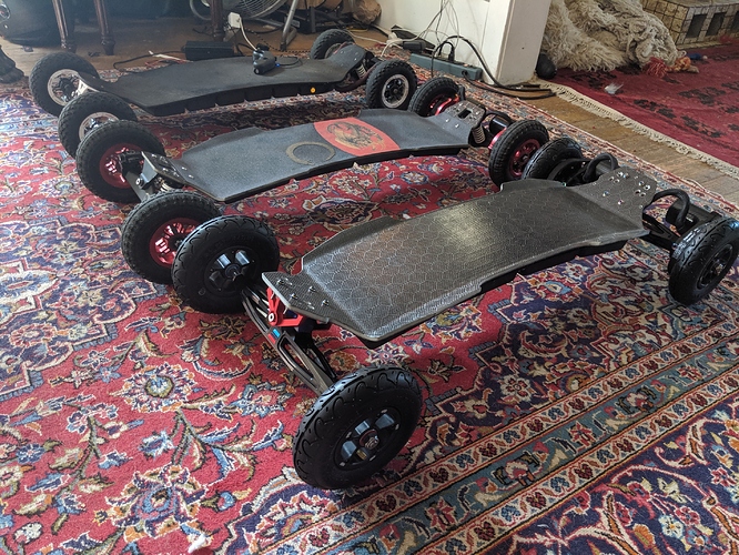

@esk8 I have both decks (Kaly XL & Prototipo) I love them both but for different reasons.
The Prototipo is a little more forgiving and not quite as an aggressive carver at 30/30 end angle, but that’s not a bad thing. I find myself able to throw my weight into the board a bit more without an overly snappy response. Another factor in the boardfeel oh the Prototipo is the pretty significant flex on the standard deck. I enjoy it and the comfort it provides but a stiffer deck lends itself better towards stability at higher speeds, especially when channel trucks are at play. Still very nimble. Here’s my Cascadia Carver taking a local downhill course:
(Black rubberized gripped Prototipo)
The Kaly XL is a different beast. I’ve got two boards built up around this deck as of today, and it happens to be my preference for higher speeds due to firmer flex option. The wings or footpedals allow you to lock in very nicely, and the deck rides a bit higher than the Prototipo with a more pronounced arch. I’ve found these to be more stable at higher speeds, even with the increased end angle at 35/35.
Let me know if you have any more questions. @Sender is the man you want to talk to if the Prototipo sounds up your alley. He’s got limited edition stock and does the best skinning work in town. Also might ask on Kaly decks too :wink:

Beautiful builds you got there, I like your simple and elegant style. I think I’m gonna wait for sender to get his kalys in stock and senderize it.

Late to this thread. But I have ridden prototypo, nazare, and kaly. I prefer the kaly deck.
The winglets really lock your feet in, and the trucks felt much more responsive at low speed while being rock solid with no wobble at high speed. I would make the same choice for off-road as well.

Immediately, it reminds me more of a longer LaCroix Prototipo (which I also own and love, but it’s a bit too short for my stance). It’s sufficiently wide in the places it needs to be.
Lower than my Kaly or trampa decks and without the prominent camber featured on those, so more comfortable to stand on.
Overall, lower deck + lower camber + large flatcave/footpedal areas for your feet + snowboard-sturdy construction make this deck a total winner for me.
