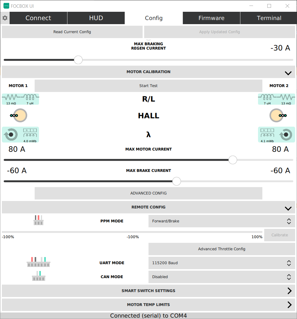

Recent completed a setup using:
-Samsung 30q 12s4p from Chibattery Systems
-Dual TB 6374 Motors
-Focbox Unity
-Flipsky VX2 Remote
I am currently having issues with speed on the board. During actual riding I am only able to cap out the speed at about 32kmh (20mph).
Unity setup was completed using Focbox UI with control settings as:
-PPM Mode Disabled
-UART Mode 115200 Baud
-Can Mode Disabled
Additionally:
  • Motors sensor cables are not being currently used
  • I am unable to calibrate the controller via the Focbox app
  • Flicking the VX2 controller quickly then holding it will cause one of the motors to move in the opposite direction.
Any help and suggestions appreciated. Thanks!

Motor Calibration
Just got free to work on my board. Now the motors turn even slower than previously.
Rerun detection, that’s whack. Those values look normal for unsensored.

I keep rewriting the firmware and the problem goes away, but has returned repeatedly. Again the problem has vanished. Going to test it and see if I still have speed issues. This is what I currently have

When you run motor detect and get it to respond, was it spinning the wheels the correct direction on the bench?
The VX2 UART messes up Unity configs. Move to PPM. You will lose telemetry. I just bought a Puck, partially because of this. Another option is to configure everything with the VX2 unplugged but its a hassle.
the method i found was, do all settings (with vx2 receiver plug in, but remote off), turn remote back on. if u need to tweak things on the fly, turn off remote, turn off unity and back on (remote still off), do ur shit and turn remote back on. this works for me until i’ve got everthing setup to my liking, then i never go back to the unity ui to change anything, this sucks but it works
