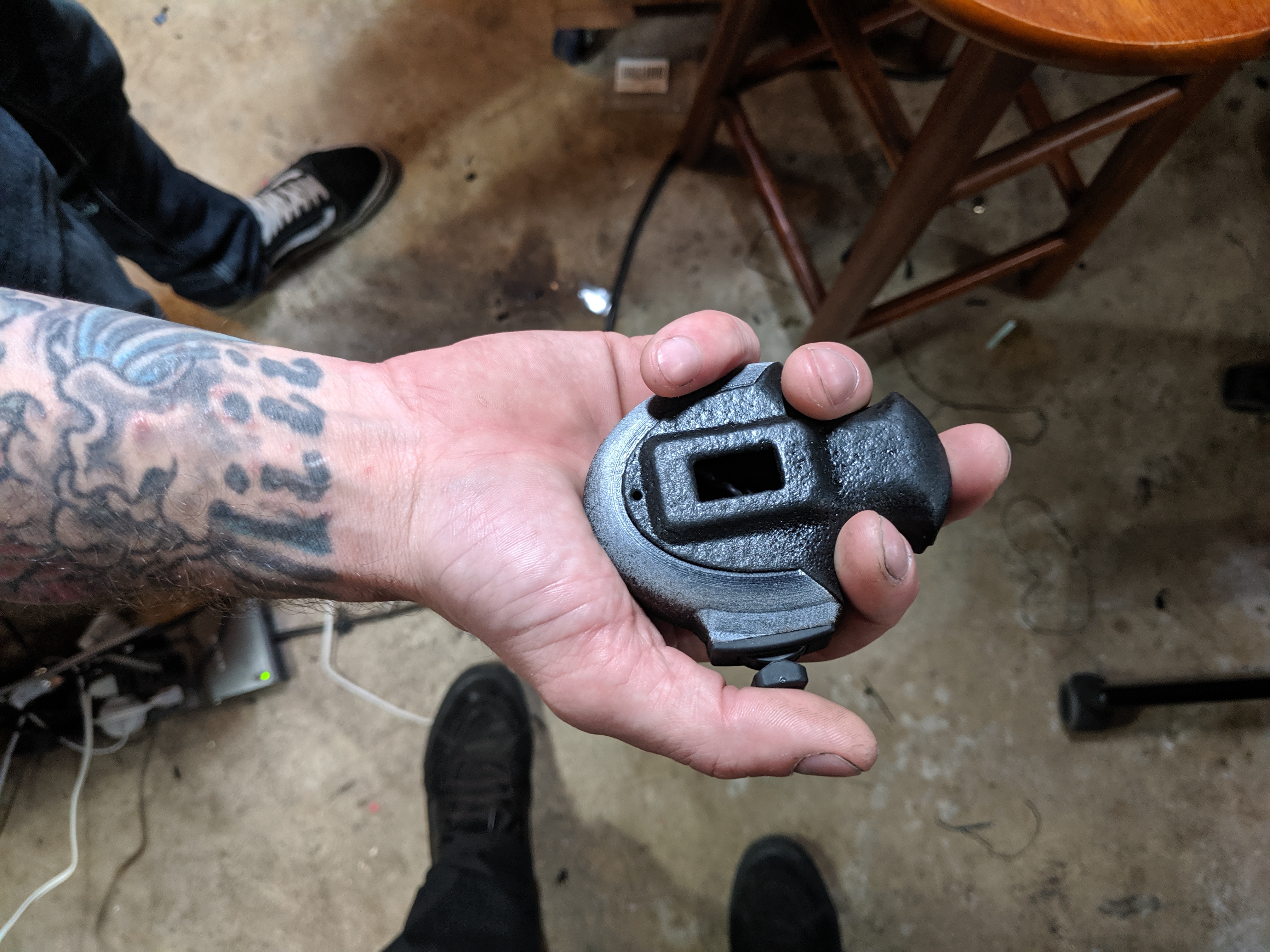

100% agree. Had my hand around a vx2 on friday and it’s going to be a solid inexpensive option. OSRR on the way now and I’ll get a wand too.
Battle of the remotes is on, we can only win
So you’ll soon have your hand around Andrew’s dong?
Did you try it out on a ride? If so, how was it? Any complaints?
Not yet broski. It was @BigBen 's remote.
I think he’s going to try it tomorrow?
If he can get it to work…box is nice though apparently
I have small hands and can confirm it felt really good when using it.
I also used a hoyt puck that day. It was nice sized and functioned well but I didn’t like the hockey puck shapes feel in my hand. It didn’t have natural contours like a hand does.
OSRR Dong FTW. I’m excited for the trigger variant
The Bruce is probably the best option for smaller-medium sized hands. Slightly smaller grip circumference than a Hoyt Puck
