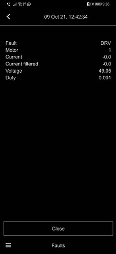

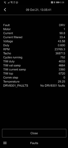

I’m becoming an unwilling regular in this thread. This time I think my a/s bypassed Unity might finally have given up. I took it racing a few weeks ago and kept getting cutouts, most of which put me down on my arse. Metr reported a series of DRV faults…
The faults themselves don’t give me consistent and sometimes not even very detailed feedback.
I’ll admit to not really knowing how to interpret this info but there’s nothing that seems obviously over limits. But a DRV fault that itself declares that there are ‘No DRV8301 faults’? Does it think I’m some sort of idiot!? Like it can somehow bluff it’s way out of this!?!?!111 :triumph: :angry:
The board had been running well all morning. It was only after a recharge that this started to happen and it only seemed to happen when I was getting hard on the gas.
I’m inclined to throw the fucking thing in the bin once and for all and then setting fire to the bin and launching it into the sun but if there’s the possibility of salvaging it by swapping out the DRV or by some other practical means, that’ll save me a lot of explosives.
I’ve got a Go-FOC DV6 Pro on the way to me in any case but any advice on how to diagnose the issue in the meantime would be appreciated!

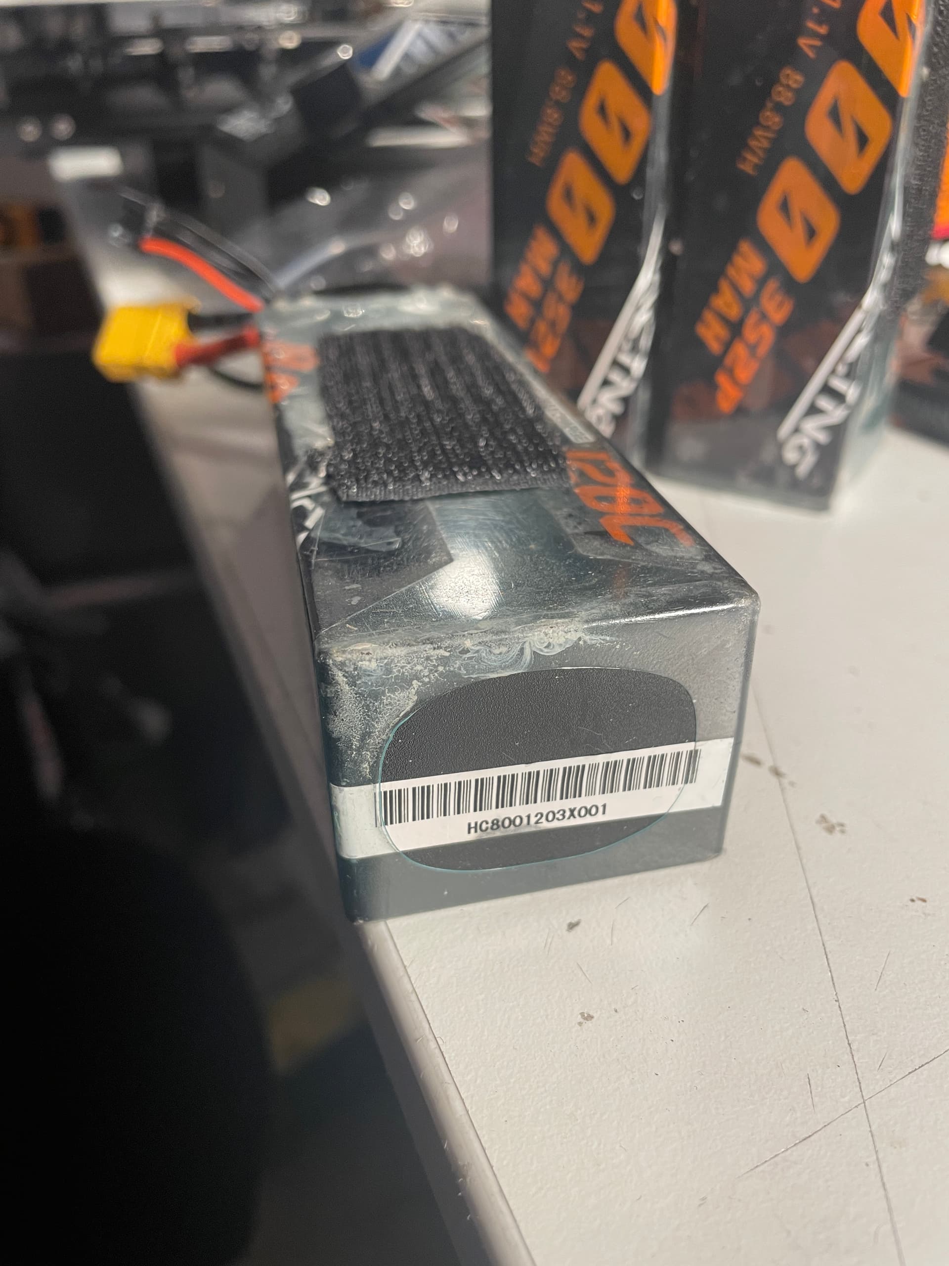

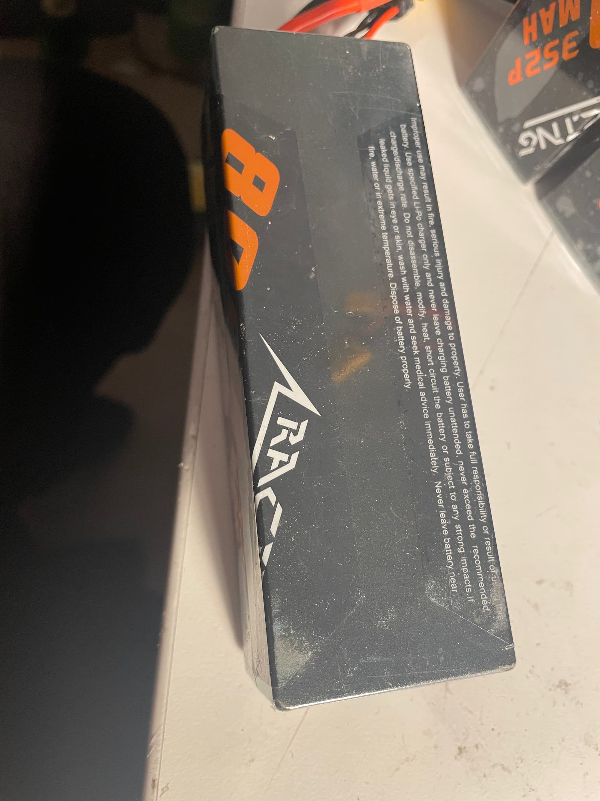

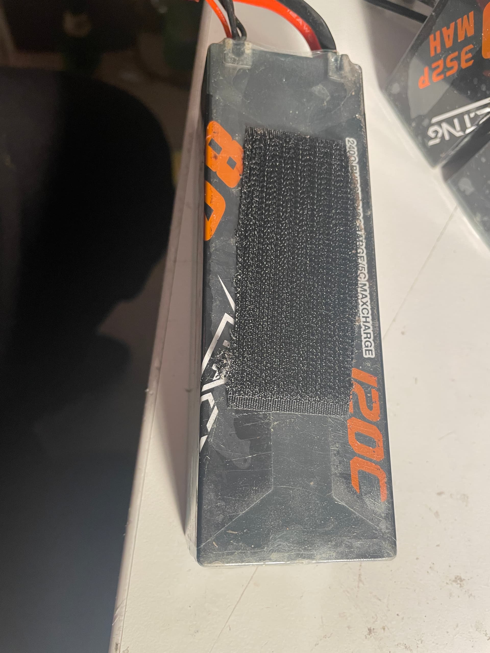

I’m sort of in shock, this goddamn thing took out four high discharge 3S 8Ah batteries on its way out. Just destroyed a couple hundred euros worth of batteries, discharged to zero while sitting idle doing nothing. I had a xenigotchi logging everything that looks like it shut down 2 hours beforehand for some reason, so no obvious record of what happened
Good Christ! Short of it just spontaneously exploding, that’s gotta be every rider’s worst nightmare scenario.
Can you fill in some of the many blanks here? You were running lipos, right? …and presumably a Unity. Presumably no BMS? What state was everything in afterwards (besides the batteries apparently being flat)? Have you physically measured the voltages coming out of each pack yet? So many questions…
yeah it’s confusing, I’m not ruling out me having done something very stupid. I had a charge only BMS with a 15A fused charge port. Each of the cells in the packs are reading <0.5V, some of them are negative, so they’re good and cooked. All the wiring looks intact, but the packs themselves look a little worse for wear.
Trying to work out if the marks here are a result of being overdischarged, or I damaged them beforehand and this is just me noticing
edit: one of the packs has started recovering, and is around 1.5-1.8 per cell

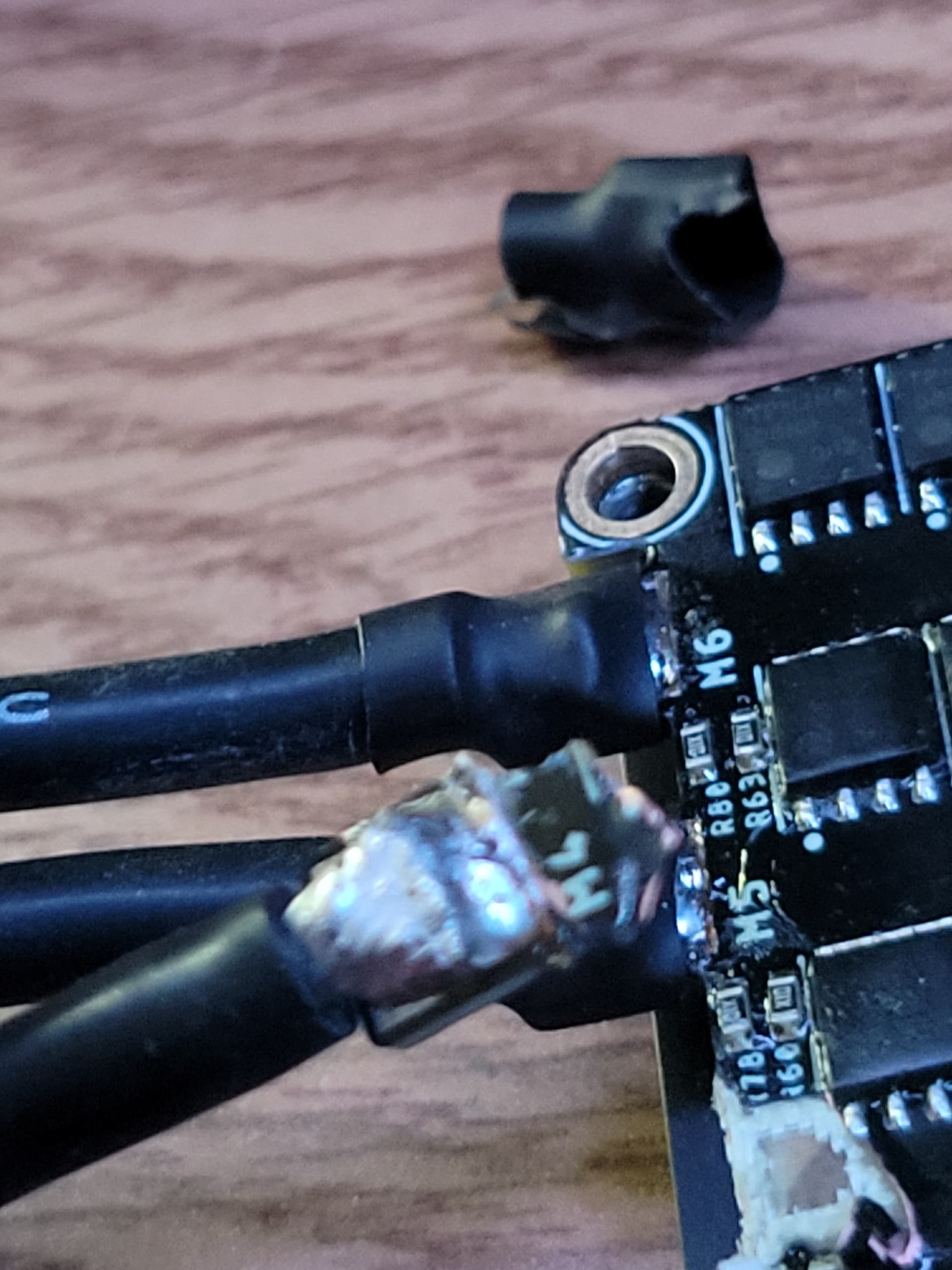

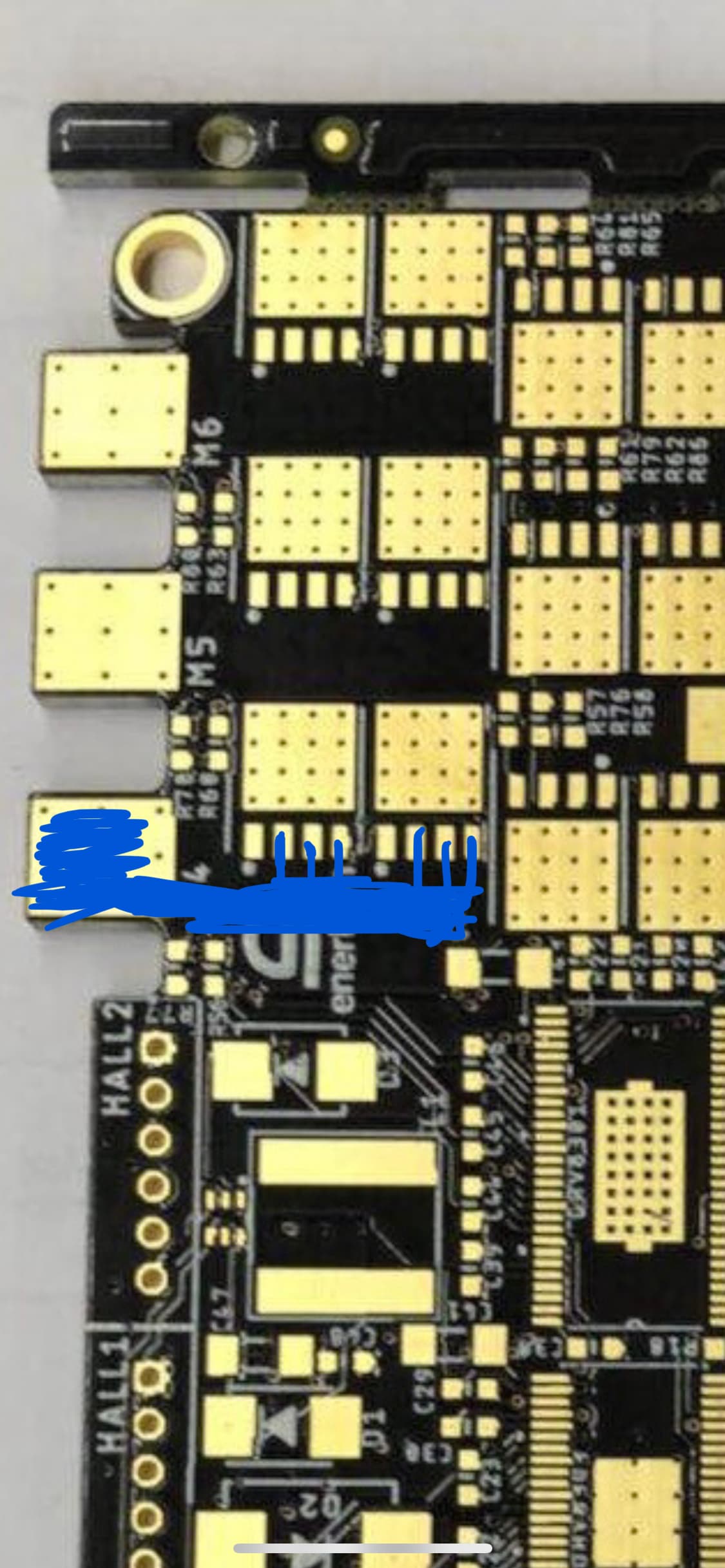

Had a motor wire rip off and it wasn’t the solder joint it was the pad that it solders to and a bit of the pcb. This fixable?
Looks fixable to me :face_with_monocle:
I believe this is how the fets are connected. I would bring out the copper trace from the black part of the pcb next to the legs of the fets… and solder the wire there. Make sure the leg with the dot stays separated.

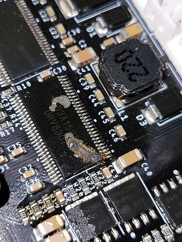

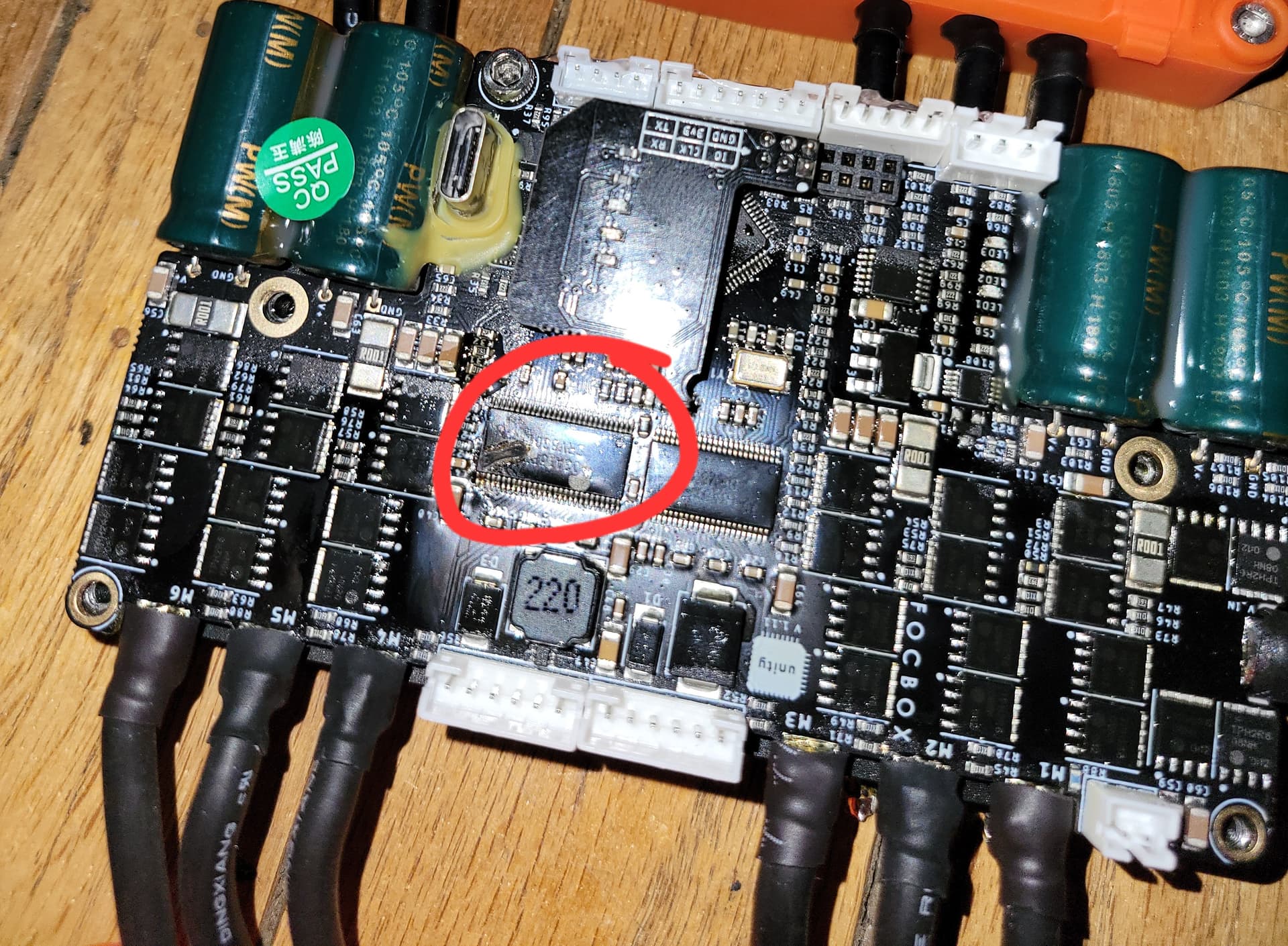

I’m back again to revive this thread with yet another broken unity. This one was brand new, plugged it into the battery and it was on for a few minutes was able to update firmware then it shut off randomly. I tried the good ol unplug and plug it back in… pops. I added some photos. Fixable?
Dead Unity
