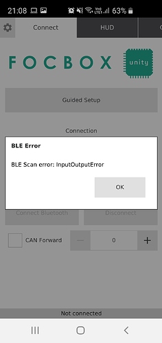

Does the focbox UI app work for anyone? Both of my boards which use them cant connect via bluetooth to my phone.

I connected to both of my unities yesterday via the app but didn’t change any settings. They connected fine for me though.
This is the error I get when I click scan.
Happens to both boards which have it.
Yes, board is on, and yes bluetooth on phone is on
Got a tablet or any other phone to try on? Definitely too coincidental.
Looking for that spare phone i have as we speak, i’ll download the app and give it a try again.
Also i did uninstall and reinstalled the app on my main phone to see if it’s the app acting up, to no avail.
Edit : Well, it’s my phone then. My other phone could connect to both no problem.

Ok, restarted and still does not work. It can connect to other bluetooth devices however.
Try removing the unities as a previously known Bluetooth connection (forget device) and see if it’ll re-add them maybe?

Bad Bluetooth modules on fuckin have been my culprit 2 times now with the behaviour your are describing.
Vesc tool doesn’t fix your issue?
On your phone? He was able to connect with another phone. I’m not sure that points to the unity as the fault.
Was talking about the focbox Bluetooth modules.
At any rate. Giving my input. Have had two go bad.
