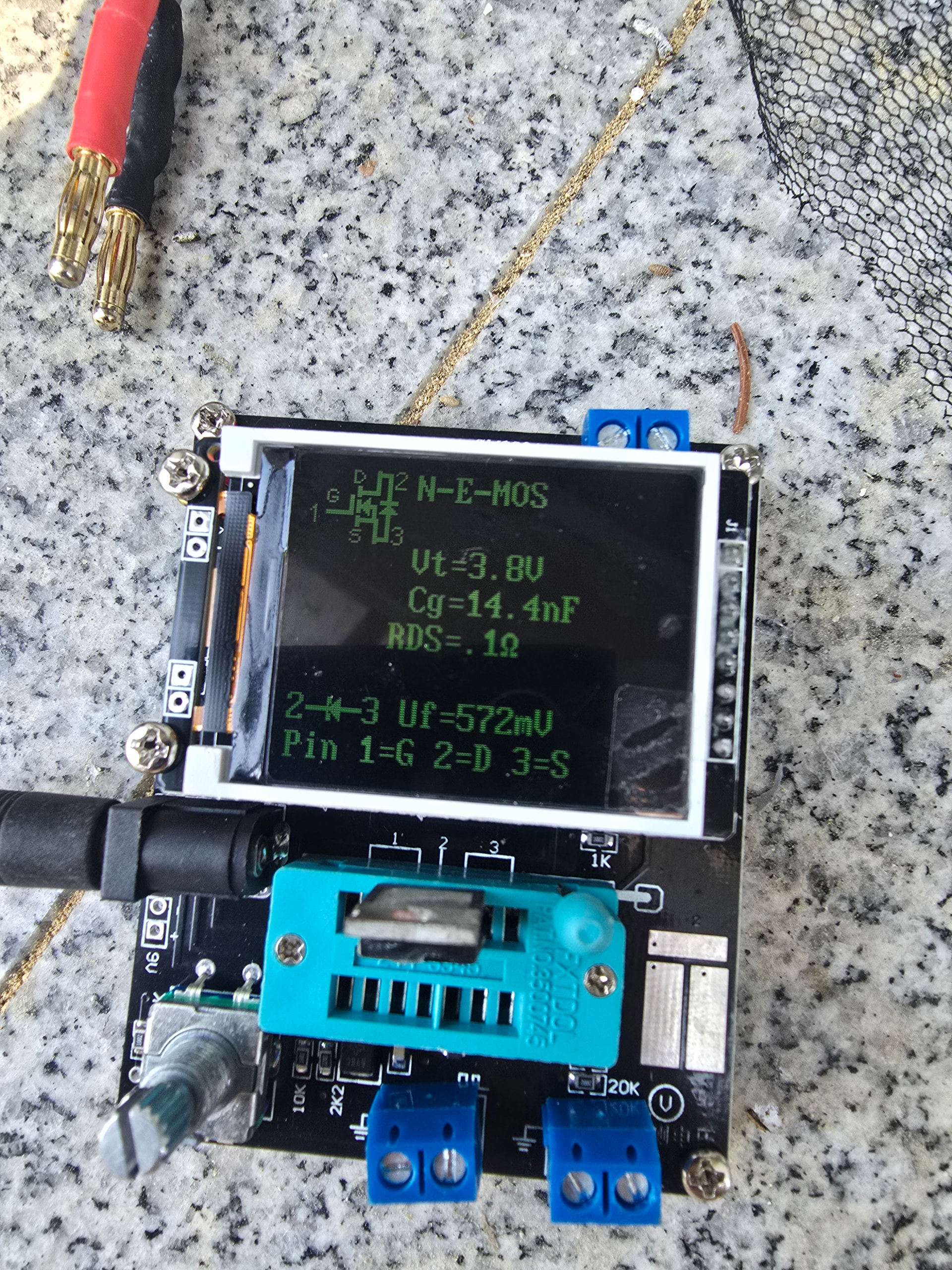

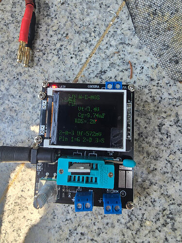

I got them from Shop1104385434 Store on aliexpress. They have about 5% of reviews accusing them of counterfeiting. I think this would be the problem. I don’t have a transistor tester but will try ordering some others.

Can someone with CRST030N10N from a reputable source like LCSC do some measurements, capacitence with a multimeter or if you have one of those cheap transistor tester:

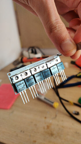

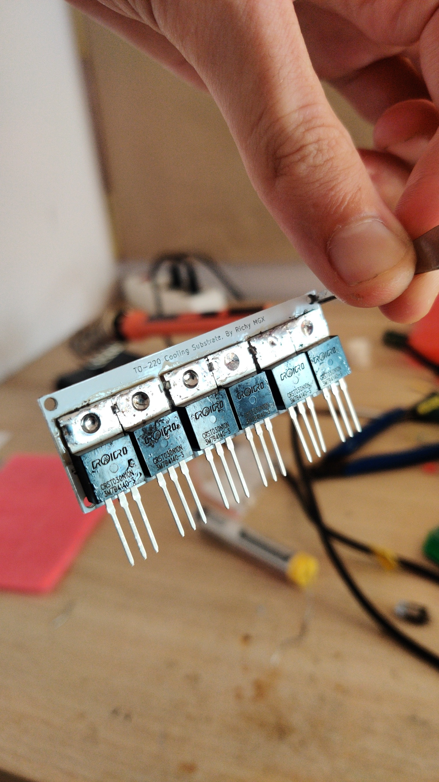

I’ve designed a alu pcb for the mosfets, cooling will be dramatically improved. Building a alu controller now
I will test it, thank you.
You know the mosfets tabs cant be connected?
