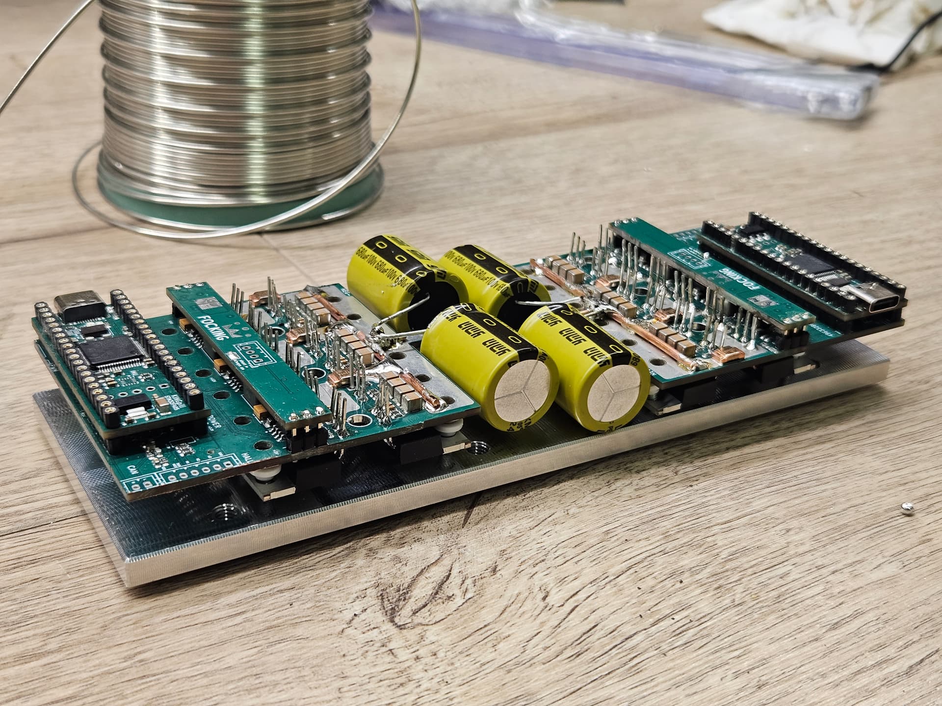

FOC_KING - 84V 150A, open source vesc6 board V2.0.1. JLCPCB order
Nice ! So its working. How many amps are you pulling on those 2 vescs? Are you running 6 oder 12 FETs per Controller?

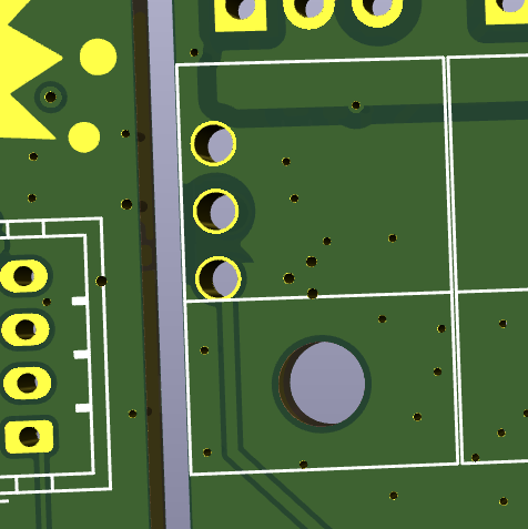

Loos like I have to run only 6 FET’s as 12 won’t fit due to conflict with the powersupply 3 pin inter-board connector. See picture.
conflict
Should be doable if you put the converter pins flush to the board and solder just from top

Slowly geting there
