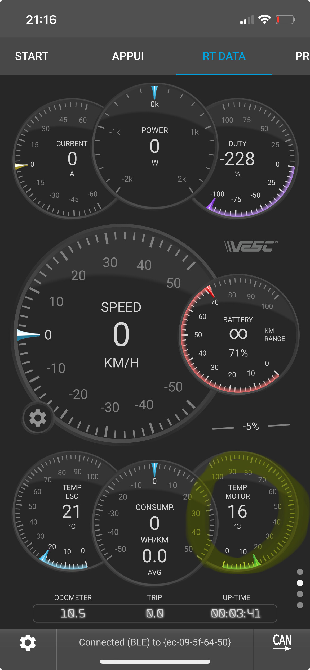

I tested it again, this time with the Superflux Funwheel motor, it works. The fix is easy, GND is on the same connector, 3.3V is on the corner pin of the “Freepill” MCU board.
you could use the vcc on the hall connector as well it is 3.3v . So it could be possible to add this fix directly into the hall connector without soldering to the freeDrive.
So i would connect the cap between (1) and (5) and the resistor between (6) and (5). All in the cable that goes to the motor plug and the temp reading should work. (That is from the freeDrive revision which is in my board!)
but the thing is if I do it in the cable it will work on any revision because the used wires are all the same
You are right, I thought it was 5V on Pin 6 but it is selectable. OK if you use 3.3V.
I measured it and the HALL sensors are using 3.3v so this should be ok.
So the superflux hall sensors work with 3.3V?
yes. Thats how i use mine
