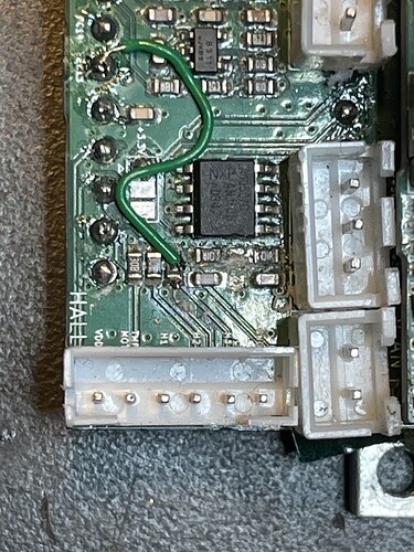

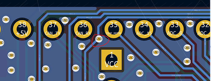

Although initial tests with a sensor less motor were successful, I ran into trouble when testing the vesc with a sensored onewheel motor. Hall sensor 3 always stayed 0, therefore the motor was recognized as sensor less. I figured out that Hall 3 was shorted to gnd. I followed the trace on one of the unassembled spare boards and found this:
Unfortunately, this trace is not accessible on an assembled VESC and the Pin is routed over a via from below the STM32, so no chance to fix it on an assembled FOC KING, without removing the pill. I did not want to remove the pill, too much pain.
My workaround was to assign Hall3 to a spare pin, I chose PC13 which is not used and accessible on the pill. Re-built the binary with adapted hw_FOC_KING_core.h.
Works now. I’m probably the only one that is using this HW as it was a pre release version. If anyone else should need the binary, pm me.

Did the DRC check not pick that issue? I’m surprised KiCad missed it

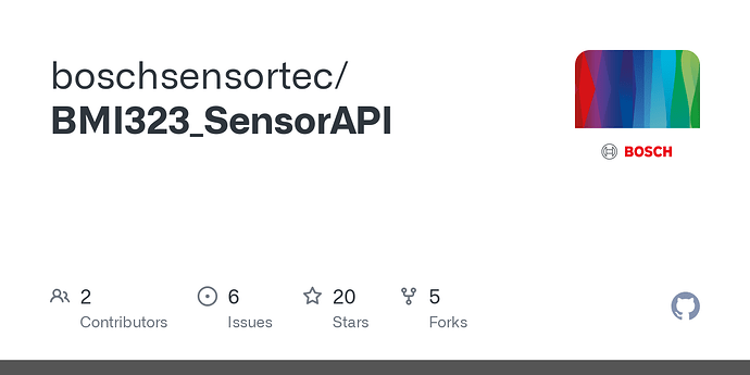

OK guys, so I decided to go with the BMI323 from Bosch, because it is so damn cheap. I know it is not officially supported by VESC, but it seems simple to add support, actually. You need to add the BMI323_SensorAPI to the VESC “imu” directory, and then two source files that I am writing right now: “bmi323_wrapper.h” and “bmi323_wrapper.c”.
I’ll take the chance and see if it works.
